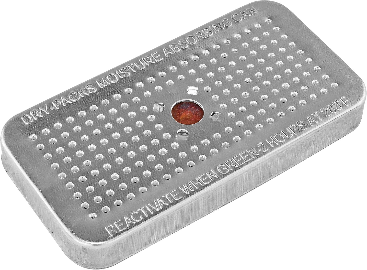

Yes definitely. But thats where the desiccant comes in. I’m intending to put this in.
https://www.amazon.com/gp/aw/d/B00LVN7BM0/ref=ya_aw_od_pi?ie=UTF8&psc=1#productDescription_secondary_view_div_1469865989259

I am not sure how fast a desiccant system would dry a moist spool. It may be good at keeping a certain humidity level, but not sure how fast it can remove it. I know that heating is used to dry polymers before injection molding them.
