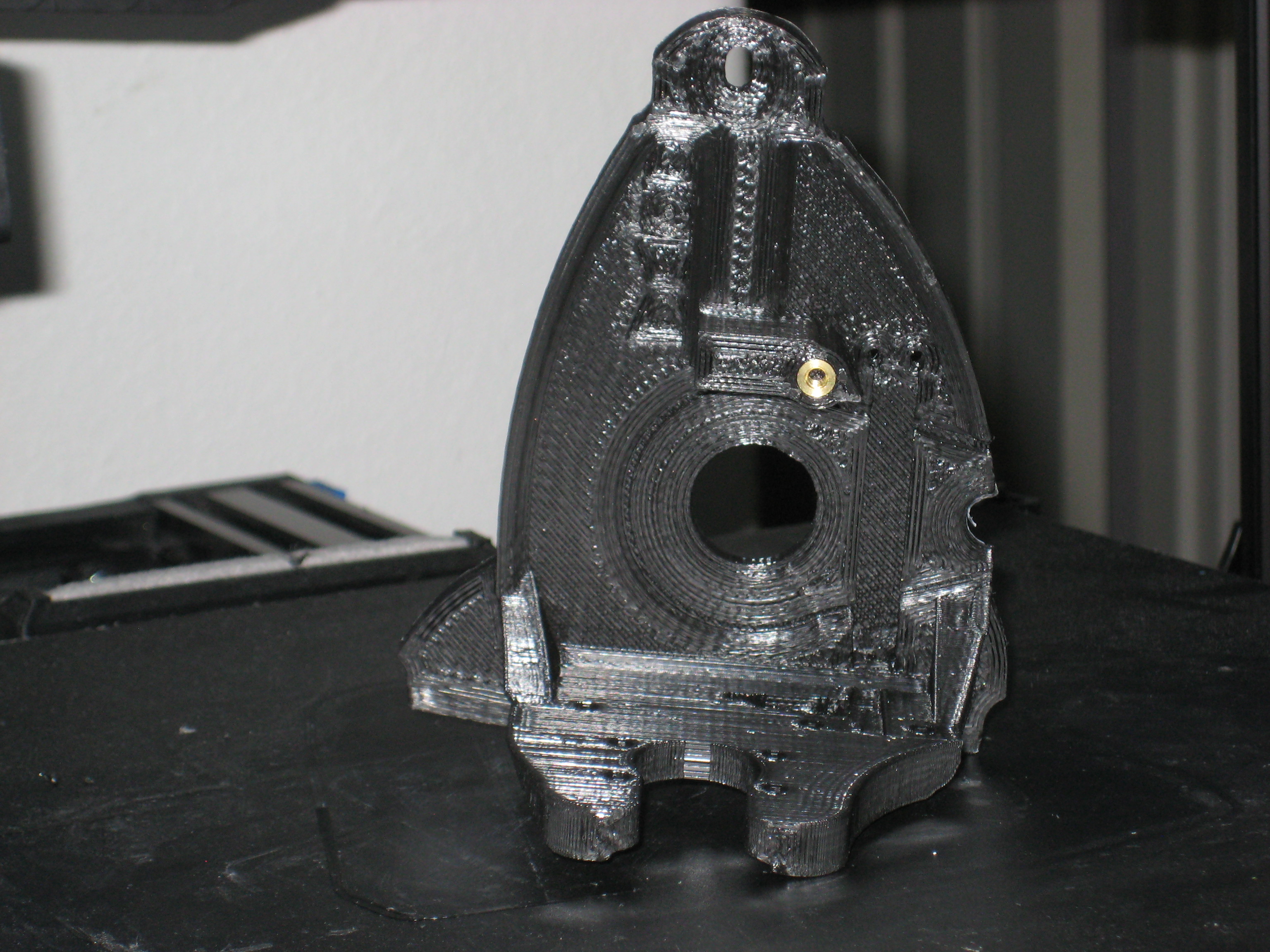

I’ve been working on this as a side project off and on for a little while now. I’ve always been interested in belt driven extruders, because they theoretically have more responsive retraction than a geared design. I also wanted something that had as absolutly as short a distance between the hobbed things to the hotend as possible, used a Bondtech dual drive hob core, had an easy to access idler. and was stiffer on the mount than other designs. And thus, this extruder was born.
Presenting, the Alpha revision of the Nova Pro Belted Precision Extruder! (lots of pictures, files further down along with more details)
Project repository: http://www.thingiverse.com/thing:2036899
Here are the build files:
There will eventually be a left hand and a right hand variant of this extruder body, to allow for a more compact dual extruder. There is also going to be a lower fan shroud. For now you can use the stock E3D V6 fan. Also this presently fits an E3DV6 and requires a circular 6mm thick Mounting flange, several M3 bolts, an 8mm bondtech extruder core (roughly $85 shipped in from Sweden), belts, pulleys and M3 bolts. Also an M8 bolt and some washers. A full parts list, sources, etc. will be posted once its finished.

I noticed that there is a bigger diameter section just below the hobbed gears. Do you plan to insert a short piece of PTFE tube there?
How do you change the filament with this system, is it necessary to unscrew the two screws completely?
The lower filament hole should be the same diameter as the upper at the moment. I’ve debated putting the PTFE in there, it’s a short enough run I don’t know that it would do anything positive to the feed path though. I can certainly make a variant that allows for it.
To load filament, you just slide the latch up, flip the idler down, and then remove the old filament. if there is no filament loaded already, you cana ctually just load it by sticking the fiillament in from the top and hitting advance on the extruder too.

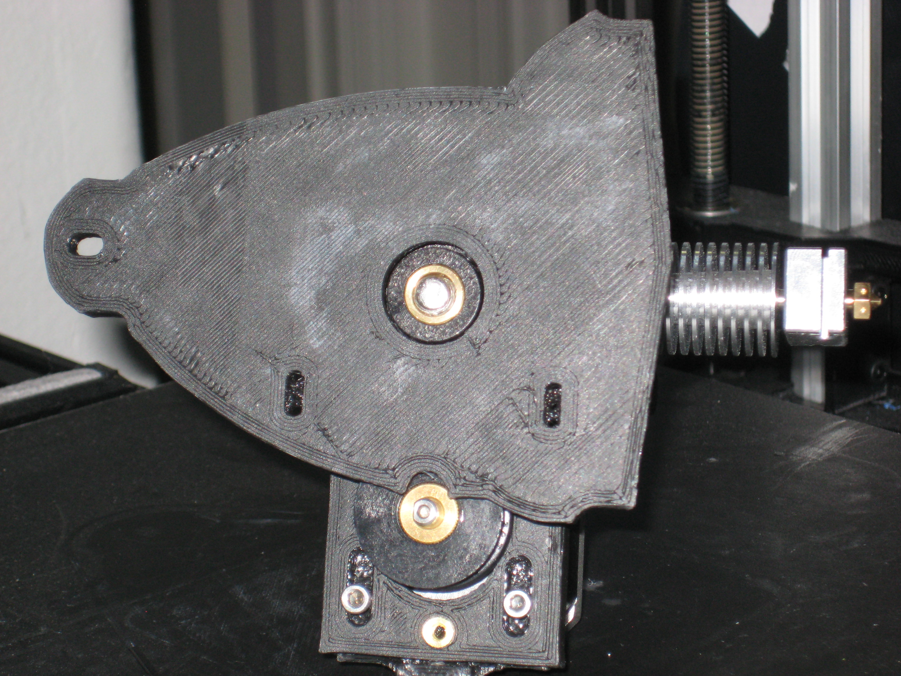

Have you tested flexible materials through it yet? It would seem this would work well with either rigid or the most flexible filaments.
It seems to feed great so far. I haven’t finished wiring the hotend yet to test it further than that. but in terms of constraint path and travel distance, it should feed even better than my dedicated flexible filament model. The only difference is this one lacks the PTFE tube, but for such a short distance I don’t think it will even be noticed as missing.
I finally had a chance to get back on this project. Here is revision 2.0 of the main extruder body. I’ll need to adjust the mount to fit the changes I made as well, so this will not fit the 1.0 mount, it will leave a gap. Look for the new mount to go with it tomorrow, along with a few for several other printers.
This latest version eliminates the 608zz bearings and replaces them with two smaller ones, a 12mm dia unit in the front, and a 15mm dia unit at the rear. That allows me to make the entire extruder 2mm thinner, eliminate about 1/8th the plastic around the bearing housing itself, use a shorter bolt, and cut the bearing weight down to 1/2 of 1 608zz bearing down from 2 of them. I may still be able to get a bit more plastic weight down by making the upper segment shorter, but the upper mount point has to be above the rear pulley so there is very little material I can remove there anyways.
I’m pretty happy with how it looks, we’ll see if it prints as well. if it does and everything lines up, this will probably be the variant I issue the left hand version of for use with dual extruder setups

Here’s the Nova pro Mk 2 roughly mocked up. The new side fans ended up being too long so I need to redo them, and there is at least one more area of clearance I need to add to the final release model where the two internal gear sets mesh, but i’m pretty happy with it now. I do think there is something I haven’t thought of yet to shrink the upper portion of the latch mechanism down a bit, and the front center fan may be able to be moved back another 2-3mm but other than that things are lining up about as efficiently as possible, and the new center core with the small front bearing and the smaller than 608zz but slightly larger than the front rear bearing are both working great. I literally took it for a spin and told a donar motor to spin it around a few thousand times, no binding, no debris or powder, etc.
Anyways, here it is:
The main change aside from the massivly reduced center spindle bearing arrangement is that this version is around 4mm thinner overall, has a mor compact idler, uses a much shorter center 8mm bolt (which reduces weight) and adds a second mounting lug for the side fans to lock them in position. That adds a tiny bit of weight but it is a fraction of the amount I removed with the other changes. There will be a 2.2c variant of the body that has a clearance notch for the gear mesh, but otherwise you can consider this a final revision for now. Overall it’s about 1/5th lighter than it was.

So how does it print?
Not sure yet. Version 1 prints great, crisper than my already good e3d variant wade setup in small details. Version 2 has not been tested yet because I haven’t been home long enough to finish it up. Last weekend was off site projects, this weekend was replacement car sourcing since I broke my old one. I should get it finished this week though, I do know the new fans seem to have plenty of flow, and the motion segment is smooth with zero slop. I also have a new motor on the way I want to fit.
