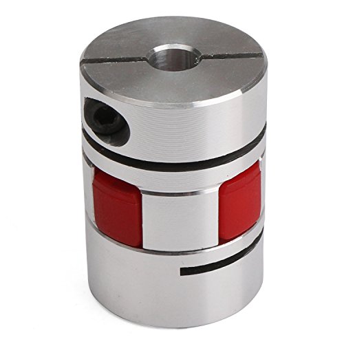

I was wondering if anyone has tried Plum Couplings. I would think this has the same effect. Thoughts?
Z wobble occurs from the interaction of the leadscrew and the leadscrew nut usually. A plum coupling can help if its being induced by motor misalignment, but in the case of the taz where you have proper upper and lower bearings, it shouldn’t help. If it does you have a motor out of alignment.
