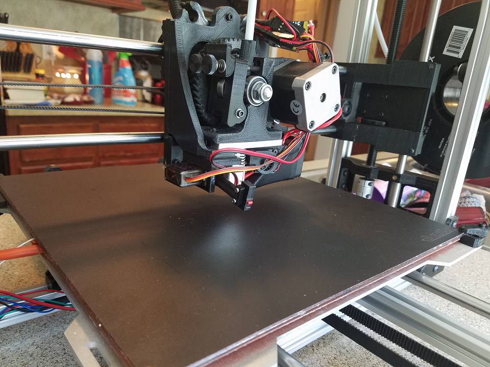

I have a TAZ5 and I have flashed the new 2015Q3 firmware with the support for the G29 and servos.
I have installed a sub miniature endstop switch on a servo, in a way to go right beneath the nozzle.
I have successfully defined the servo pins, the servo number and the angles for the servo endstops.
I have also calculated the probe x,y,z offsets from the nozzle (hotend-probe).

Sorry, your still having issues, but i think i figured it out… I just bought S3D today to use on my known working autobed leveling Taz 5 (Had been using cura). All of a sudden when using S3D it would attempt to start printing about 15mm above the build plate…
I couldnt get S3Ds autobed leveling wizard to work, it just ran a G28 command, but under process settings under the scripts tab, then starting scripts tab, I entered:
G29 ; autobed leveling
G1 Z0 ; Z goto 0
After the G28 command that was already there and updated the profile.
Bam! It ran homing of XYZ, bed leveling, then began printing in the correct place.
It seems that there may be a bug in marlin or S3D where after the G28 command the new updated Z offsets arent relayed back to S3D for some reason or arent updated, so it uses the last known position (“raise_z_after_homing” in marlin firmware) as “Z0” on the DRO within S3D. So a quick hack “LOOSELY” used, would be to tell the printer to move where S3D thinks its at, “0”. Then when the gcode is ran it starts at 0, and the printer starts a 0. Or instead of putting the “G1 Z0” in the starting scripts tab, you may be able to get by with using the “Z_PROBE_END_SCRIPT” variable in Marlin and put the “G1 Z0” there.
Confirmed: if you dont put the “G1 Z0” in the start scripts of S3D, but place it within the Z_PROBE_END_SCRIPT variable within Marlin, it starts at the correct setting. Just be sure your z offset setting within marlin are correct so you dont have a crash.
