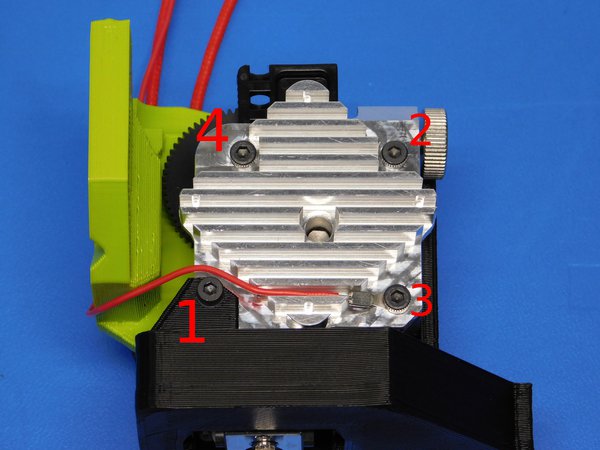

The washers on the bed are only half of the circuit. The print-head is the other half.
On the print head there are four screws around the heat sink. ONE of the screws has a red wire attached to it.
You can find the diagrams on this page:
https://ohai.lulzbot.com/project/lulzbot-mini-2-aerostruder-assembly-and-packaging/mini-2/
But this picture probably shows it best (in section 10 of that page). This is the zero-sense wire:
That’s the wire (attached to the screw marked ‘3’) that completes the circuit for probing the bed corners.
Touch one probe of the multi-meter to that wire. Touch the other probe to the tip of the nozzle. It should read less than 1Ω.
If your printer is reading high when you test this and still under warranty, contact LulzBot support. (I had to clean mine … the steps are a bit involved and … somewhat intermediate to advanced… so I don’t necessarily recommend anyone attempt to disassemble, clean, and re-assemble their print-head on their own unless they’re comfortable with the process.)
