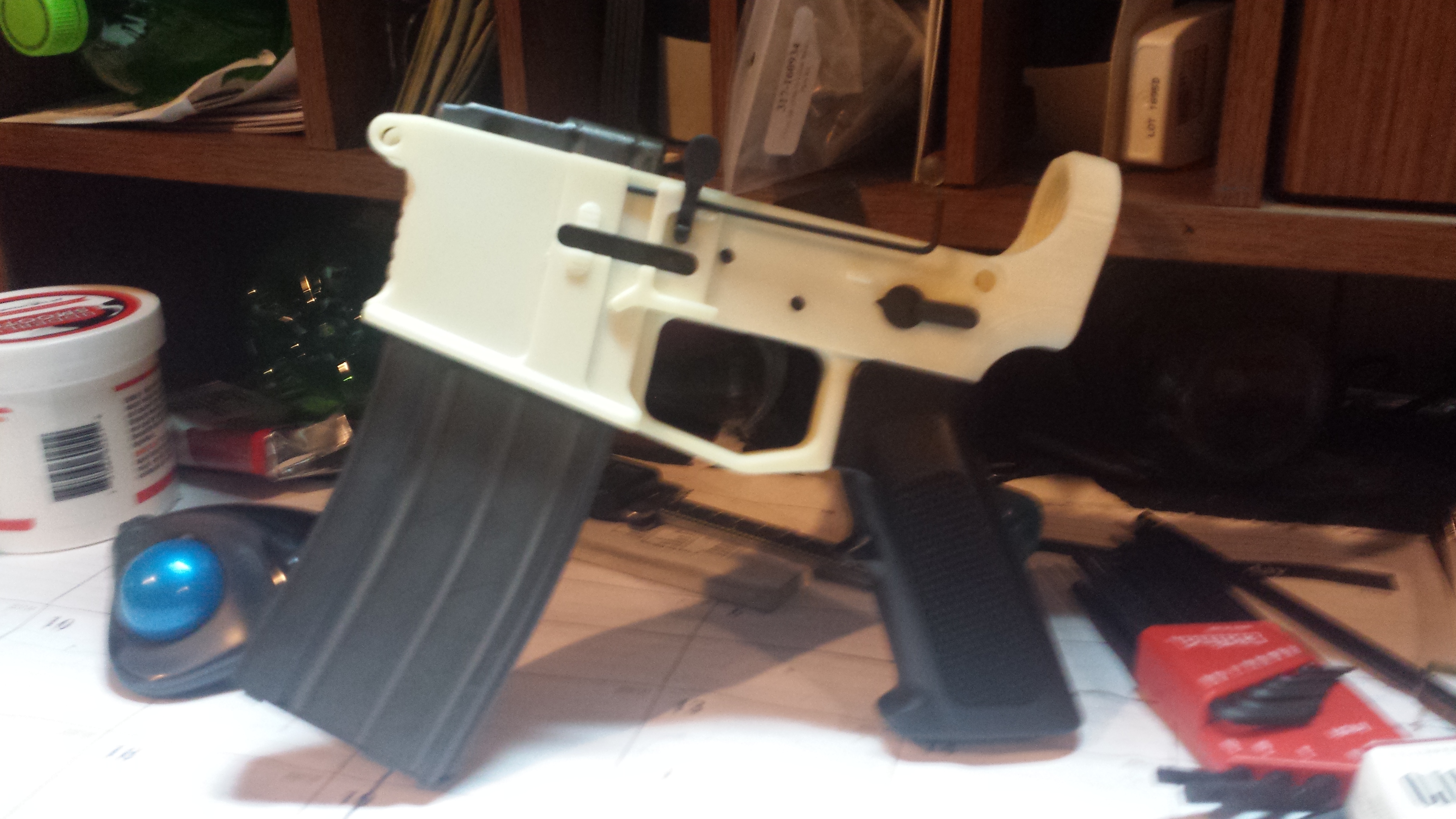

Okay so someone asked awhile back if a ar15 printed out could just be assembled, the answer is yes… a reamer should be ran though the holes for the pins but other than that very straight forward, I don’t think it is going to last very long as a weapon but I wanna try it a bit…and this did not come off my machine but rather the college’s Uprint or whatever it is called
So any opinion? can I expect this kind of accuracy with my taz that I see from this UPrint machine?

I was going to say… you’ve progressed A LOT in your second day of ownership. :slight_smile:
Yes, you can get extremely accurate parts from the TAZ. It may take a little tweaking to dial in the printer, but absolutely do-able. To get parts to fit make sure to check your e-steps (calibrate), and lower the flow rate to 95-97%.
