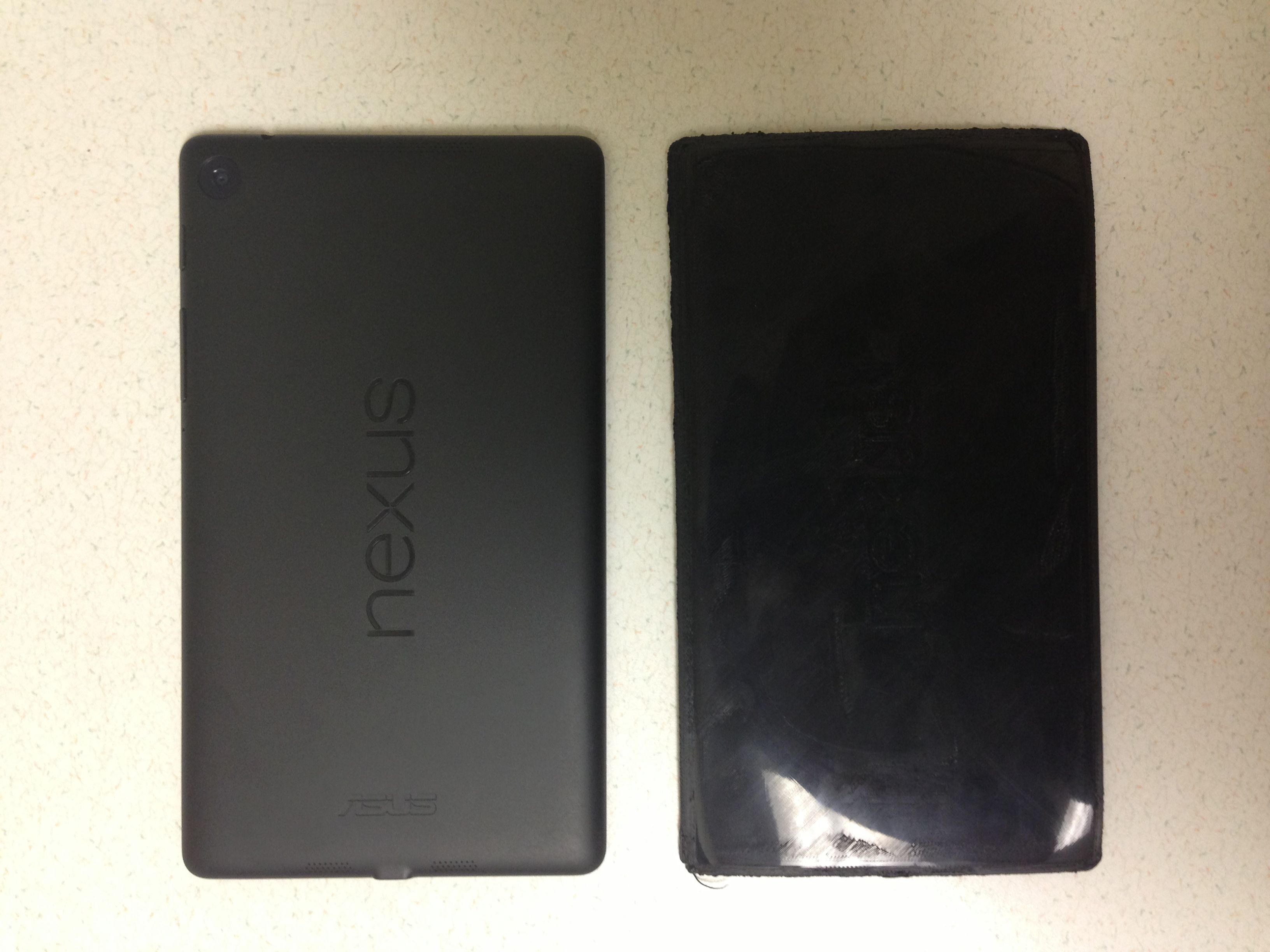

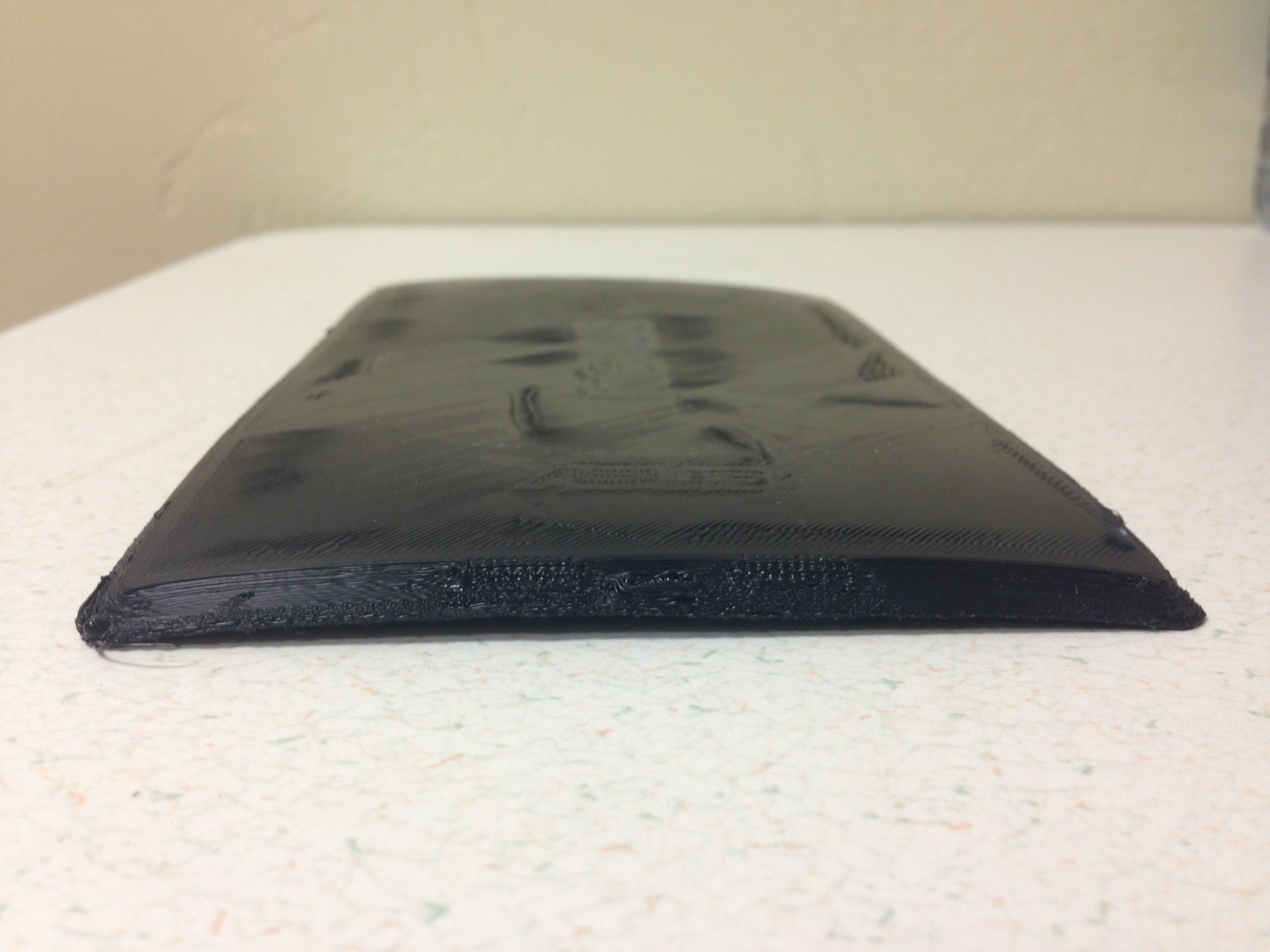

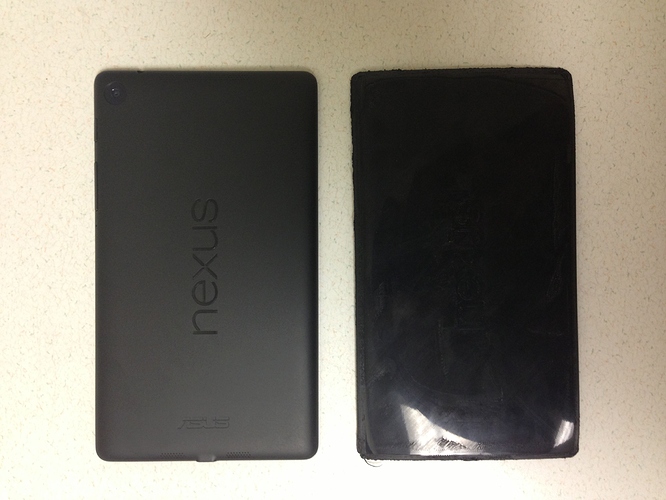

I ultimately am going to need to produce several large enclosures with a lot of flat surface area. We had a need for a mocked-up Nexus 7 - so I gave it a shot to understand what it was like to print a large flat part.
I used the .35 mm nozzle, ABS, hot end temp of 230 C and bed temp of 85 C, made the gcode and let it rip. Turns out making large flat ABS surfaces is a bit of an art. The corners of the mock up began to warp upward so I stopped the print at 92% complete.
Results are attached - Next try will be using the Acetone Glue method - the users manual outlines the steps and I found several links online. Also, my TAZ enclosure just moved up in priority.
You can see the warping - note - the bottom is up, the corners warped away from the heated bed.

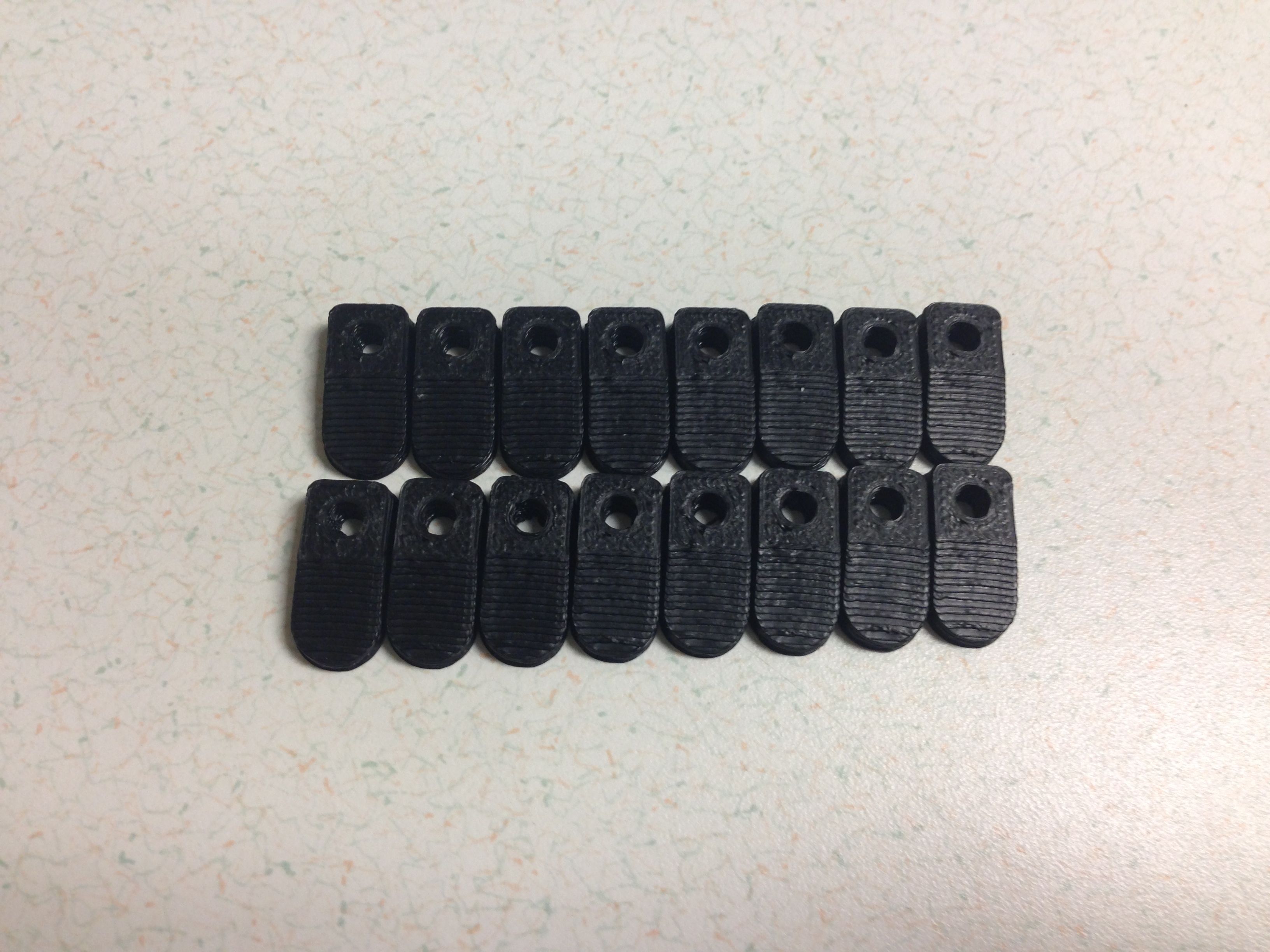

I grabbed the bed finger STL and ini files from the TAZ source folder:
http://download.lulzbot.com/TAZ/hardware/printed_parts/bed_finger/
I used Slic3r to create gcode - I made only small mods to the configuration - I updated the bed size and the center point.
The results were pretty good:
The base layer seems a little smashed - the bottom and all spares was a little wider than the rest of the part. I may try increasing the z-height when I make bed corner spares (next).
Using ABS glue will definitely help keep the parts secured and perfectly flat. It’s highly recommended.
You’re probably going to want to look into some type of enclosure that can help keep drafts and maintain somewhat of a consistent heat around your TAZ one you start trying to print the larger enclosures you mention. If your experience turns out like mine, printing those types of objects in the open air may be problematic with ABS.
I get quite nice prints from my TAZ when I’m doing small parts (say 4"x4" or smaller) with minimal warping when using the ABS glue. I recently started trying to print some square enclosures that cover about 50% of the TAZ bed area. That was a bit of a disaster. The layers started cracking open as the print continued and before long, I had a giant ball of goo all over the build plate and the hotend. A friend of mine built a really nice wood enclosure enclosure and doesn’t have any of this trouble with larger prints.
  • Adam
And adding a brim will help on very large area parts too.

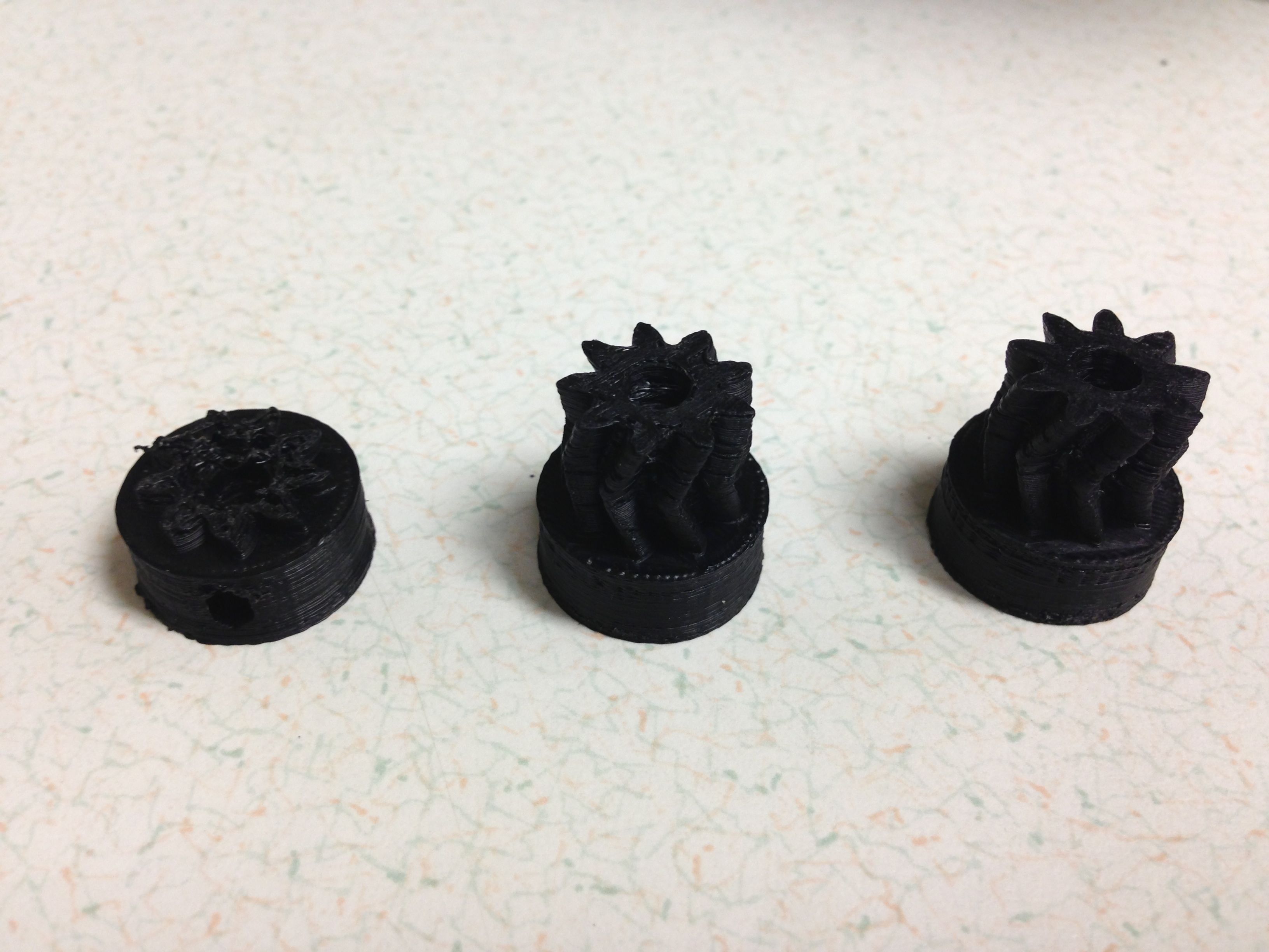

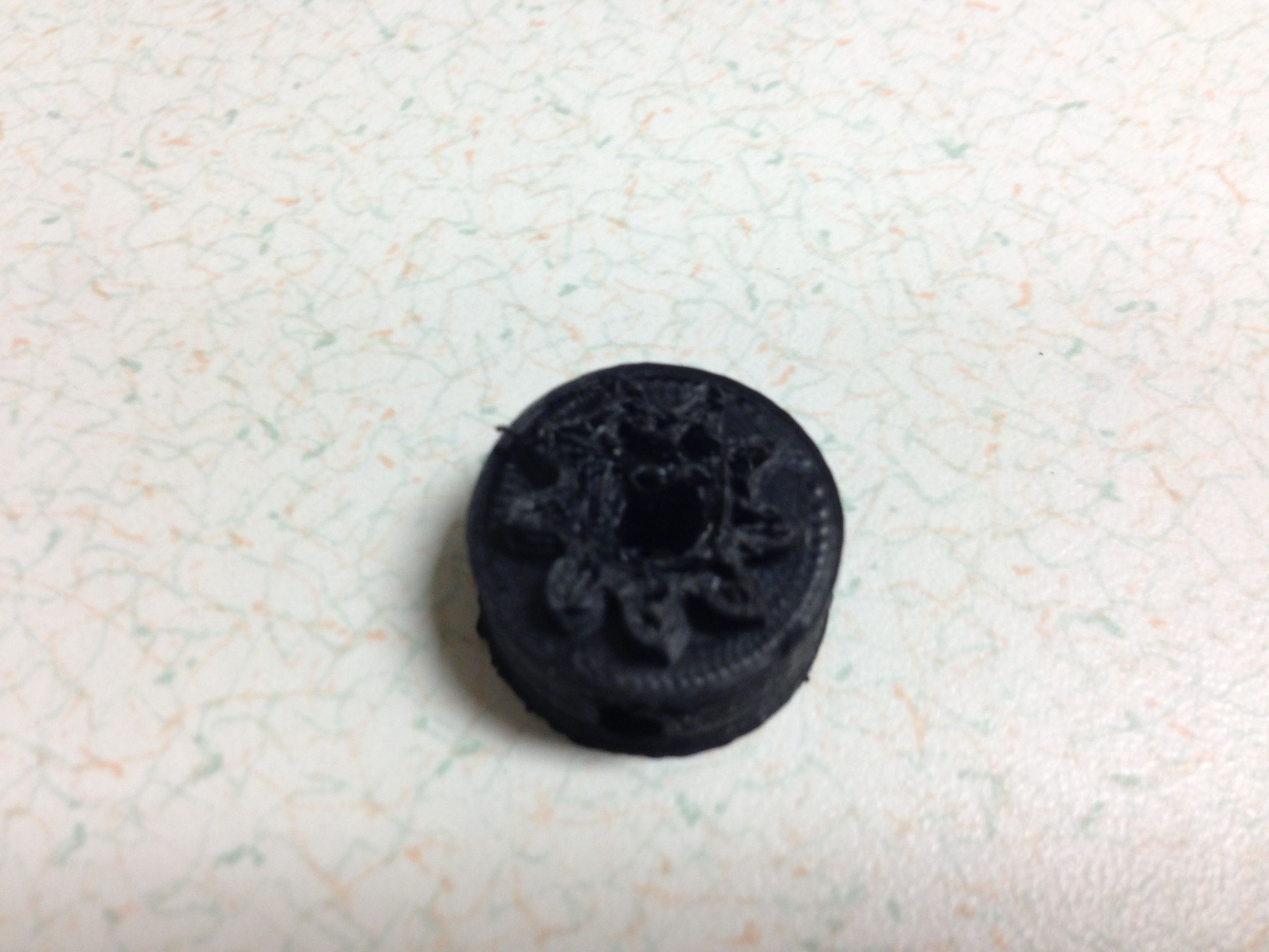

I also attempted to make a couple small herringbone gears. The first was not so good - I had the print set up with 3 perimeters - not enough room left to fill the teeth, so the part failed.
It may be hard to see - but the teeth are hollow. I updated the settings - final print configuration - 0.35 mm nozzle, 1 perimeter, .90 infill, infill every layer.
The print quality was pretty good - improvements can be made. I think the enclosure will help.

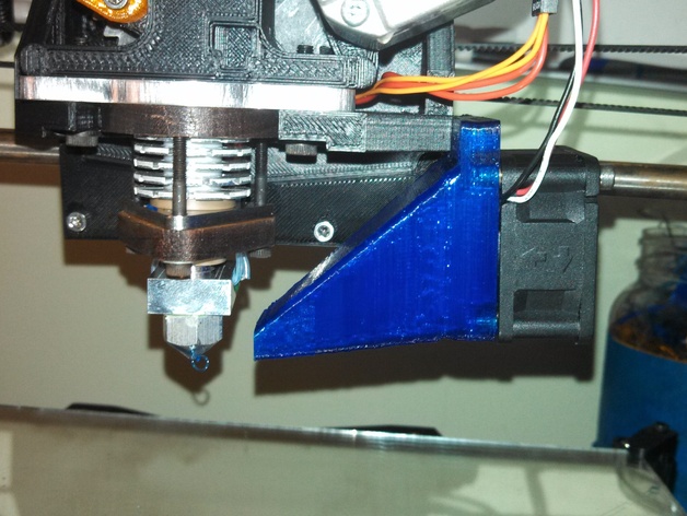

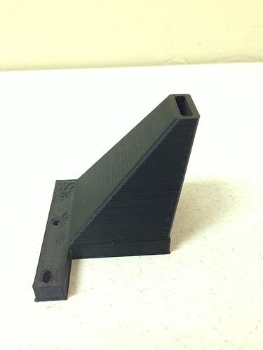

I adjusted some belts and my linear PLA bearing. Then I tweaked my ini settings a little more and printed the extruder fan by devzero.
The print looks great!

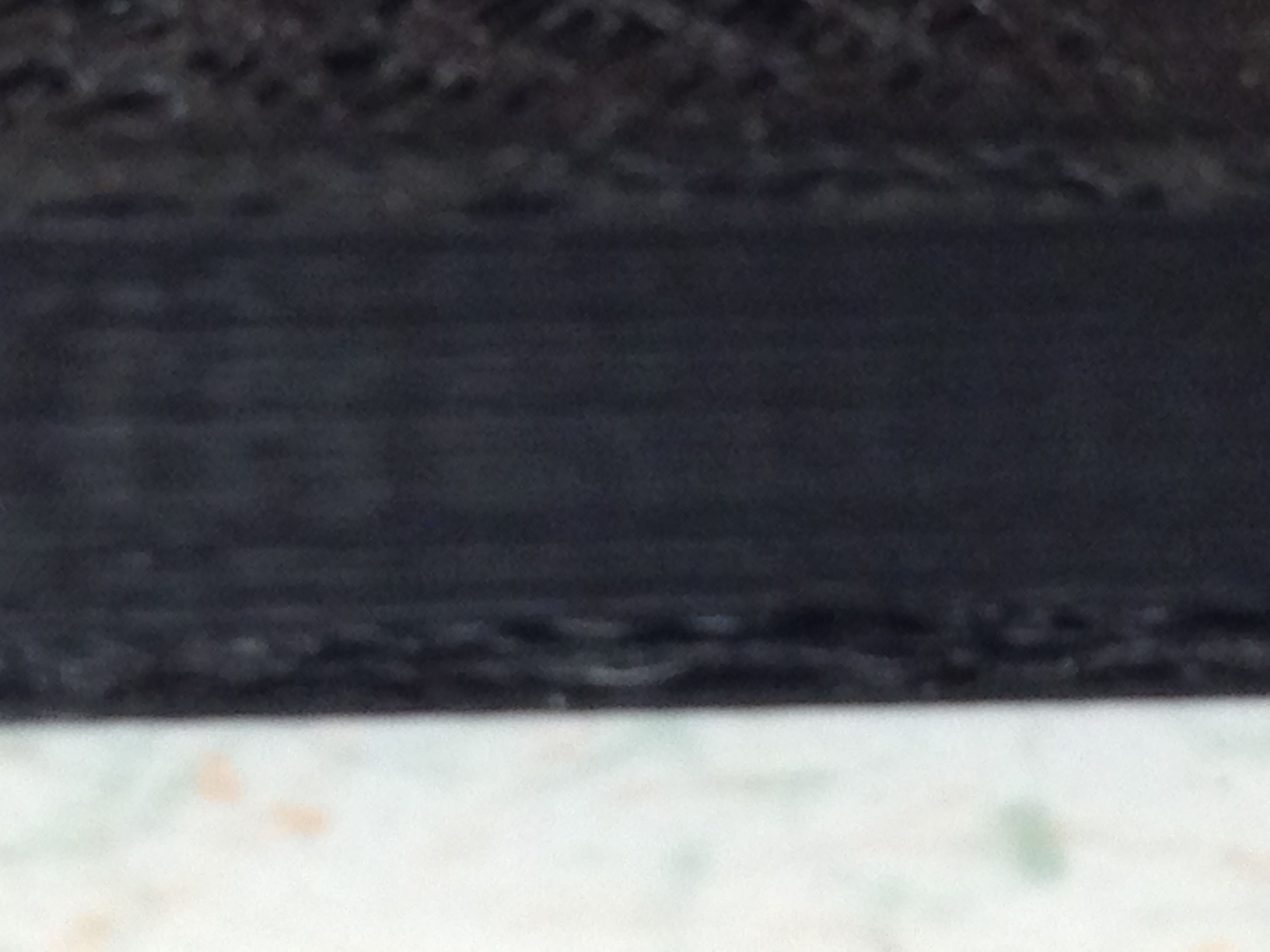

I had a couple of small issues - any help or advice would be greatly appreciated!
I seem to consistently have issues with the first few layers. Adhesion to the bed is not a problem. I seem to get ripples or bumps.
And I had a small surface finish issue on the last layer of the flange.

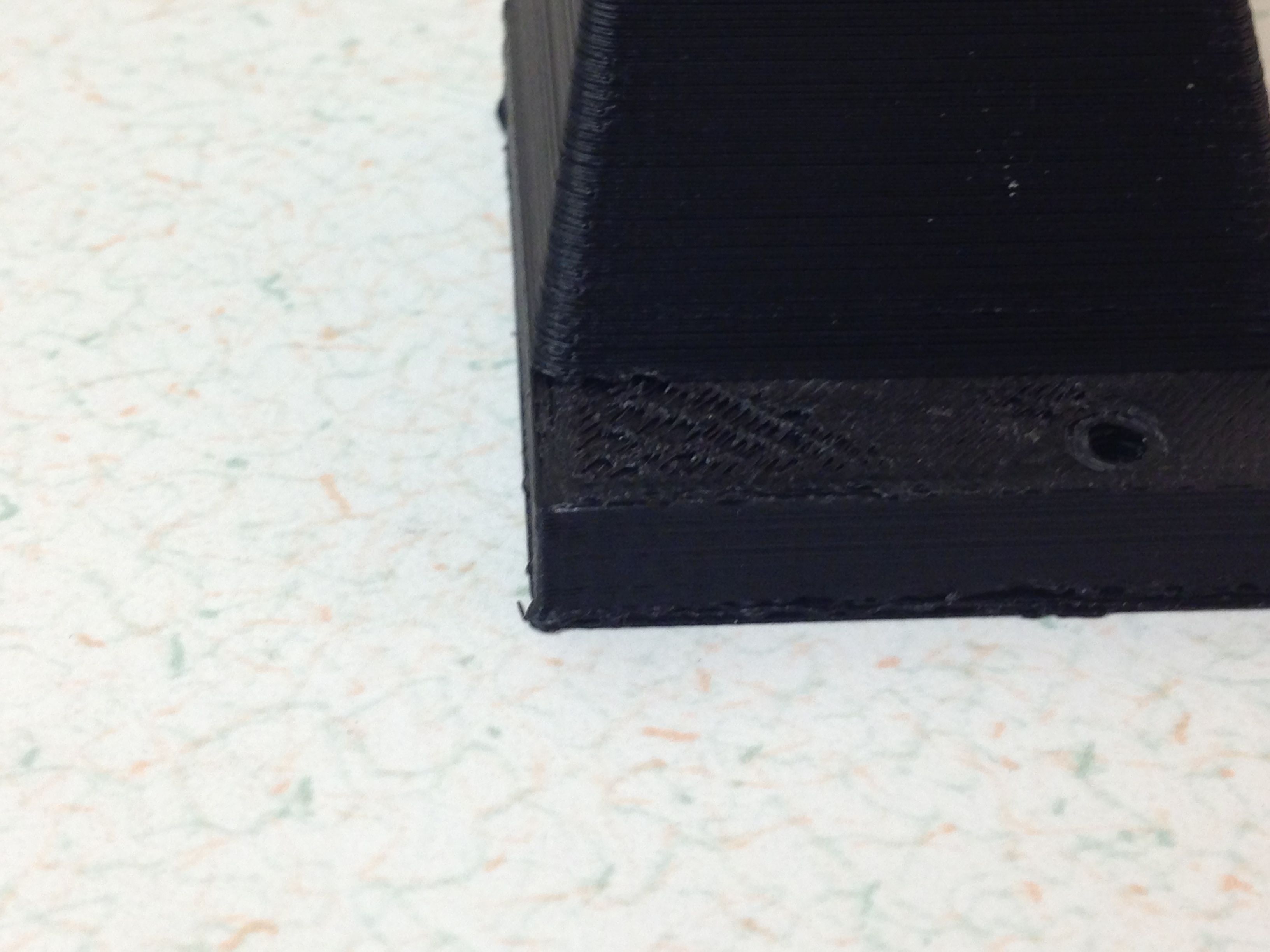

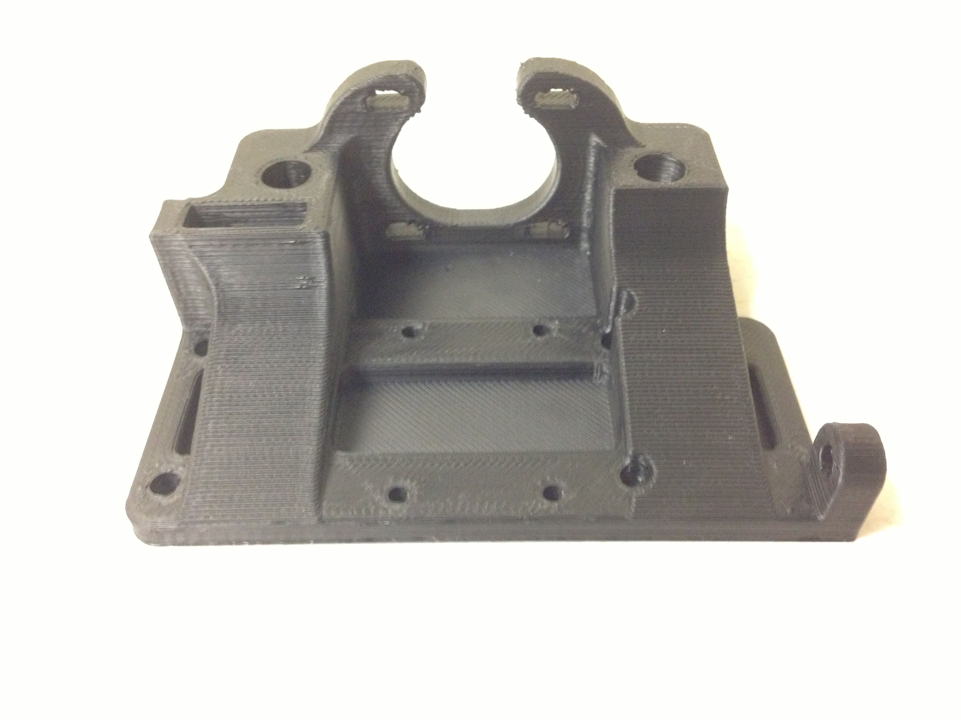

  1. I was having some problems with fill, bridging, blobs - really just messy prints. I had performed some rough calibrations with calibration squares and thought I had things looking pretty acceptable (except for some squishing on the bottom layers). I was wrong - I tried to print the extruder idler and no dice - just messy, nothing near the quality of the idler that came with my TAZ. My slic3r config was very similar to those I found in the LulzBot download and development areas. I broke down and decided to do some serious calibration. I really liked the nickel calibration print mentioned here https://forum.lulzbot.com/t/undersized-ids/219/2 First thing I did was load new firmware with the EEPROM options enabled, which changed the behavior of the extruder. Not sure what was different (this was a refurbished machine, so maybe the firmware was old or modified in a previous life), but I think it may have been the retract acceleration. The firmware update pretty much solved all of my problems. I checked the extruder cal - factory cal was spot on - nice job LulzBot staff! The dimensions of the nickel test piece looked good.

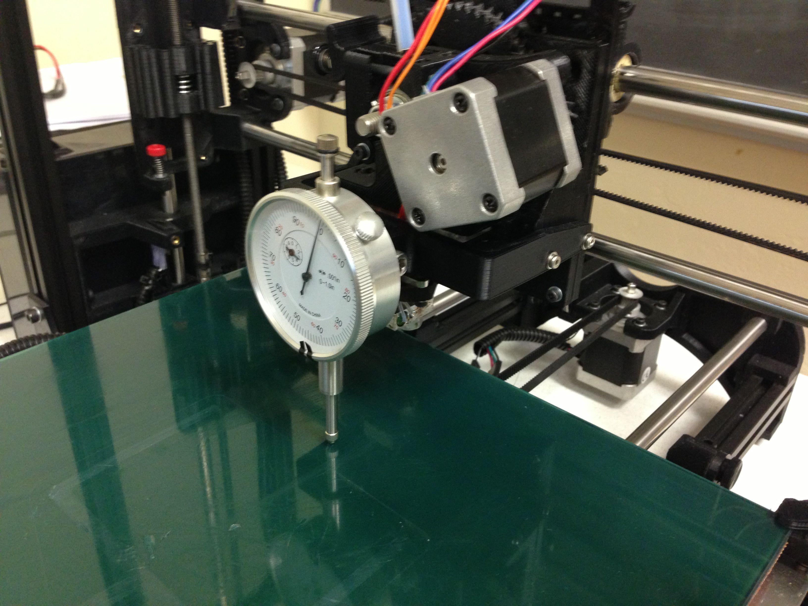

  2. I moved on to tackling the squished bottom layers - which I suspected was due to backlash in the Z axis. 1013 has some great mods listed here: https://forum.lulzbot.com/t/taz-upgrade-list-current-and-future/204/8 The stiffened Z axis mods and the auto bed probing are things I want to tackle - I am a bit time constrained, so for now I need more simple solutions. I printed the indicator holder here https://forum.lulzbot.com/t/taz-bed-leveling/196/1 (thanks RFT!) and purchased a cheap indicator from Harbor Freight. Worked like a champ!
    Manual bed leveling is a snap. I measured the backlash - 0.6 mm. After a bit of playing, I was able to get great print quality on the first several layers (no squishing) by compensating for the backlash using the z-offset in slic3r. A quick explanation of backlash - its the dead zone when changing directions of movement - so I am moving the screw down, now I want to go up - I have to turn the screw the equivalent of 0.6mm of travel for the nut to start moving in the opposite direction. Homing down means that the z-axis has to overcome the backlash to start moving up - the backlash results in no movement - hence the squished layers. Now I follow a process - first raise the z-axis at least 10 mm off the bed (overkill but good), then home, have the backlash set as a z-offset in my gcode, print. The z-offset moves the z-axis screws before printing anything. If I did things right, the z-axis is now on the right side of the backlash and moves up on the next layer. I printed several parts - including 1013’s stiffened x-axis mounts. No squishing.

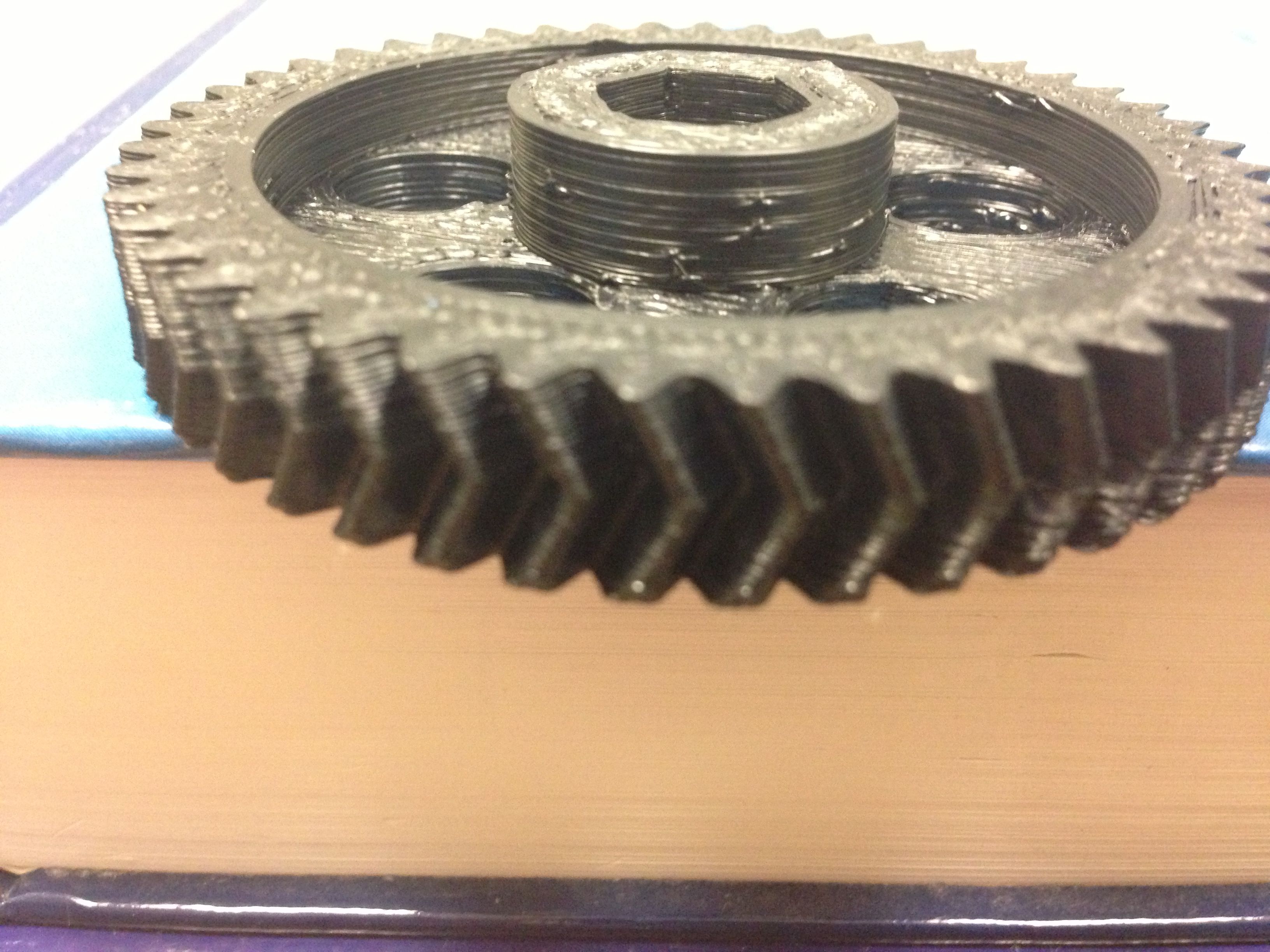

  3. I bought linear bearings, printed 1013’s stiffened x-axis motor mounts, printed the parts for a second extruder, and printed a bunch of various other spares to get more comfortable with printing.
    I have some blobs - I need to play with retract settings a bit - I have the “Only retract when crossing perimeters” options set for these, which may contribute. The quality of the gear teeth is excellent - this will be suitable for a dual extruder setup.

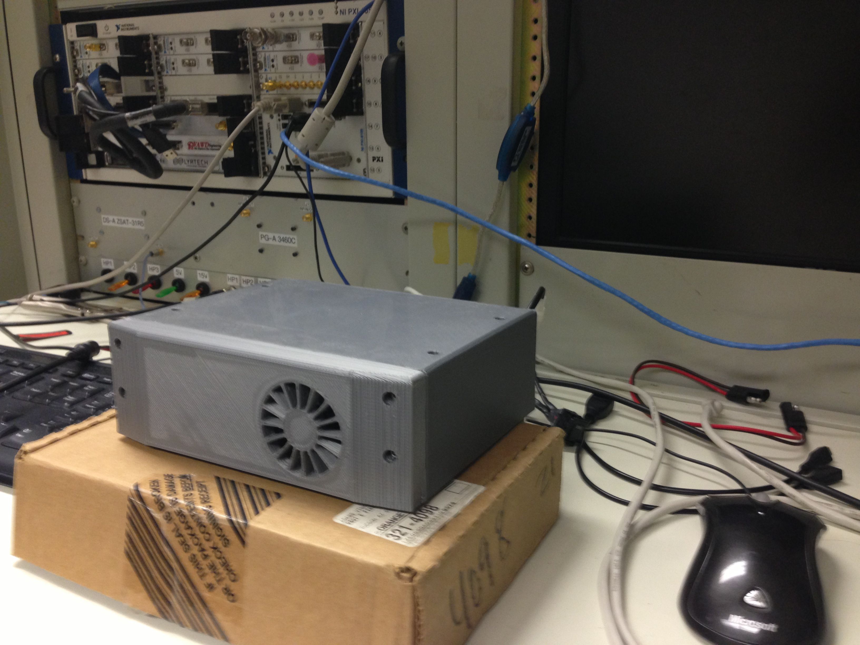

Okay - so here’s where the rubber meets the road.

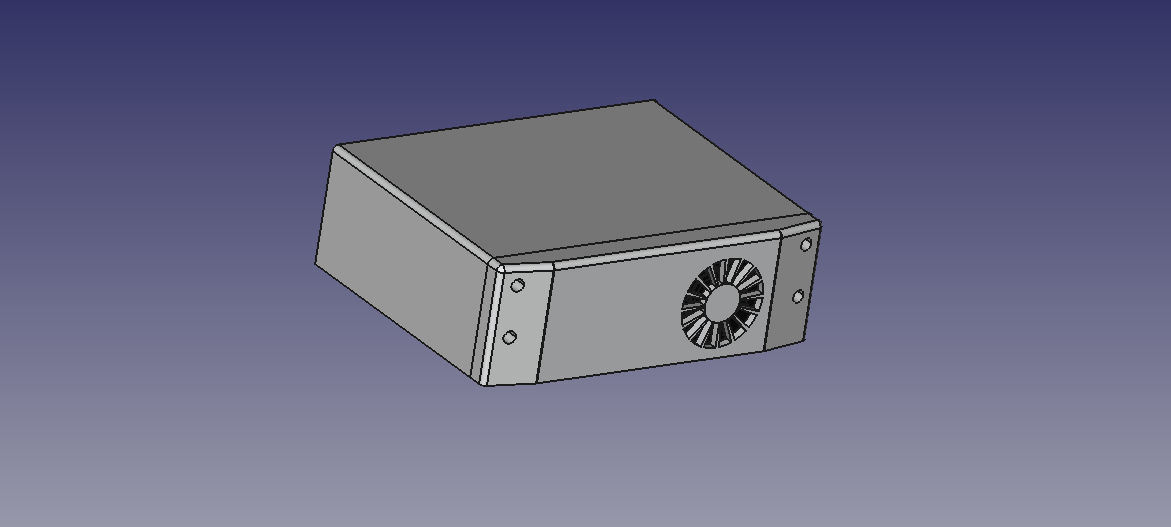

I started with our base Radar stack (we make sense-through-the-wall Radar systems!). Its a 5"x7"x2.5" stack of PCBs. It has a cooling fan and several electrical interfaces.
The FreeCAD design:
The enclosure is 2 pieces - a front panel and a 3-sided case (top and sides). The back and bottom of the Radar stack are sheet metal. I have plans to add our logo in a different color when I have my second extruder integrated.
I have included a tongue on the 3-sided case and a mating groove on the front panel. A couple of heat-set inserts tie things together.
The back of the front panel has a 50mm square cut-out for a small fan - heat set inserts are used to secure the fan in the front panel.
I printed this with the back down - at first I printed half of the front panel, face down as a test. The finish on the bevel was not what I wanted after support material was removed and a little acetone clean-up was performed. So, I printed with the back down and support material in the fan pocket and lightening holes. I printed the piece with a brim and a skirt. Check out the time-lapse video here http://www.youtube.com/watch?v=vcbGsMkGkR8 (sorry for the lighting - I have made some improvements to help eliminate the shadows).
Finished product:
And installed:
Success! Well partial success - the 3-sided print is next!

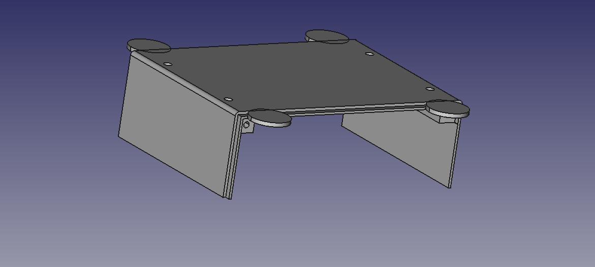

I added some pads to the 3-sided piece of the enclosure. I also added plastic in the corners of the case to replace a metal rail in the electronics stack. This gave me a nice place for some threaded inserts. The two lower holes on the front panel and the four holes on the top of the 3 sides case attach the enclosure to the stack. The top two holes on the front panel tie the panel to the 3-sided case.
The FreeCAD design:
The tongue is visible on the front edges.
Time lapse video of the print is here: http://www.youtube.com/watch?v=vI5Zr25KWkE.
Overall, I was pretty happy - the sides were straight as an arrow. No warping. No cracking. I need to improve the pad design - I think square pads would be a bit better. Some knife work and filing and I was in business for assembly.
Pretty sweet - I printed 2 front panels (first front panel was a little warped) and got it right on the first try with the 3-sided case! A couple lessons learned - 1 knock the corners of the tongue off in the design, 2 leave a little more tolerance between the tongue and the groove.
Overall - really really happy. Thanks LulzBot folks, and everyone that has provided insight for me to get this far!
I am going to start printing the hand held version of the system next week.
