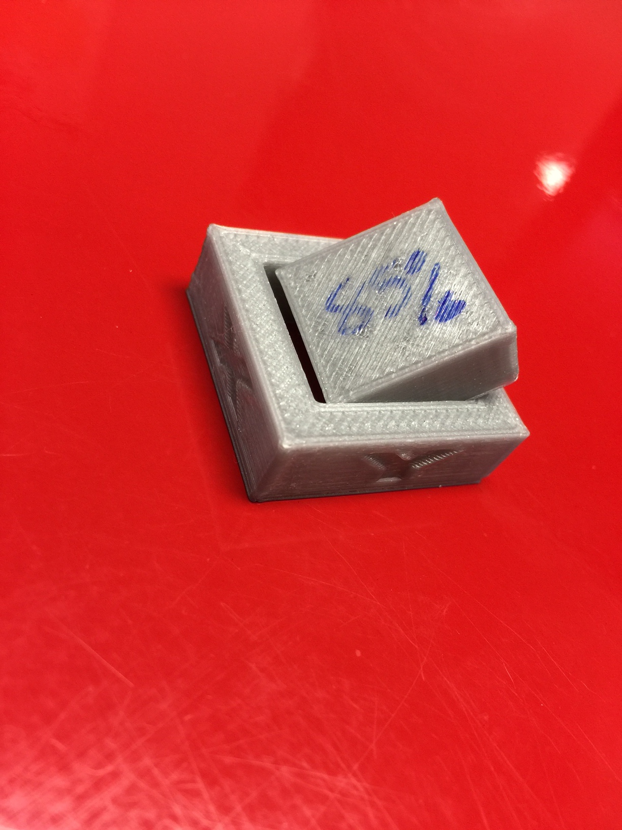

So I changed the filament size to 2.89 which was the average and printed like 5 different test cubes. It is most accurate at 85% flow rate. It’s almost perfect outside and inside dimensions. It seems like that is low doesn’t it? I’m going to try printing some pieces that interlock and see how they turn out. Thanks for the help so far I’ll post a picture tomorrow when it’s done printing.

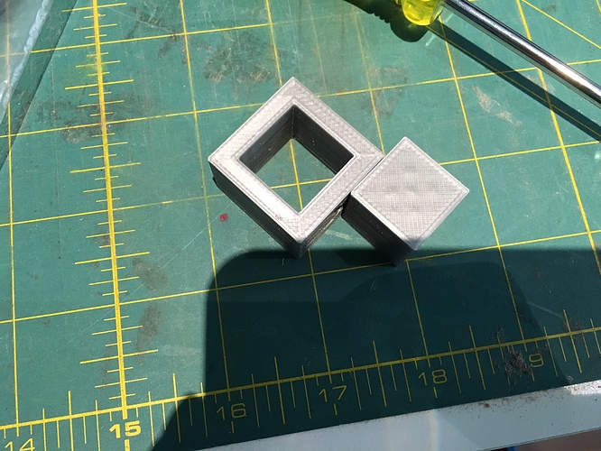

So this is the cubes I printed last night at 85% flow rate which are as close to perfect as it is going to get for dimensional purposes. I tried to take close ups so you could see layer detail and surface detail.
So last night before bed I printed a few pieces for this light saber my kid wants and BAM fits great now. There were some small imperfections in the print but that could be from multiple things not necessarily the flow rate. What are your thoughts about the flow rate being set that low? I guess i’m just surprised at how low the flow rate is. Does the layer and surface look OK to you guys?
Hard to say on the pictures… If there are no tiny gaps between the lines on a top surface, you are not under extruding. Watch at the parts with a bright light source at different angles is the best you can do.
When you do such cube fit tests, don’t forget the imperfect cube edges. It would be better to print the inner cube with a small radius on the 4 edges to eleminate this effect. You might recognise that you can increase your flow rate a little bit again with this…
