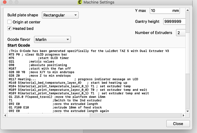

Here are the printer settings. I am not sure why the build plate is set to The dimensions listed.
When I measured edge to edge I find it to be more like
295 wide
298 depth
Please advise

Are you starting with an .stl file or a .gcode file? Please share them. If its a .gcode file, then your options for making adjustments are limited. If its an .stl file, then adjustments can be made in the slicer.
With a TAZ 5, CuraLE is going to be the easiest slicer to use and I would suggest the latest version (3.6.20) and the latest firmware for the TAZ 5 that comes with it. If you don’t want to change the firmware in your printer, then it would be best to use the version of CuraLE that includes the firmware you do have because they operate best as a matching pair.
The coordinate extremes of the printer can extend beyond the edge of the build plate so the numbers you provided aren’t unreasonable. Origin at the center or origin at the lower left doesn’t really matter as long as the slicer and firmware agree where the origin is. It is possible to use CuraLE with other brands of printers, so the choice is available in the slicer.

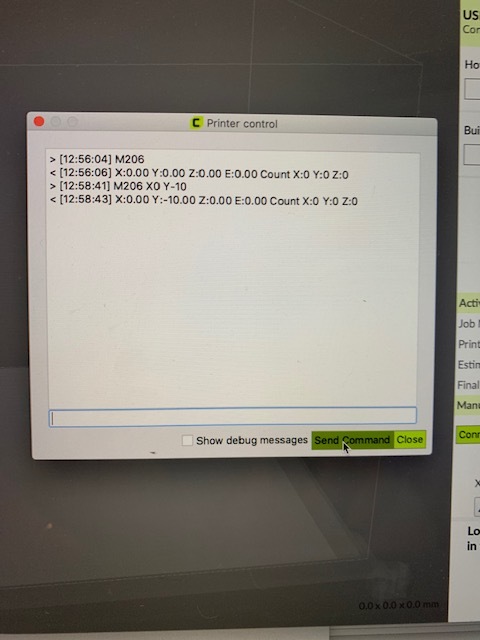

First off thanks again for the support. I was able to make a couple of things that I needed but, now I am still not able to get my head around the process to set the home position for the printhead in relationship to the print bed. I would like to adjust the pertinent parameters so that the calibration print would be centered more to the right and downward. Basically 5 to10mm on the x axis and 5 to 10mm on the y axis.
To change the home position offsets, use the M206 command. Without any arguments, this command displays the current values. I’m not sure if you want negative or positive values but you’ll figure it out. Note that these settings are saved in the EEPROM so after you find good values, do an M500 to save them.

I’m sorry if I wasn’t clear. M206 is a GCode command. You could place it in the Start GCode (as M206 X5 Y5 or M206 X-5 Y-5 or whatever values shift the origin to where you want it). I’d put it after the G28 Z0 or later after any other positioning commands in the part of the Start Gcode I can’t see).
Alternatively, you can use the CuraLE Monitor console to enter the M206 command manually followed by an M500 and it will be set permanently (or until cleared by a firmware update). M206 without any arguments will show you the current settings.
Cool I’m getting there now as you see I haven’t really put all the parameters that the machine sent back in line 2
Should I mimic those line items?
I haven’t preformed any actions yet.
The fourth line is the machine response.

You only need to include the offsets you wish to change, X and Y.
