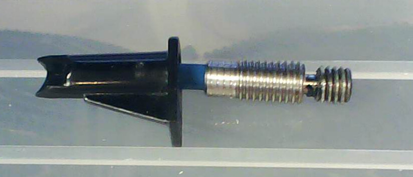

I’ve swapped parts out on the 2.85 SE head to make it run 1.75. It required doing a new heatsink, heatbreak, nozzle, filament guide and small length of 1.75mm PTFE tubing.
As far as I can tell, the only to-spec part is the heatsink, which places the nozzle slightly lower than a standard titan aero heatsink. The only toolhead this is really an issue with is the Pro Dual, due to the thickness of the part cooling shroud. The rest will put the nozzle closer to the part cooling airstream, but if you use a silicone heat block sock, it shouldn’t matter.

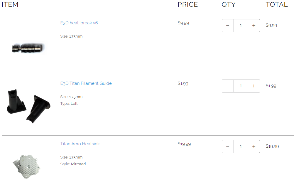

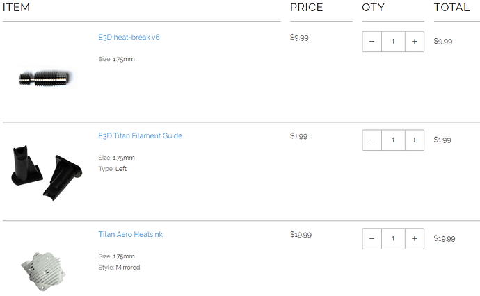

So I’ve already got some new nozzles, does this look right for everything else I need? And is replacing the heat sync necessary? I really appreciate the help.

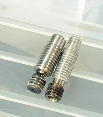

Depending on your heatbreak, you may need some PTFE bowden tubing if you don’t already have some. It goes in the heatbreak up to the throat.
The heatsink is necessary. The threads on the 2.85mm and 1.75mm heatbreaks are very different sizes. The 1.75mm heatbreak is larger diameter to accommodate the bowden tube and filament, while 2.85mm only is big enough for the filament.
If you aren’t printing anything but PLA, you can get away with a 1.75 filament guide and a length of PTFE tube (3mm outside diameter, 2mm inside diameter) running all the way from the tip of the nozzle to the top of the filament guide. That way you can keep the existing 3mm nozzle, heat break, and heat sink.
