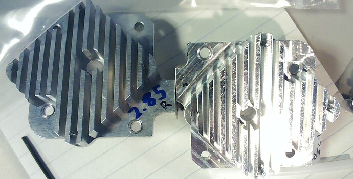

I have a Taz Pro with a LulzBot TAZ Pro Dual Extruder tool head, which currently uses 2.85 nozzles and 2.85mm filament. Is it possible to just swap out with 1.75mm nozzles to use 1.75mm filament, or is there more to it than that?
How reliable does it need to be? Just swapping the nozzle leave the filament completely unconstrained in the heatbreak tube inside the meltzone. If you print fast and never have to retract, you might get away with it, but at how much of a pain it is to clear jams in the Aero (even moreso the aeros in the Dual Toolhead), I wouldn’t recommend it.
To do it (close to) properly, you need 1.75mm feed tubes (normal and mirrored) ($5), two 1.75mm V6 heat breaks ($26), 1.75mm nozzles ($cheap to expen$ive depending on your taste… I’d go with hardened steel CHT clones) and Titan Aero 1.75mm heatsinks (normal and mirrored) ($30). But… the standard titan aero heatsink is 3mm shorter than the Lulzbot version:
So if you only swap these things, the part cooling shroud is now going to crash into things.
So do all of the above, then make a custom part cooling shroud that is at least 3mm thinner than the boxy stock version. This is the last version I was using.

After all this, it still wasn’t great at PLA, but did work. The end cost for all the parts was under $100 with everything shipped.
