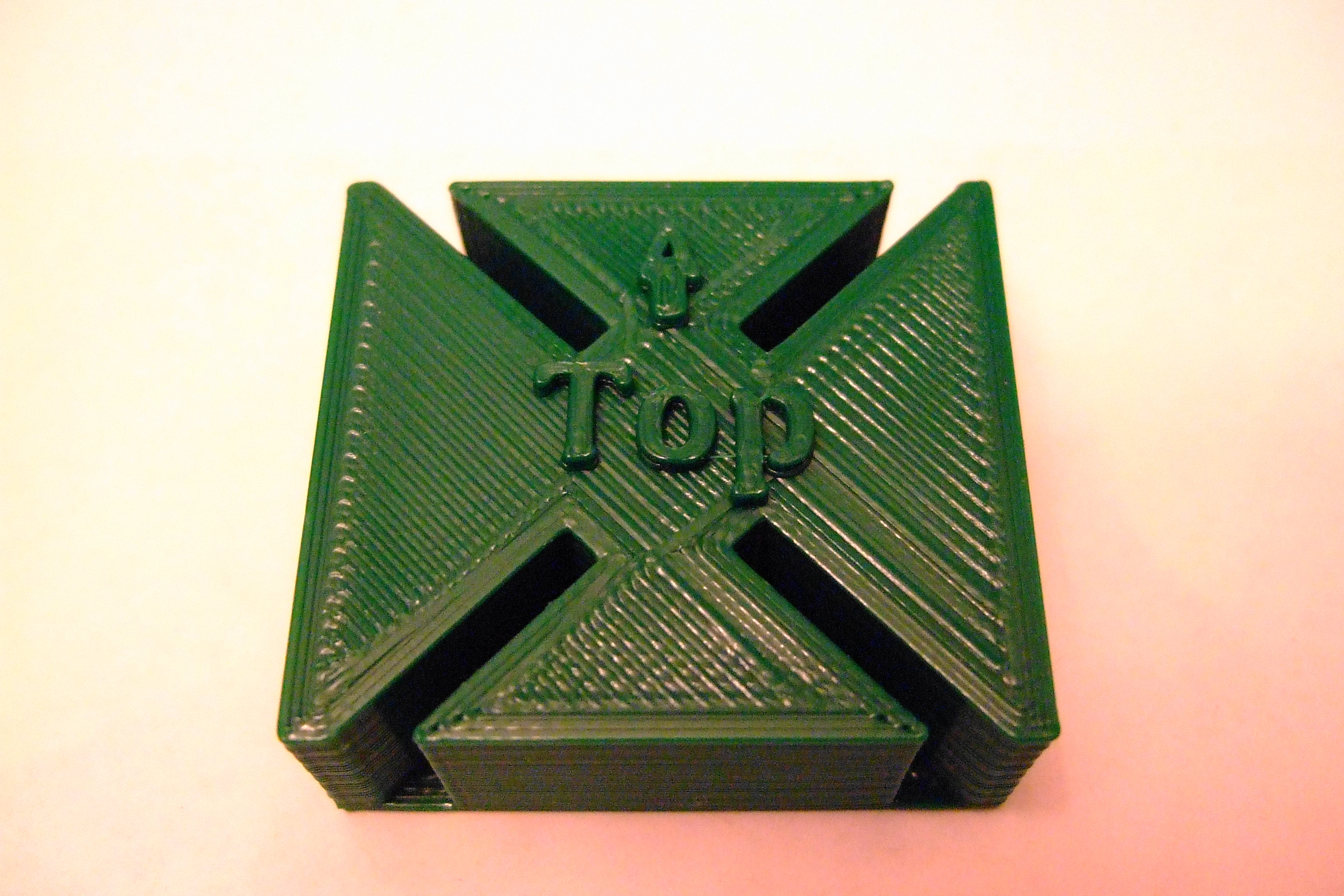

Having had my mini (now 2 of them) for several years I’ve come to realize that work-arounds must be made some time to compensate for the smaller build plate. As such, I’m working on splitting the Prusa RC3 edition of the face shield into two parts to fit the Mini and have designed a new cross attachment and matching receiving block for re-assembly into the whole headband.
Photos:
All the parts
Receiving Block
Cross Attachment
Assembled without Plexiglas
So far, it looks like it’s going to work!
