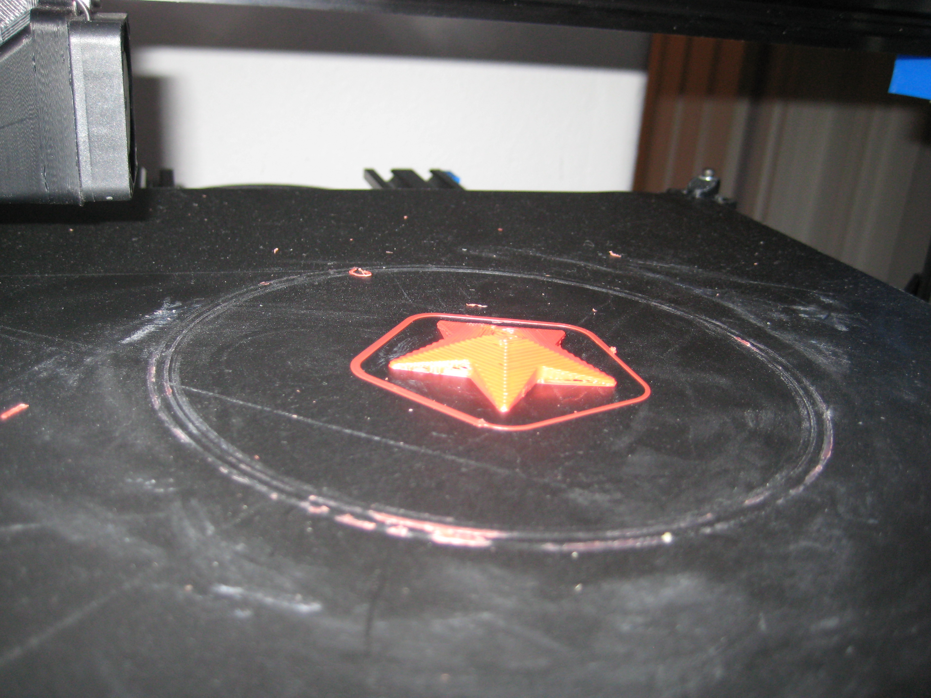

That star should theoretically print fine without support. Bed adhesion would be a little bit of an issue, and the flat spot on top would be a little rough inside due to bridging, but the angles up from the edge are low enough it would print without drooping.
Edit: yup, prints fine without support.

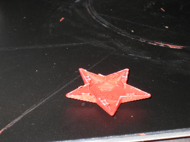

I lost a bit of one star leg to the bed since I wasn’t really being careful about removing it, but that thing is Tiny! with my .5mm nozzle, the little notches were very filled in. Any overextrusion at all is just going to obliterate those. It’s really not a great design overall to be honest. A socket / pin arrangement using printable pins would work much better there. If you were printing with a .35mm nozzle, or if you scale the thing up a bit, it likely will work alot better. I tried one with a brim layer too, and that just nuked the tabs from orbit.
red ABS, 0.5mm nozzle, 240c / 95 c, Buildtak bed surface / Modified Taz 5-ish.

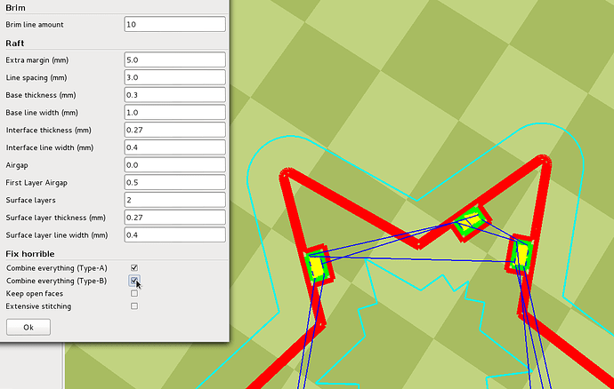

In the off chance that they don’t look just as they should, or for others facing this issue, if you open the expert config, there are two types of correction settings you can pick in the “Fix Horrible” section. When I open the stl you uploaded, if I have type “a” checked, the holes are there, but when I have type “b” (or both) checked, the holes are clearly filled in (note the yellow in the pics below). This is true up through layer 7 (0.25mm layer height). I’ll note that I haven’t tried an actual print of the star though.

I’m using slic3r. I had it dialed in before cura became an option, and I’ve never got cura dialed in to the same level.
