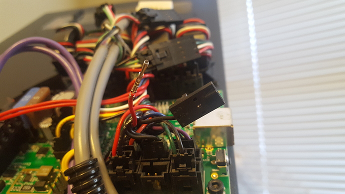

- Unplug small 2-wire connector labeled “Y-MIN” at the bottom right corner of the rambo board.

- de-pin the red wire from the connector on the rambo end. You can use a needle or the probe from your multimeter to press the spring tab and pull the pin backward out of the plastic connector.

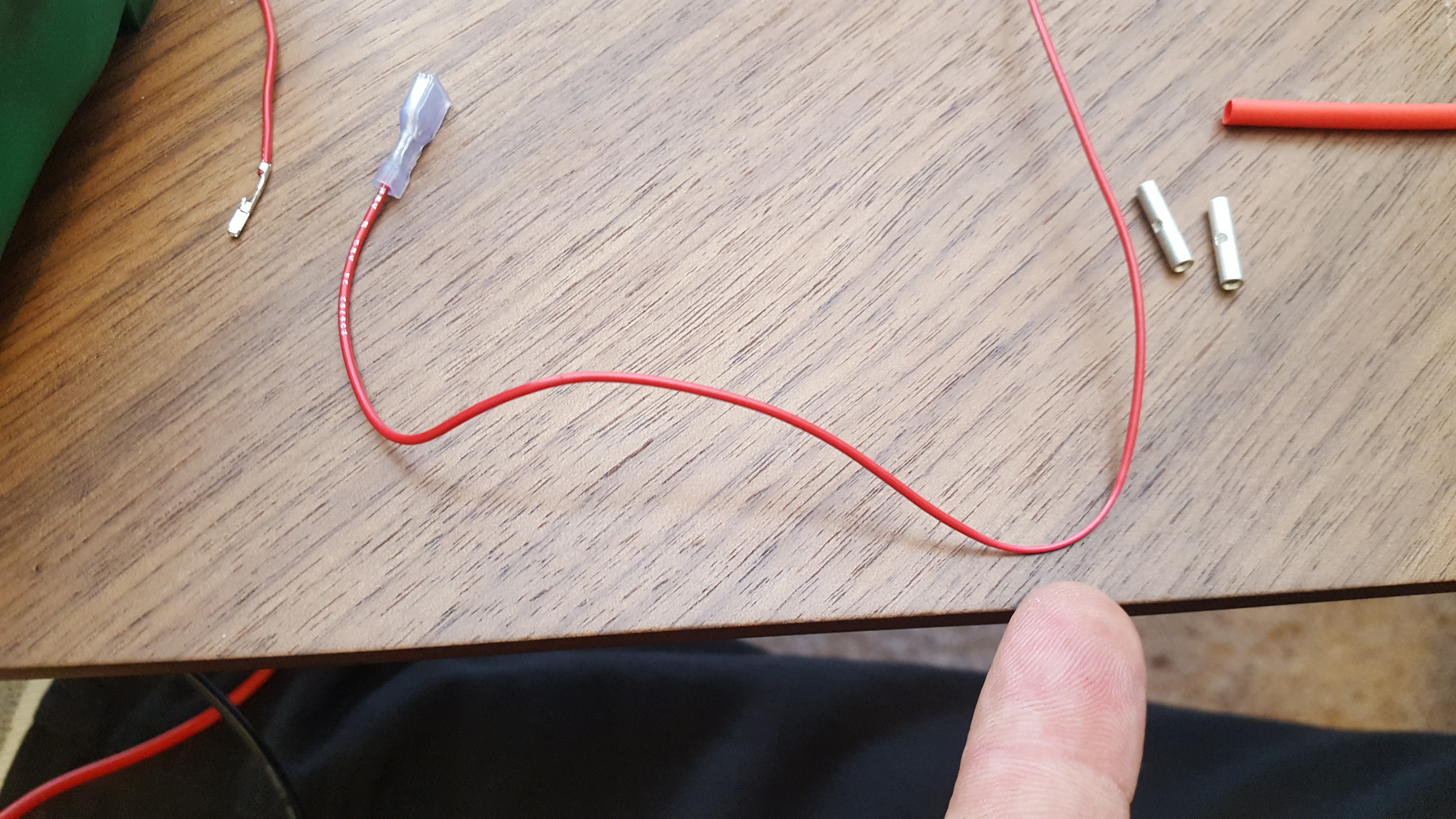

- Cut new length of wire 1-2" longer than the removed wire.
- Cut off original connectors from broken wire about an inch from their respective ends. If you happen to have those connectors on hand you can just make a new wire. I didnt and I didn’t want to get them, so I reused the originals.
- strip new wire ends and connect original connectors to new wire via butt connectors and heat shrink.
- Connect female spade end to the y-limit switch.

- reinsert pin into two pin connector at rambo end.
- Plug connector into rambo board at the “Y-MIN” location.
