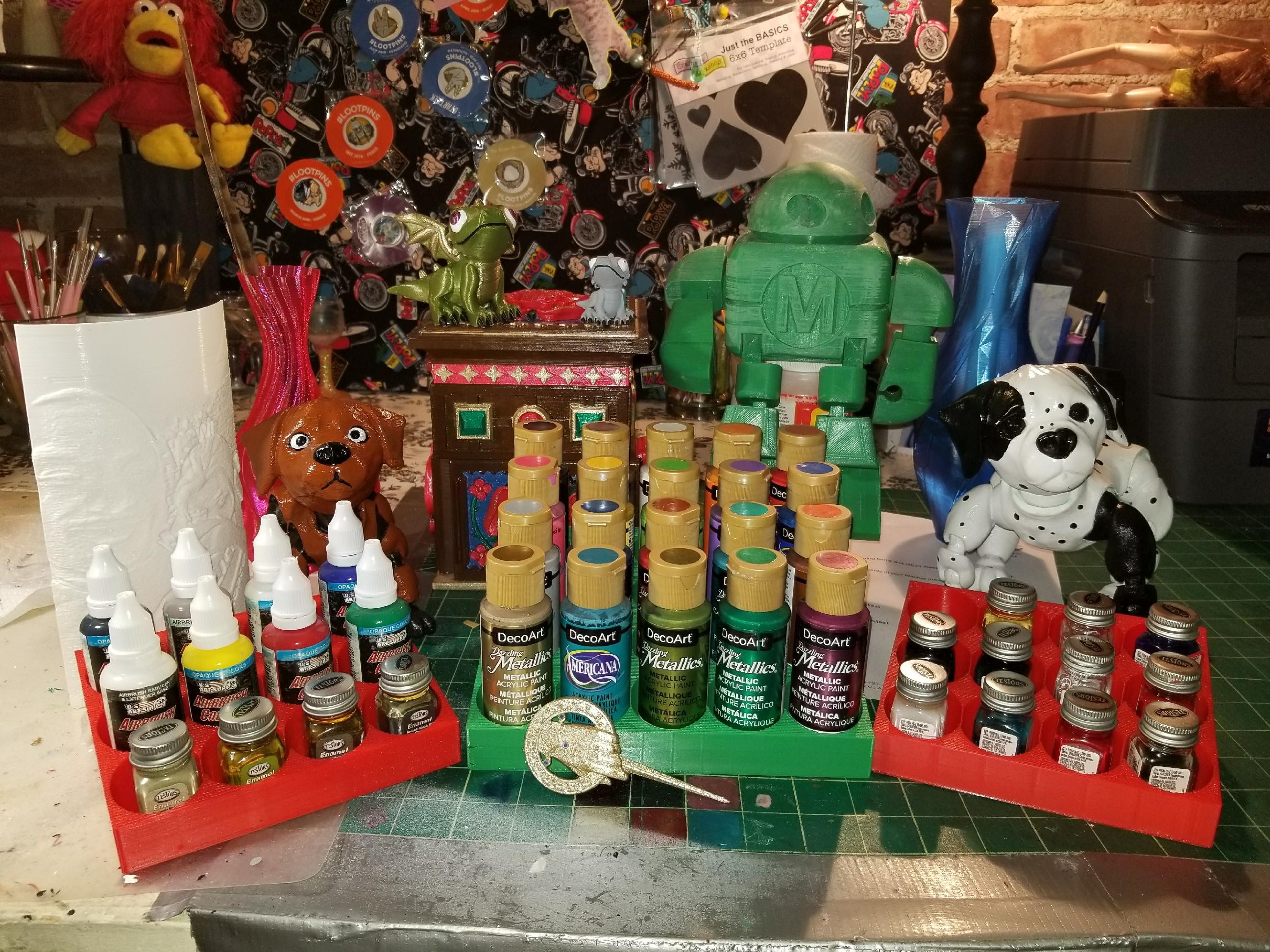

I could have used this tip making the paint holders for my wife pictured below, they where a pain to get off the print bed.
