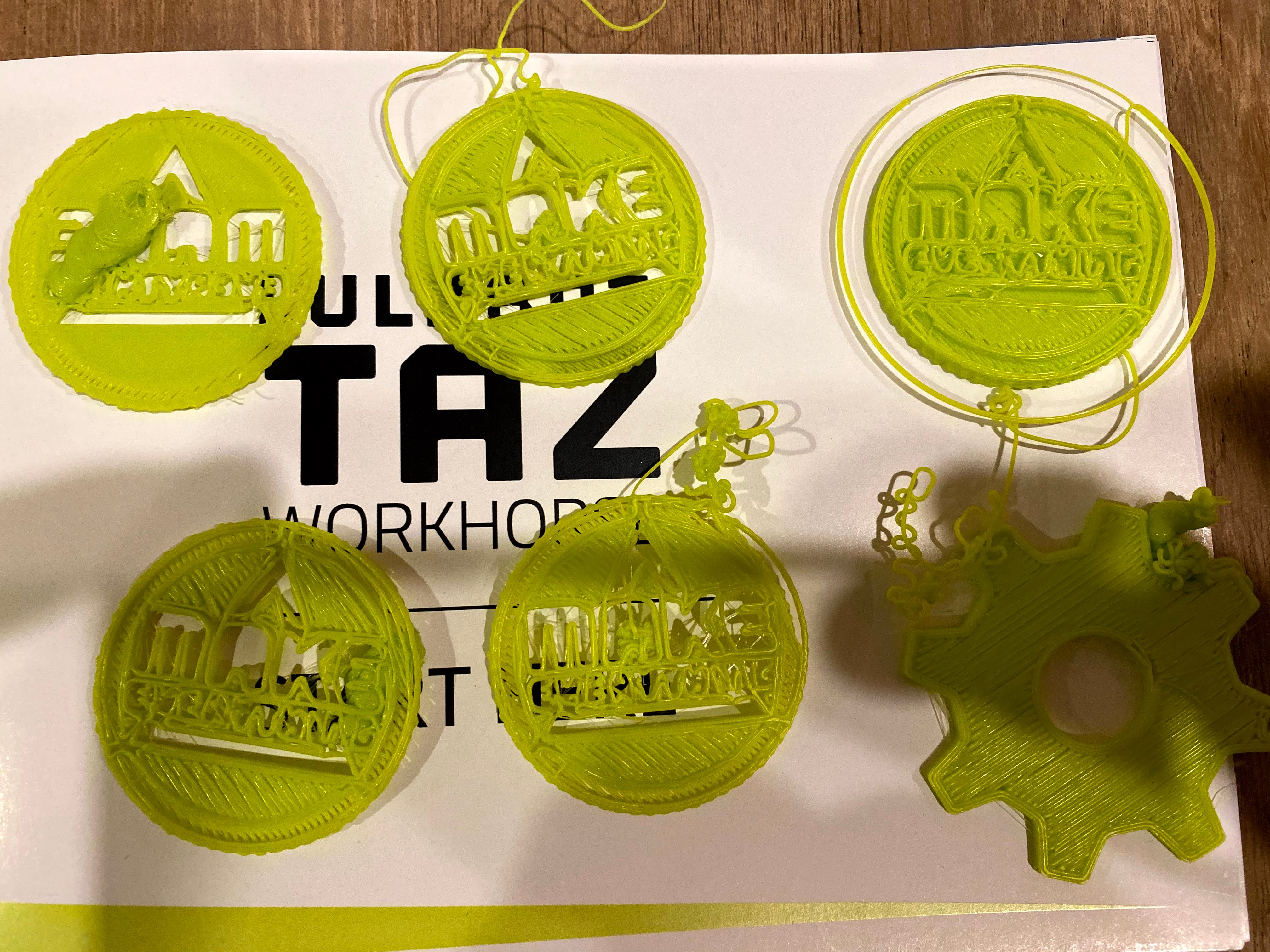

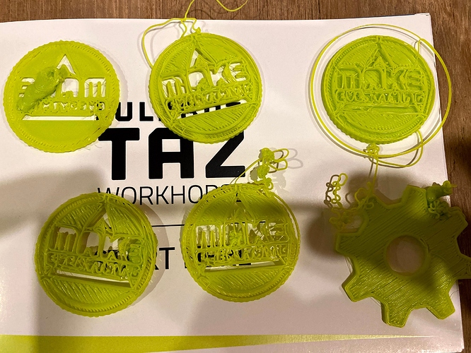

Hi all, I just received my Workhorse and I’m trying a first print with the included Polylite PLA. I can’t get it to adhere. There are so many suggestions here, but here is what I tried:
  • Cleaning PEI base with magic eraser
  • Cleaning PEI base with 70% IPA
  • Adjusting bed temp to 60C (though it drops to 45 after first layer - don’t know how to keep it higher)
After a few layers, the print is dragged. I’m just trying to print the flat coin - model here: http://download.lulzbot.com/3D_Models/LulzBot_Coin/LulzBot_ME_Coin_Flat.stl
I’m looking for the next thing I should try, but don’t know what I should do!
I tried using an Elmer’s glue stick on the cleaned bed - gets a few layers further but then gets dragged. I noticed that the print settings for the material (the supplied PolyLite PLA) show a 60C build plate temp, but as I said before it only goes to 45C according to the LCD, and to my hand (feels like ~40C).
The prints are all really sloppy - there are blobs all over the current layer being printed. I checked that the Z offset is the same as in the QA sheet supplied with the machine (-0.67), as I was worried it might have been reset.

Thanks for the tips - I realised now that I was not actually setting the bed temp to 60 for the entire print, so I am now. It’s adhering better. I also set the Z hop to 0.3mm as recommended.
However, just watching it print, the nozzle is being dragged over the top layer of the print and the head is just vibrating up and down on it (this is not the Z hop - I can see and hear when that happens).
It’s as if the bed is raised in the middle by a fraction of a mm. I will try printing at the edge next to see if it’s better there.
I’ll contact support about this as it looks like I have a warped bed.
Same issue at the corner. I still can’t get a print to work and I’ve tried reducing the flow rate to 90% too. The nozzle is just too low and plows straight through the printed piece.

This was the problem. The offset as supplied from the factory was -0.67 (verified in machine and written on the QA sheet that came with the printer), but I had to adjust it to -1.20. The first layer was just glooping all over, but with this being my first 3D printer, I had no idea what to expect.
Looking at the example print supplied with my printer (and printed on my printer), the first layer seems correctly compressed. Looks like something shifted during shipping.

Now for the other oddity - the included test piece (octopus) and the first piece I printed (the recommended gear wheel) have a perfect first layer. At the time I did not pay attention to the skirt that was printed. Using the same included green PLA, the next five pieces I attempted all failed due to the first layer not being put down correctly, so something must have changed between my first and second prints. I guess this will be a mystery.
The washers all appear to be correctly tightened down. I do remember now that my machine made a hell of a crashing sound when first turning on. It hit the top z limit switch without stopping in time (I checked the wires and they are fine). Though it did print correctly the first time after that.

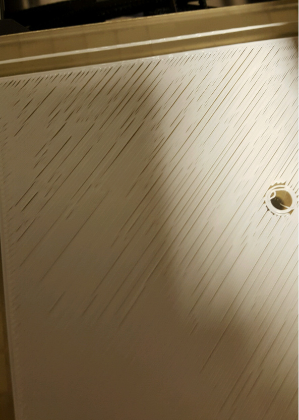

I have had the same issues with prints not sticking to the bed resulting in a huge mess when I come in the next day, one mess resulting in the bed belt snapping. We have two TAZ Pro’s and both have issues with filament not sticking to the bed. I’ve adjusted Z-offset, used glue, different bed temperatures, making sure the bed is very clean, etc…any other ideas?
It’s difficult to tell from the photo but the gaps between the filament that has been laid down could be due to your Z offset still being too high, or the flow rate could be too low. Did you “live adjust” your Z offset while it was printing?
Is this PLA?
I allow it to start printing, stop it while checking the gap then adjust the z-offset. I’ve even had it where it was clearly too close to the bed creating too much squish. Everything else is default for PolyLite PLA for the most part except for trying different bed temps. Small prints have no problems but the large ones like the picture shows are just not doable at the moment.
I’ve literally only got a few days of experience with 3D printing, but to me that looks like you’re not putting down enough PLA to fill the gaps if your Z offset has been adjusted correctly. My top tips for better adhesion are:

Thanks for the reply, the gaps you’re seeing are not actual gaps, they’re sections of PLA that didn’t stick to the bed, everywhere else where it appears smooth and uniform is where the PLA adhered to the bed just fine. I had two TAZ 6 printers before the Pro’s for over 2 years and very rarely would I see any non-adhesion of the filament to the bed. The beds between the 6’s and Pro’s definitely look different and that’s why I’m wondering if the Pro beds need some fine tuning?!
I have no problem with the leveling and have tried different bed temps including 60C and lower and higher to no avail.
