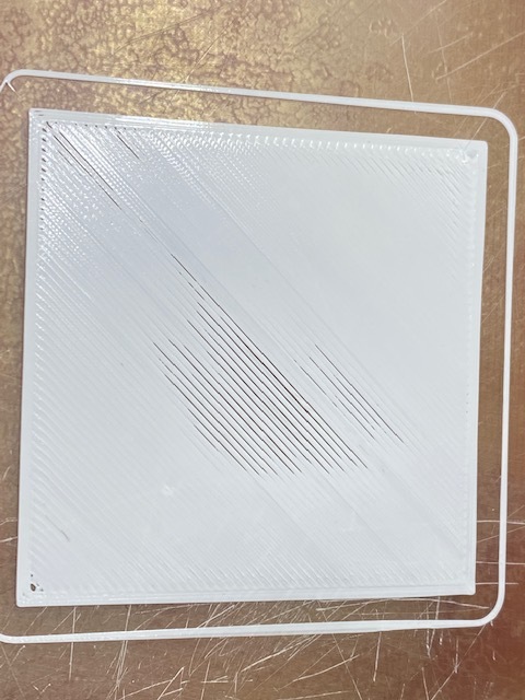

I’m having some problems with my PLA printing, as shown in the pictures above
I have a TAZ 5, Hexagon hot end, I have tried printing at 195, 200, and 205c, I have tried printing at these temp with the bed temp at 60, 0, with blue tape and without blue tape.
The print starts out looking good, then as it prints the filament starts lifting from the bed and the nozzle starts touching the layer next to it.
The first layer line looks good when it first starts to print, but gets worst as it prints.
I have check the extrusion rate and this looks good.

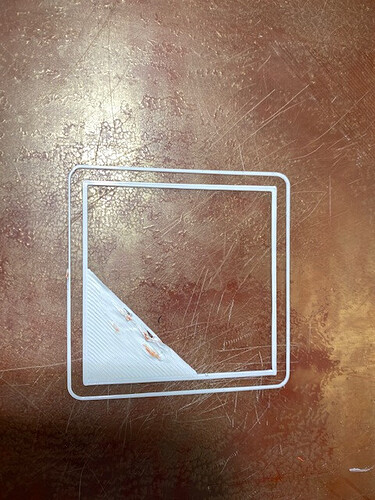

If you move the model in your slicer to a different spot does it still print like this? To me, it looks like your PEI sheet needs to be replaced. You can tell by the different colors, red where the adhesive is firmly on the glass and cloudy where its not. It would explain why you seem to have good first layer adhesion in some spots but not others. Maybe not THE fix, but would improve your initial layer.
I also tried printing on blue painters tape and it gave me the same printing problem
I wouldn’t rule out the surface being the issue from using painters tape. It wouldn’t fix the PEI being uneven, it would just make the same uneven surface .1mm higher.

I have moved the print item to different location on the TAZ 5 bed and the same thing happens as shown above. When the print starts out, it looks good as the lines get longer the print starts to go bad. It looks like the nozzle is not tracking true. As the lines get longer it looks like the new line is laying down filament on top of, or too close to an already laid down line. I have no idea why this is happening. The filament is sticking to the bed and it looks like the nozzle is at the right height.
I could really use some insight into what is happening, this has really got me puzzled.
This is my latest print
The problem seems to be that the Nozzle is laying down a new layer too close to the previous layer and it starts to happen as the distance increase.
I have tried printing at different areas on the bed, but get the same results.
I can’t understand why it starts out printing great and the just get worst.

Looking at the last pictures you posted your PEI is not fully adhered to the glass anymore. You will not good layers if the PEI plastic is able to move up and down as the filament is being laid down across it. Plus it will cool too fast and come right up of the plastic like that.

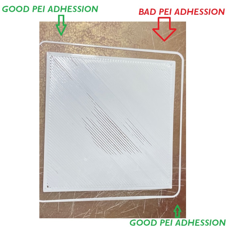

Your PEI sheet definitely has outlived its useful life. They’re $20, I would look into replacing it.
If you’re just trying to get the PLA to work a couple band-aids could be using a glue stick to make sure you get good adhesion, and increasing the initial layer height.
Here is why i’m pretty sure its your PEI sheet. Notice how you have good smoosh where your PEI is lifting off, and you have worse smoosh where your PEI is firmly on the glass. I might be wrong but thats the best input I can give this situation.
