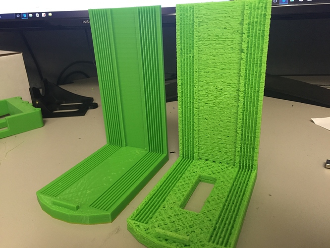

I have two v2 flexystruders and they are both set up the same and one can work on the cura pre set options but the other one will only get about 20 layers in and then get clogged.
they are both running with the same settings but I was wondering if the esteps would have an effect on the print clogging?

Do you have a photograph of a print we can see?
For starters, you are either overextruding, or printing PLA with the cooling fan turned off. That is not a normal print surface. Your idler arm spring tension may be too low. Also check that the fillament path isn’t being bound up.

I’m printing with cheetah flex and I am using a fan, and what do you mean by that’s not a normal printing surface?
I got it working. I think it was a combination of the wrong flow rate, layer heights and print speeds.
flow is at 95%, layer height 0.2, and the speed is a little slow but I have it at 10
