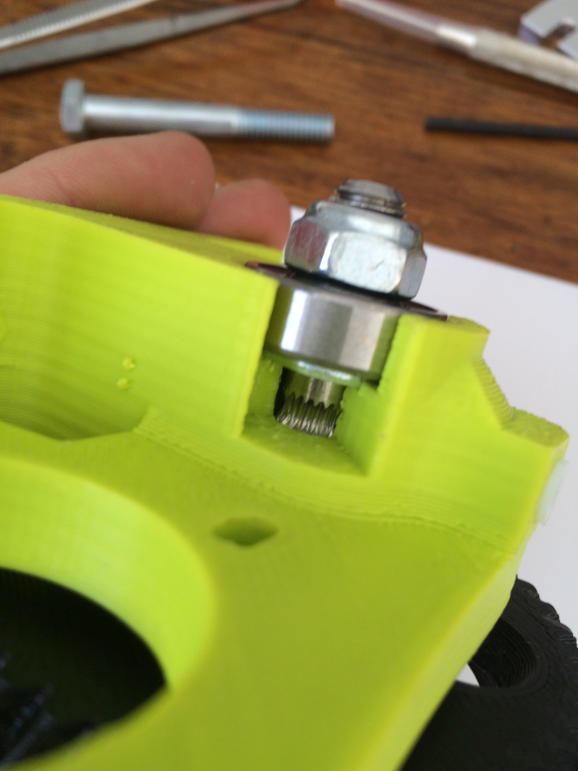

I’ll post some ugly pics.
I have to dissemble almost all the unit to get to the hot spot and remove big chunks of NinjaFlex.
Now it’s time to reassemble it. Without any instructions or assembly notice other than the mounting instructions, I have to figure it out using my photos…

Found that the serrated portion of the axe was not inline with the filament path. Played with the washer order (different than the assembly picture) and it was a lot better.

First: the hole diameter for the main serrated shaft is way too big, leaving a large gap between it and the housing. 8.2mm on the sla file as well as on the fabricated part vs a bolt diameter of 7.8 = .4 mm. Considering that the shaft itself may be slightly misaxed, this could represent an issue.
I’ll try building a corrected part to fix this.
Second: the unit I received was not tuned. The filament path was not in line with the hobbed part of the bolt. Need to play with the washer order.
Third: Cura’s default settings should turn off retraction and slow down the speed I think. Going backward with a flexible filament maybe tricky. I’ve also increased the nozzle temperature to 230 C (vs 222) in order to offer less resistance after the hoobed part.
Fourth: The PTFE part was so badly cut that it’s leaving a really big gap between it and the shaft by more than 1.5mm. This is neatly inappropriate.
Fifth: Construction should be modified to accommodate such maintenance and to prevent damages done on good parts.

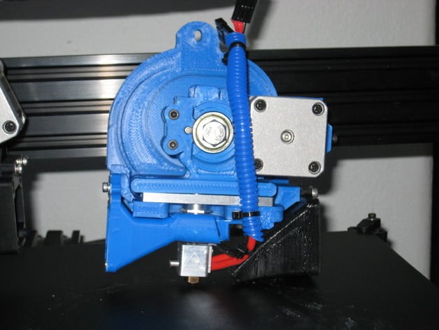

I’ve been able to take the STL and import into SketchUp for modifications and cleanup.
There is another variant. Takes a bit of parts though.

I am unwilling to take mine apart just to take a picture. But yours looks like the tube moved around when they drilled out the hobb bolt section. It should be a nice semicircle cut just like the picture in the OHAI guide shows.

Spend my Sunday on it, but it works! It’s printing for hours now… Hope it will for all of my parts.
  • Tighter tolerances around shaft and housing as well as around the ball bearings. This is really improving quality IMUO. No more shaking.
  • PRECISE cut at shaft diameter on the TPFE tube. I’m using a 3/16 in tube from an older machine.
  • Spacing between the main gear wheel and the housing is adjusted.
  • Opening on the right side of the tube is now closed with a removable piece. This should allow maintenance in case of filament overflow.
  • Addition of viewing openings on the tube. Dark material can be monitored if in.
  • Reduction of overall complexity and radius added for improved stiffness. I’m still questioning about the slight curve on the top.
  • Detail added for removing the ball bearings.
  • Include are my STL files. Still need some tweaks but usable.
