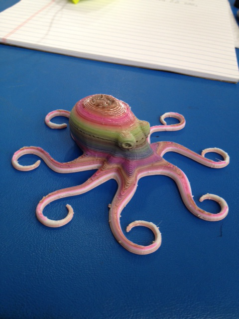

We’ve been doing a lot of testing lately on our new flexystruder, an extruder for flexible filament.
As it turns out, you can make some pretty great multicolor prints by coloring white ninjaflex with a sharpie before it feeds into the extruder. Props to Kent ans Kris for this awesome funky octopod.
nice! did you use that inline sharpie pen holder filliament colorer they have on thingiverse for that?
I hadn’t seen that before, but it looks great, I’ll check it out. :slight_smile:
For anyone else that wants to try: Filament Colorizer - Sharpie edition by ramai - Thingiverse
Definitely an interesting technique. Mostly for things that can’t be easily machined due to their shape
