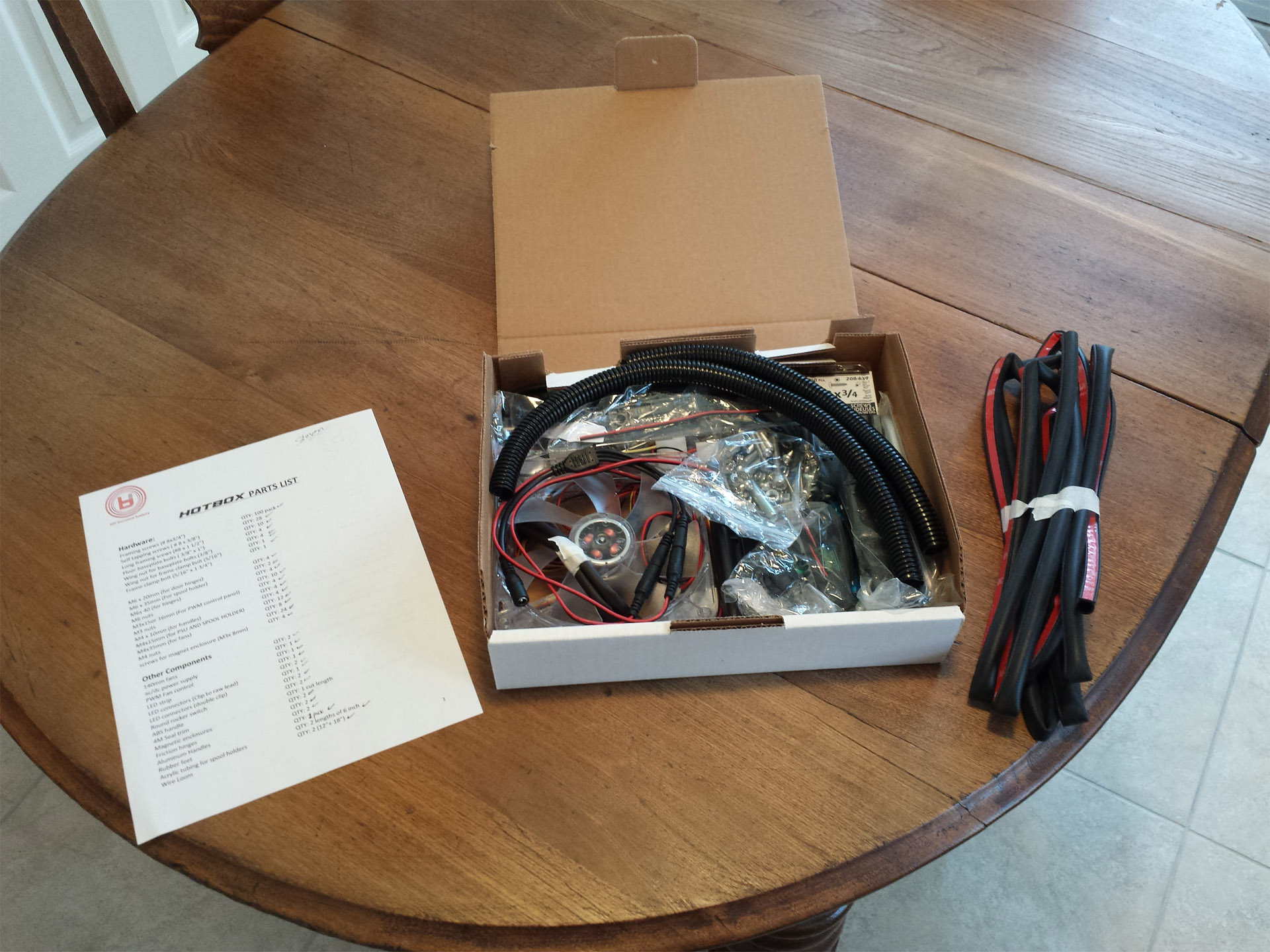

Got my kit today, shipping was insanely fast, especially coming from Canada! Working on printing the parts now, and getting the mdf tonight. Very excited to start building this!
