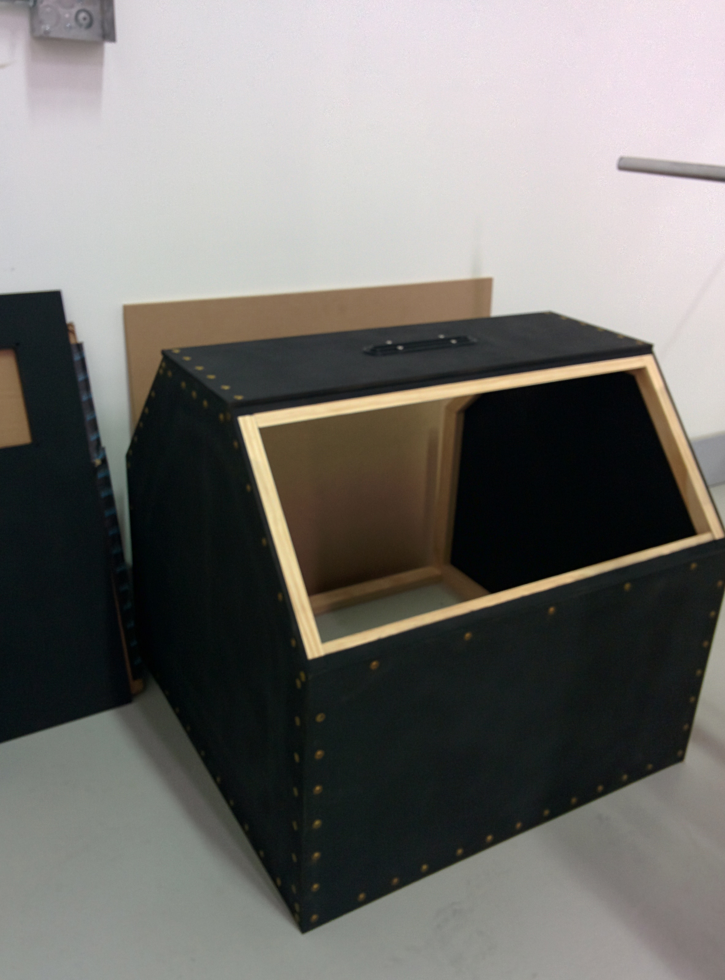

HOT BOX 3DP ENCLOSURE SYSTEM (For Taz)
Prototype modified Hotbox for my modified Taz. This version will probably end up residing at the local Makerspace for one of their Taz’.
http://www.haveno.info/IMG_20150531_201523.jpg (Slightly blurry when not viewed on phone, oops.)
Nice work, can’t wait to see it finished…is that insulation on the outside? or just black fabric, will be interesting to see how much heat it holds in…

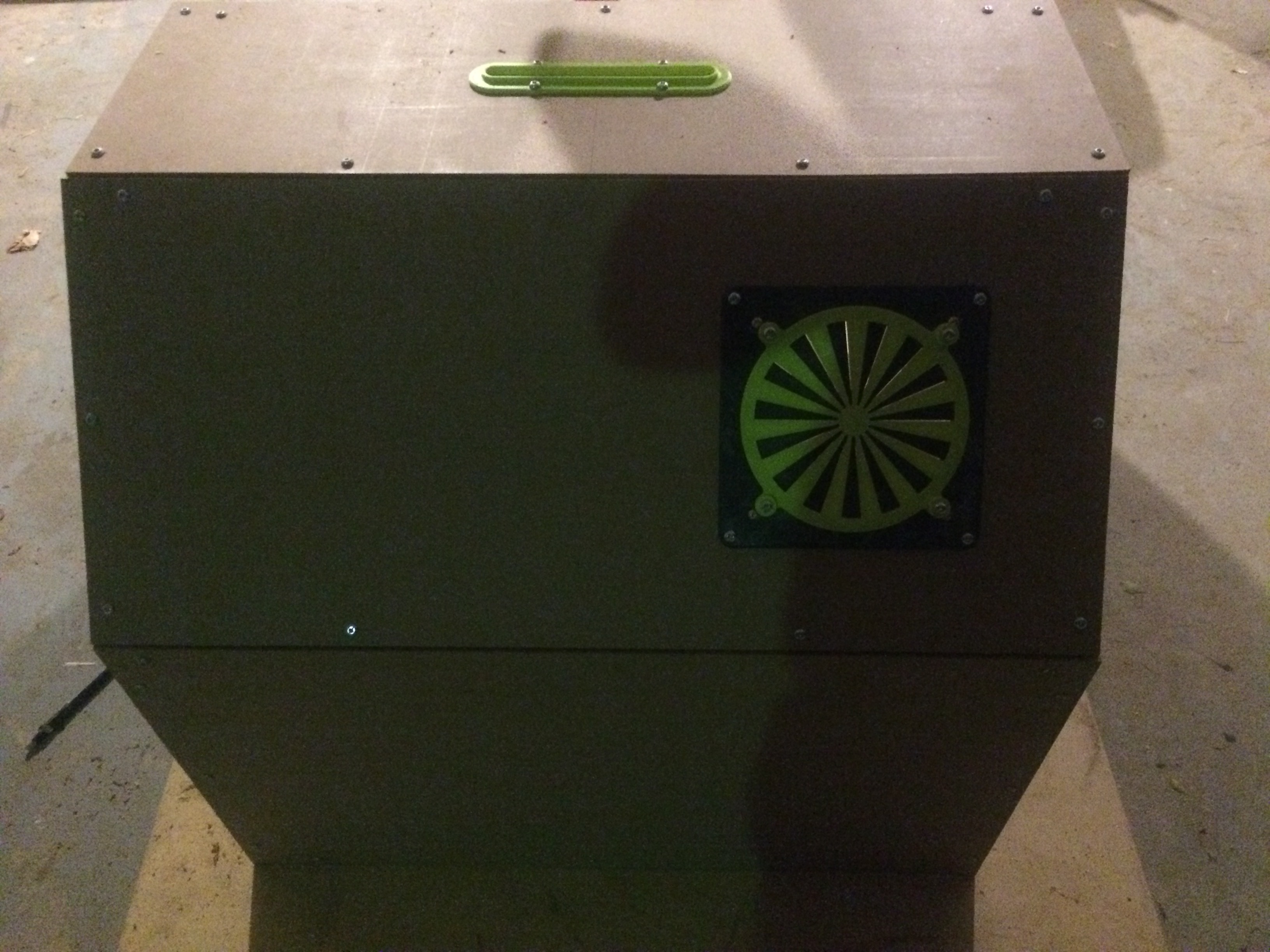

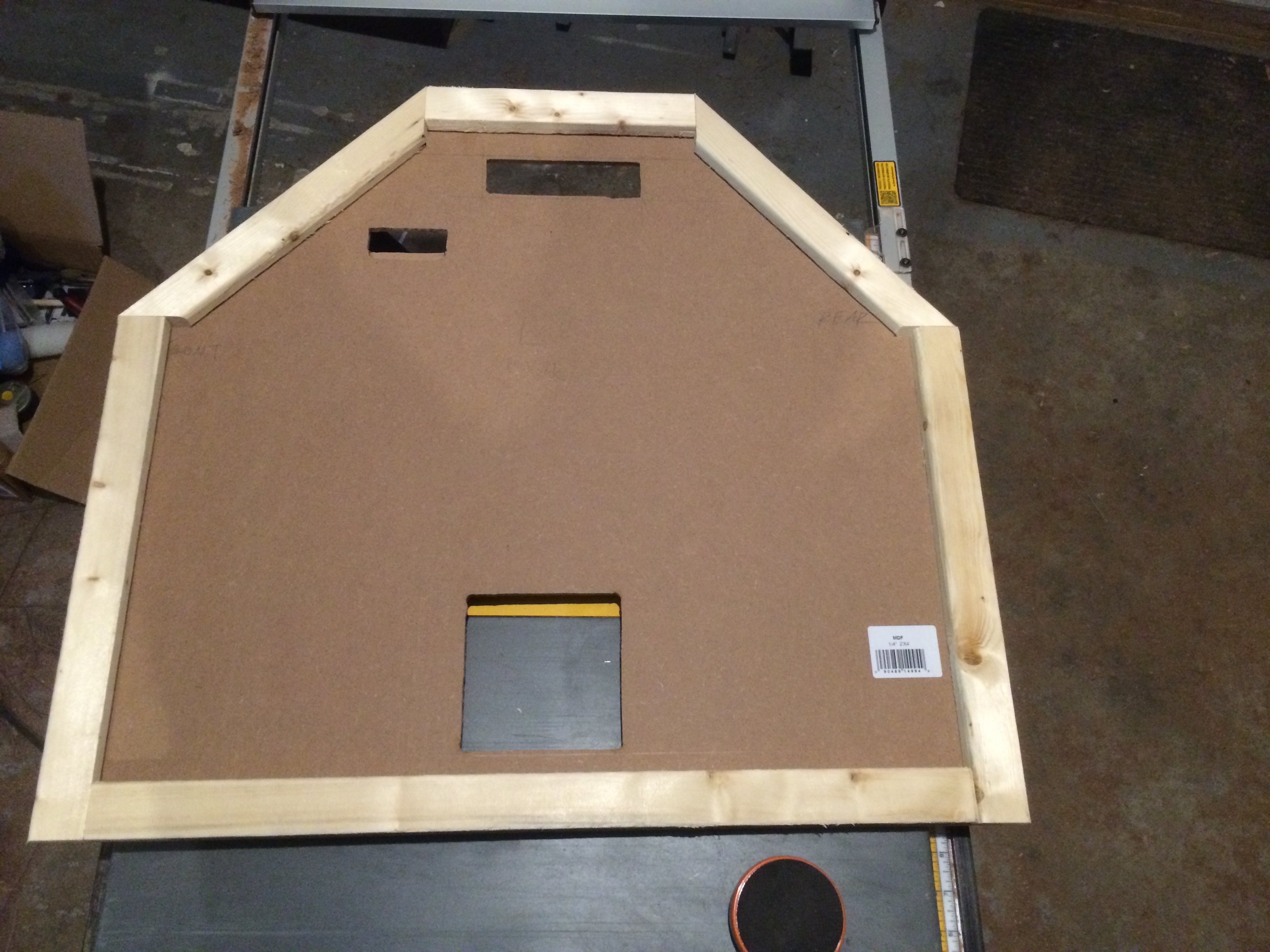

Here you go. I am still waiting on the handle inserts, the acrylic tube, the friction hinges and the window is being fabbed locally. All the hotbox parts are in abs. I had to print the top tube guide twice as it lifted once. I’ve been running large brims on the flat parts to help with the lifting. I have had some issues with abs and hips on tall thin-walled items or flat items warping post-printing. I also added a vent grill for the ebox to match the fan plates. The fans are just on/off with the switches on the right vs variable speed.
One other thing I did different, which in retrospect I’m not sure if there is any advantage except not needing epoxy, is I used 3/4 inch MDF for the base part, and used threaded inserts and brass machine screws for the base brackets rather than the epoxied hardware and wingnuts. We’ll see how they handle things long term. And the gasket I made didn’t slide on the feed tube as well as I liked so I pulled it out. I may try a felt gasket at some point. Your cad files were great. I imported them into Creo parametric and so I had the entire assembly to check over. You really did a great job. Fit my Taz like a glove.
@Jonathan – thanks I really like how the colors came out. I had the Lulzbot green filament, so it felt right to use it on my enclosure. All parts are printed in ABS and turned out really nice. Great design.

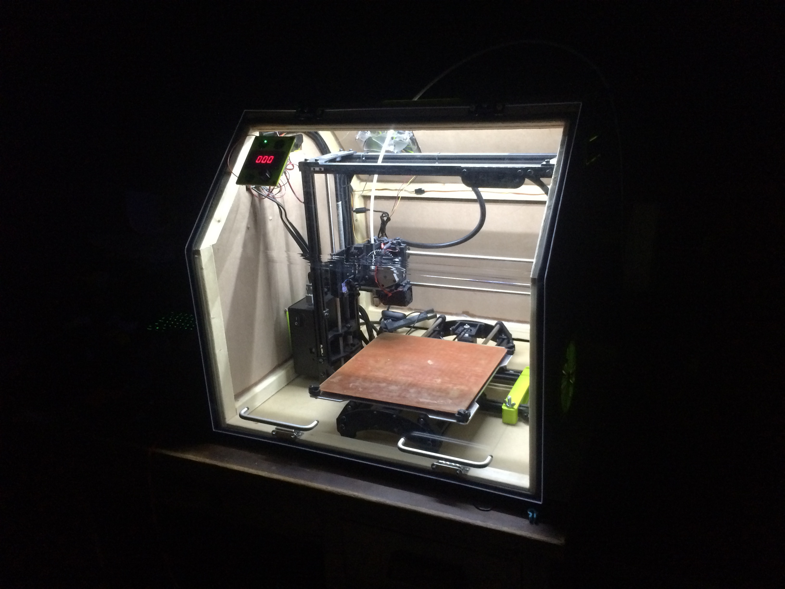

Well my enclosure is finally finished! Excited to start running some tests on this thing and see how well it does. Anybody have a stl that would be good to test for warping? The acrylic piece right around the bend is not quite touching the stripping so there’s a little gap there. I’m convinced it’s the guy that made it so can’t complain there. I think a thicker piece of weather stripping should do the trick in sealing that up. I really like the LED’s in there to keep it well lit so I don’t have to have the lights on anymore to keep my TAZ lit up :slight_smile:
I’ll post my results here after I run some tests. Excited to see the improvement in my prints!

The black ‘fabric’ is simply chalkboard paint. My actual insulation hasn’t been selected yet. As I said this is a prototype for me and will get a v2 anyway. Nice work on the rest, especially time spent on images!

Gotta get those pictures turned around there buddy…my neck is getting sore. :laughing: Build looks really tight though. Nice to see it come out like it should from a secondary source who followed the instructions etc. Looks like they did the trick.

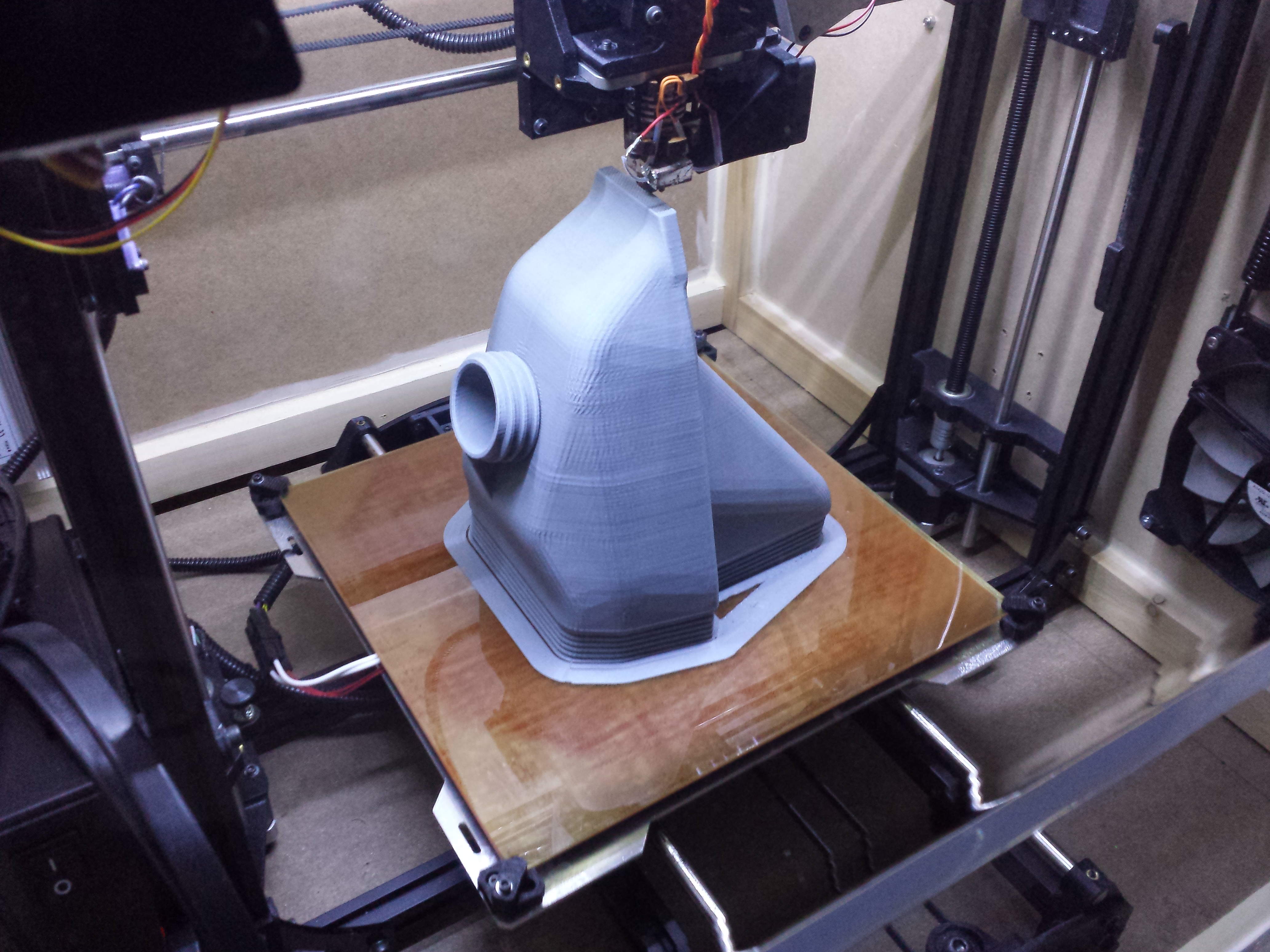

how is this for testing out your new hotbox… :wink:
32 and 36 hour prints. :laughing:
Great looking parts.
