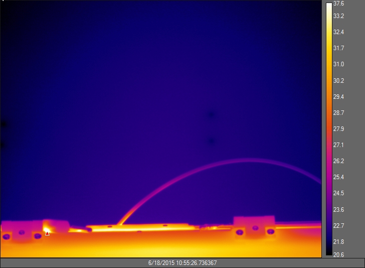

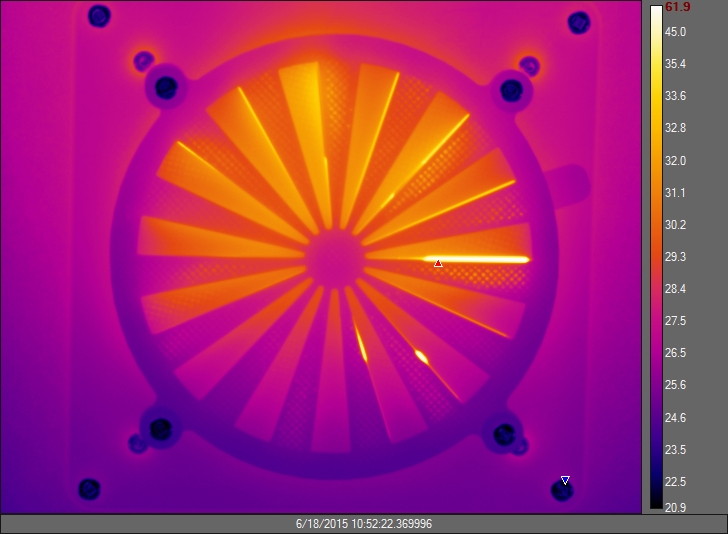

So I work in a lab at the university I attend, and was able to use our thermal camera to examine around this enclosure and see how well it does at containing the heat from a thermal standpoint. There are a few spots that will need to be addressed to help make this enclosure more efficient (upper back fan and lower back opening where the cables come out), but overall the high contrast of blue and white show that it’s containing that heat well. For those interested, I did take an old bike tube and cut out a piece of rubber and put it in between the top printed piece and wood. I cut a slit to allow the filament tube to move around. You can see from the top picture that it works well in keeping the heat in. I would suggest to anyone building this enclosure to do the same to trap the heat from escaping through the top. Very happy with this enclosure!

Pretty cool man, thanks for the free analysis of the current design :stuck_out_tongue:
I think it would be interesting to see how hot it could get with some modifications to some of the stock parts, I think if the box were fully closed, like completely closed, with out the ebox vent and some of the other holes and air gaps, it could probably get pretty hot, maybe push 50C…BUT keep in mind, the hotter you go, the harder it is on components, so I think the current heat capacity at around 40C is as high as one should be going without extra modifications for cooling components, it’s a nice balance of good hot printing environment while not being too hard on parts…
