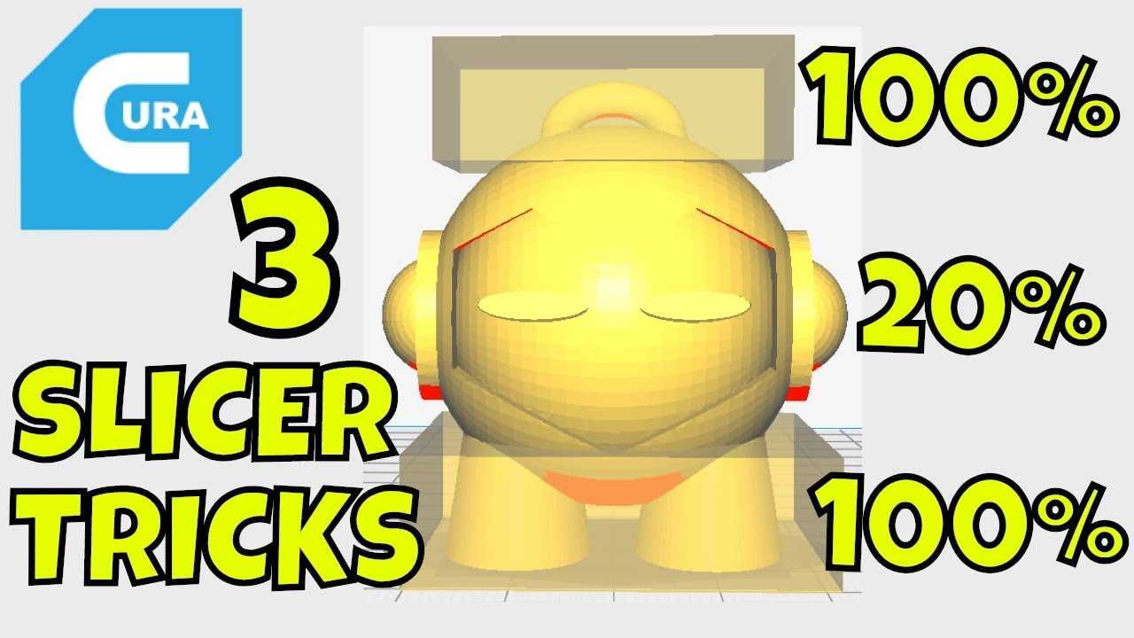

Can you provide links to the videos you found most useful, please?
Sure. Please see below:
