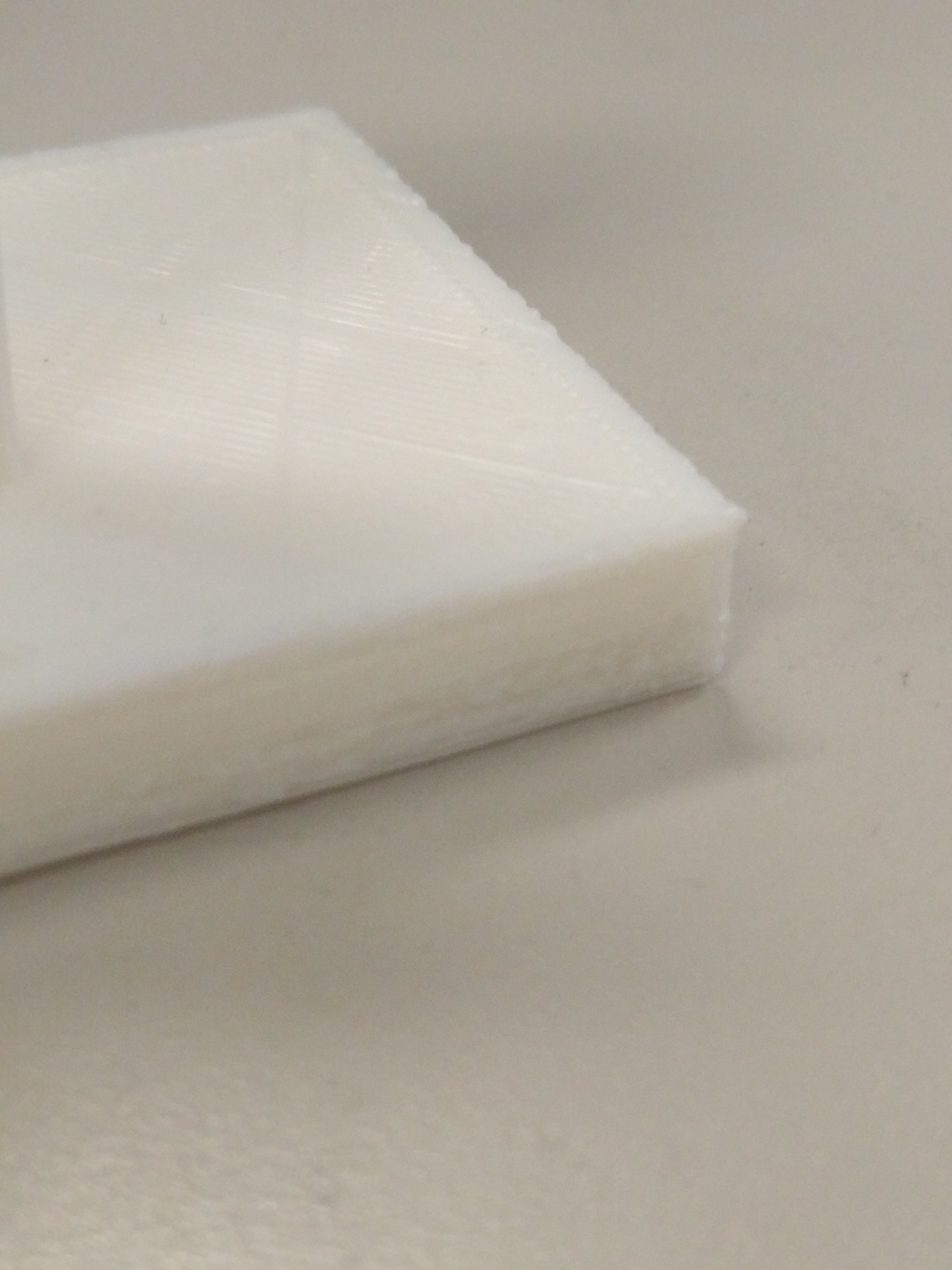

Let me ask you a question - I’ve noticed on my prints that on the layers where the infill is 100% - the bottom layers of a print mostly where it uses 100% infill 100% of the time for the first few layers - that it almost seems as if it is “blobbed” on the sides of square structures. It is only on the first few layers - almost like there is too much infill and it pushes the perimeters out a little bit. On the rest of my prints I have infill at 20% and I don’t see this issue. I thought that it was an overlap issue. Is this the problem you are trying to address? I was thinking it was a Cura slicing issue and I’ve been playing with the overlap parameter without success. It’s been driving me nuts.
If this happens only with my release from yesterday, it’s verly likely the problem I fixed now!
I should have been more clear - I have seen that problem on the stock Marlin firmware. I haven’t had the chance to try out your version yet. Specifically, it was the version provided by Lulzbot for Taz 5 (Marlin 1.0? With Lulzbot modifications?). I never thought about the problem being part of Marlin - I was stuck thinking it was the slicer.
Like this one on the left? A little bit overspilling the first perimeter line and squished?
That’s what’s healed with advance.
I don’t know if this shows it really well because it is a white print, but this is what I’m talking about. The lower right area near the bottom layers kind of “blobs” out. This is pretty consistent from what I saw. I thought it was an overlap issue.
Not the best picture, but I’m quite shure its not an advance pressure thing. I guess flow rate calibration together with precise Z-height measurement is what you want to heal this.
