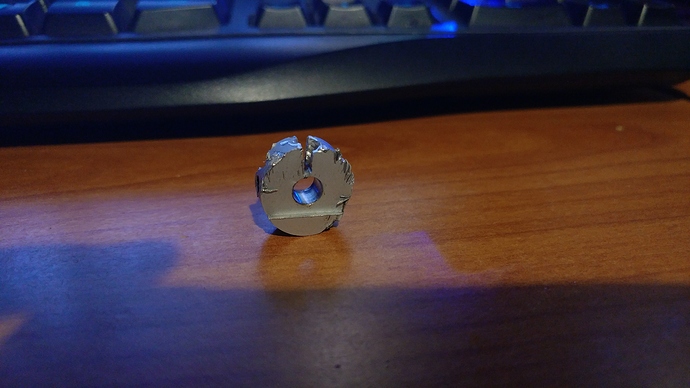

Project is on temporary/permanent hold. It looks like my left z axis stepper motor might have died. I would remove the motors to test and/or replace them but whatever Lulzbot did when they assembled my printer is preventing me from loosening the set screws on the flexible shaft couplings. I don’t think I can fix my printer in this condition and things are looking pretty bleak.
If I remember right it is Loctite so you can try heating it up some and it might soften enough to get them to turn. AKA: a hot soldering iron tip in the hole of the set screw.
If this is true, this sucks. I was able to get my hex driver in there and it seemed like it had grip but it slipped like they are stripped. I’ve got an email in to support so I’ll wait to hear from them before trying this. Thanks for the info.
I managed to get the Helical Flexible Shaft Couplings off the right lead screw, but not the motor. On the left side I managed to get the coupling off the motor, but not the lead screw. I’m going to try to bore out the stripped set screw to save the lead screw. I’ve got new couplings arriving Friday, motors arriving Thursday, and I’ll need to pick up some molex parts locally. I should be able to start on this project again newt week.
They are VERY hard screws! You may break a bit or two drilling them. I have! :blush:
Thanks for letting me know. I tried two different heads to bore it out and then a drill bit, but gave up early thanks to your warning. I ended up removing as much of the body as I could and then just carefully took a cutting wheel to it until I got enough gone that it just came off.
