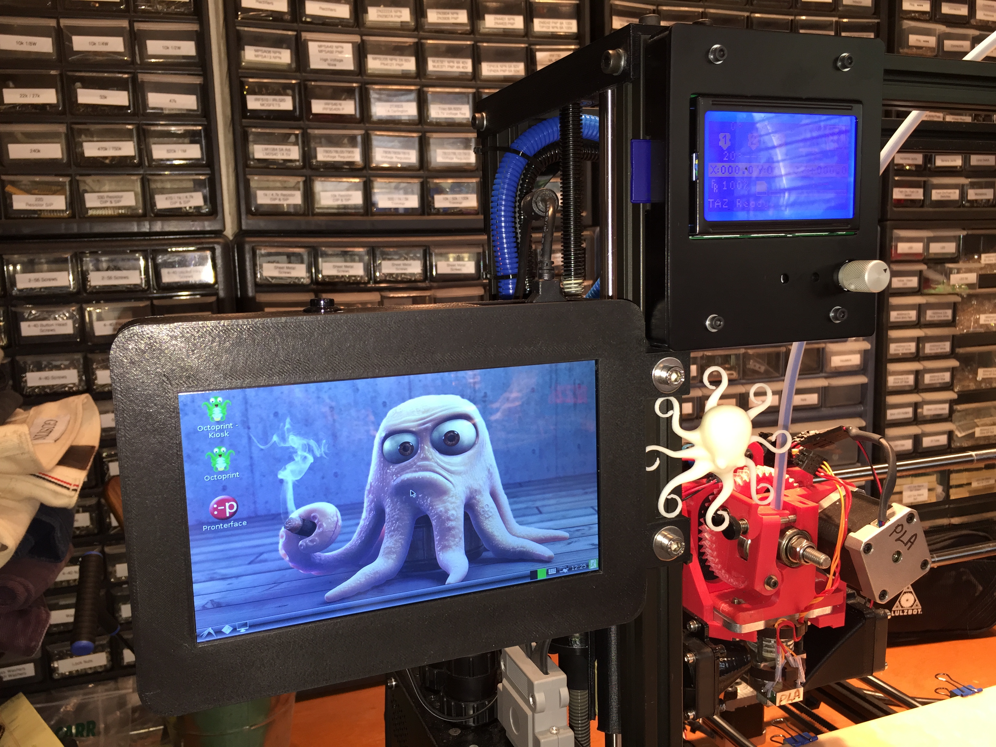

The Mini Prototypes are what prompted me to do this:
I’ve got a PCDuino and a Capacitive touchscreen that I want to try because I’m not real happy with the resistive 4dSystems LCD’s.
I basically only use it for Bed Leveling since I print everything from the SD Card, but it was fun to make and get a version of Debian working for the BeagleBone that ran reliably.
Kenny
That looks really cool, I like the octopus. :wink:
Care to share the BoM and Files for the Screen and housing? I’ve looked into doing this with my Taz 5 and even printed the enclosure, but the screen resolution ended up being to low.
