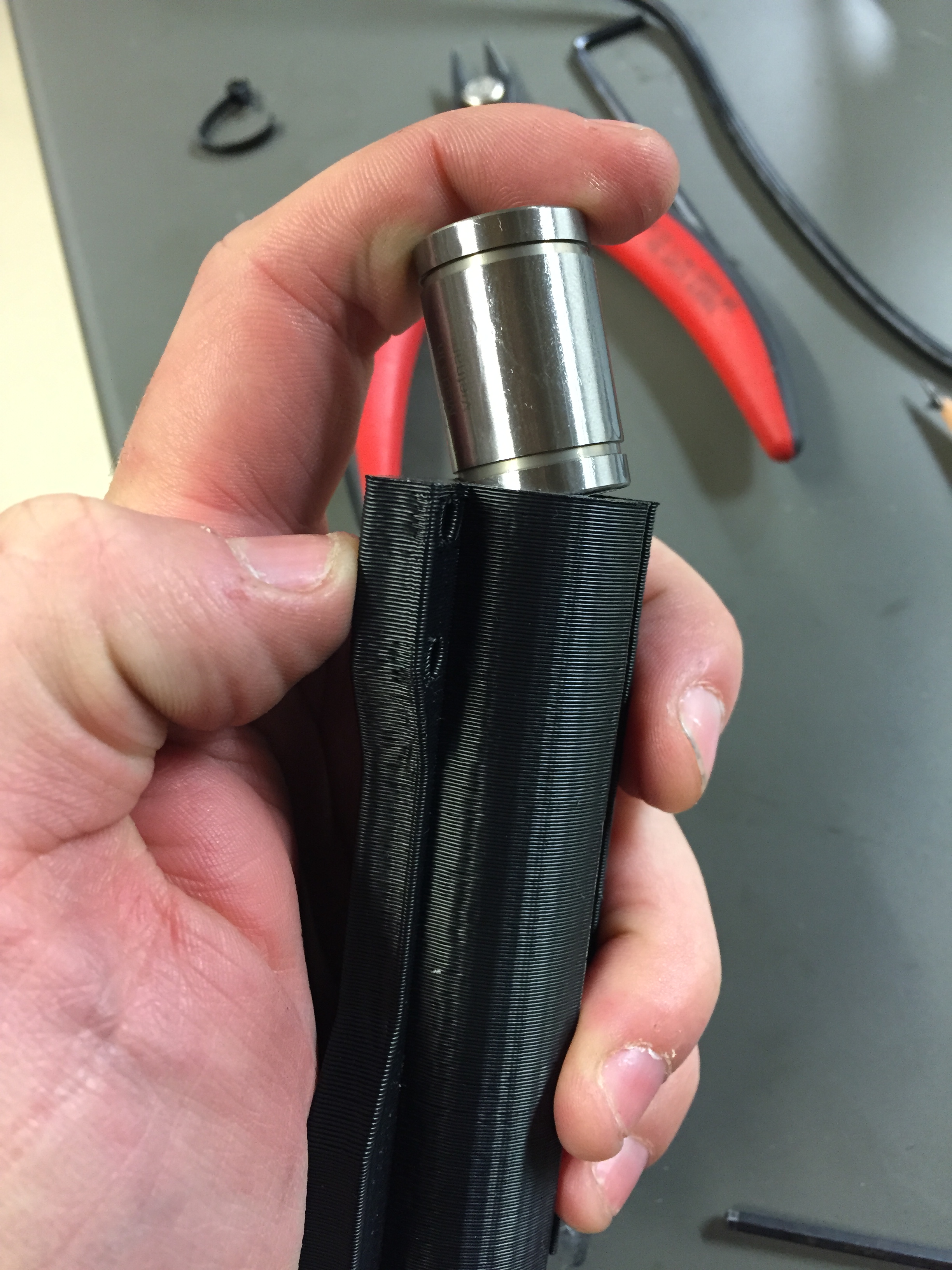

Installation was pretty easy and straight forward. The hardest part for me was popping the old bearings out. I did’t have a press. The amount of flex the bearing holders can take is surprising–I thought for sure that I was going to snap at least one of them. I used a lineman pliers to push the bearing out to where it was flush with the bearing holder.
From there I could easily push them the rest of the way out by hand using the new bearing.

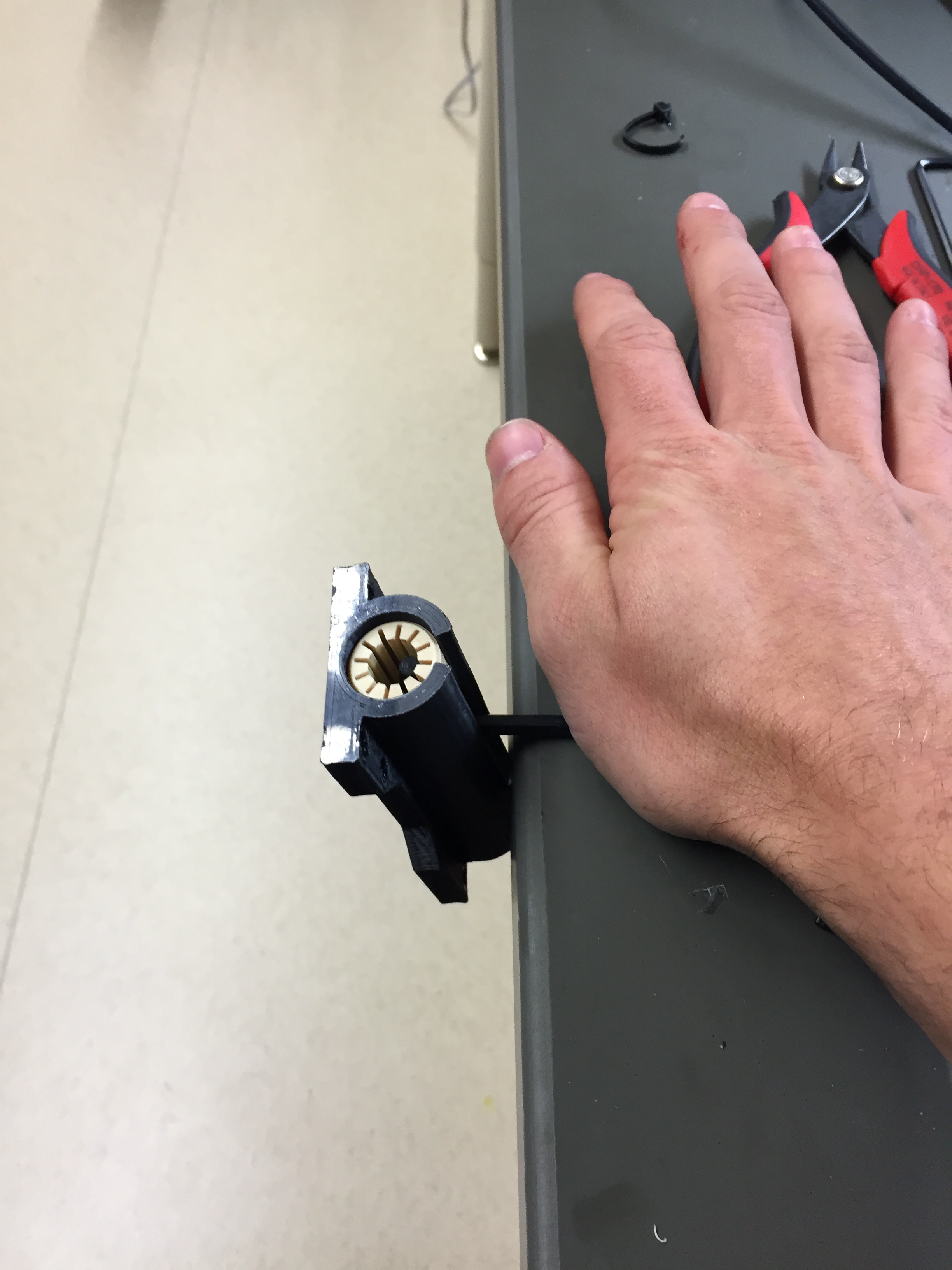

For the double bearing holder I hooked the 4mm allen key into the old bushing and then held the allen key on the table with one hand and, with the bearing holder hanging off the end of the table just pulled down on it till it slid off the bushing. To instal the new bearings I would start the bearing in on a slight angle to get it in on the side opposite the expansion slot.Then I could just put my fingers into the slot and make a fist to pry the slot open enough so the entire face of the bearing could slip into the holder. Then I could just push the bearing the rest of the way in with my hands. (see pics at bottom)
The 4 tools I needed to do the swap are 1.5mm for the set screws, 2.5mm for all the bolts, 4mm to pop the top X-rail bushings, and something to push on the other bearings–lineman pliers.

Putting the bed back together can be a bit tricky. This is what worked for me–just be patient and try a few different techniques before you get frustrated and just strip out the brass thread inserts. Put in all bolts on one side. Then get your hand–any small strong hand–or pliers on the wings of a bushing holder. Try and squeeze it as hard as you can and the bolt holes should line up with the holes in the bed plate. Before you tighten anything down move the plate back and fourth on the rails a few times to make sure that there is no binding. Tighten screws until they make solid contact. Move the bed back and fourth all the way to get the bearing to line up then slowly give them 1/6th of a turn to fully torque them down. Sorry I don’t have any pictures of this part, I was using both hands the whole time.
It is almost incomparable as to how much better it is at printing. Unlike erv I replaced all 4 of the Y-axis bushings, I wasn’t getting any binding issues so I went with it. Initially the Y-axis bearings made some tic-tac sounds as they were probably not super lubed up. I did not add any lube to any of them yet as the shafts came fairly coated already. After a few prints the bearings have become completely silent. I cannot stress how worth it this upgrade was. Total time was 1&1/2 hours, and I spent a bunch of time trying to take photos. There is no backlash in the X&Y directions due to bearings anymore. I upped the Accel to 1000 and could probably get it much higher–1500+. Does anyone know if there is an accel limit for any of the plastics in regards to printing ability or is max accel set by machine physics?
