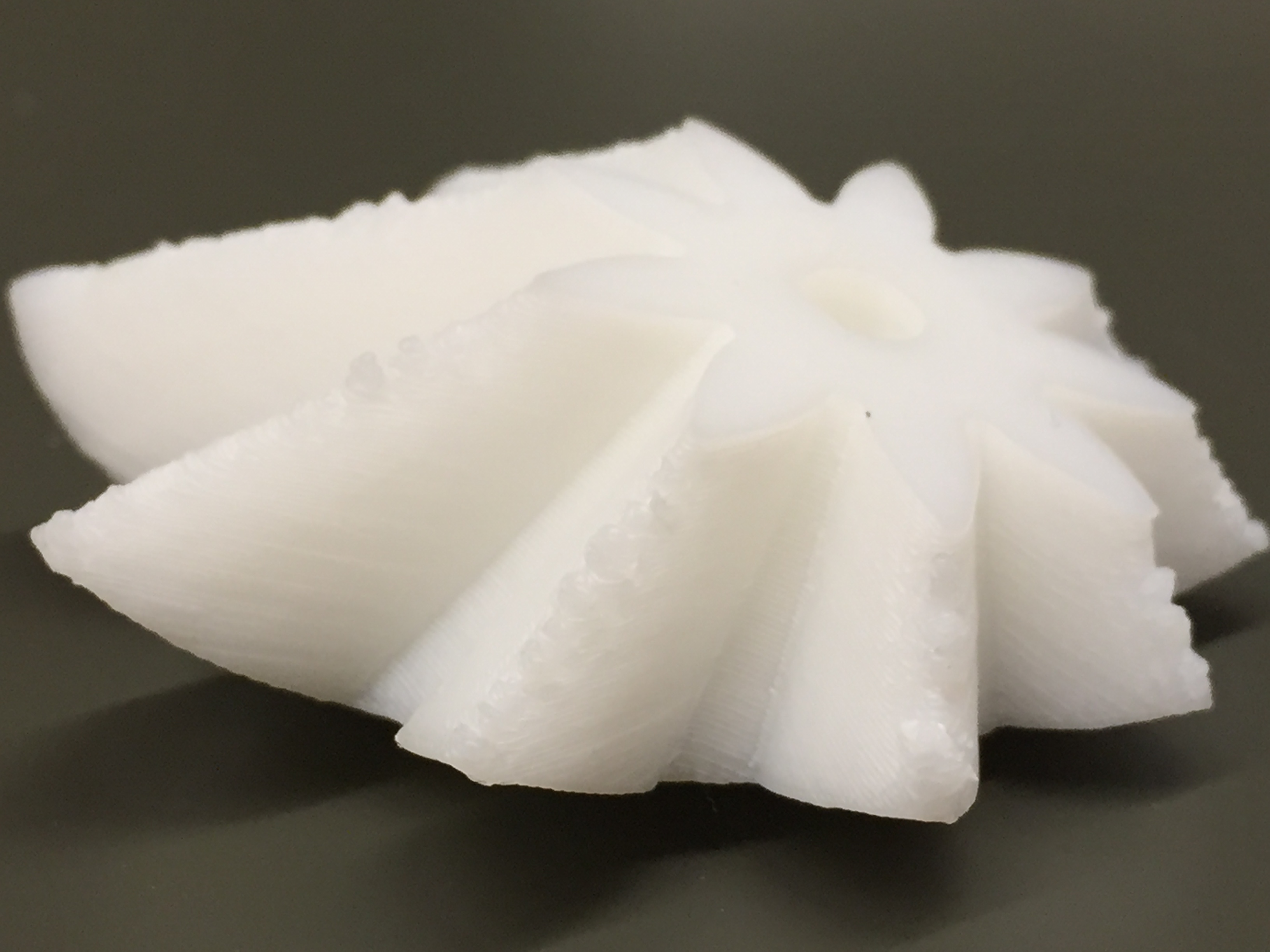

Here is the difference in prints from when I started to now, printing with the same ABS and the same slicer settings.
The bushing replacement really helped speed up printing and the fangtooth took speed and quality to a new level.
