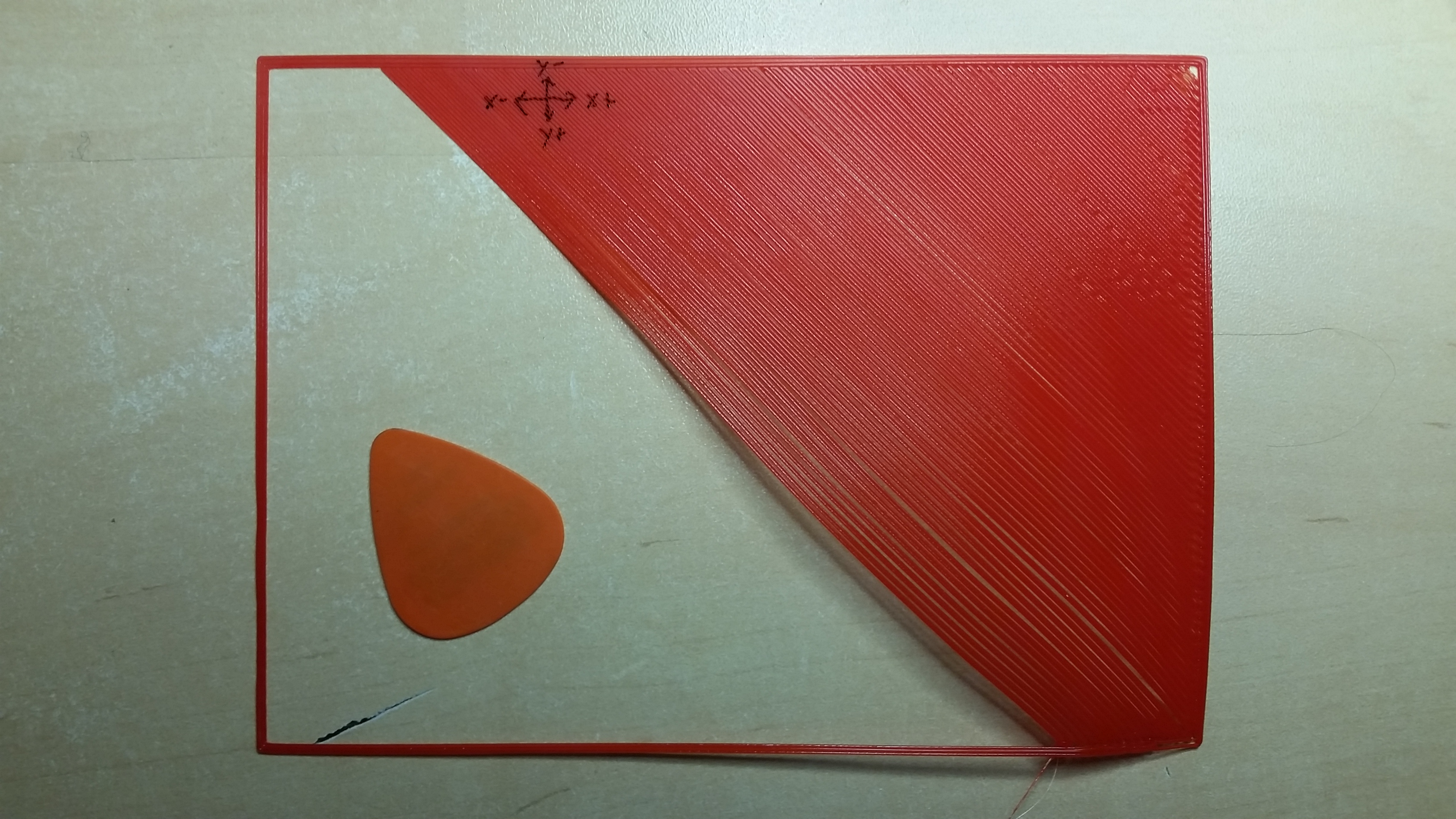

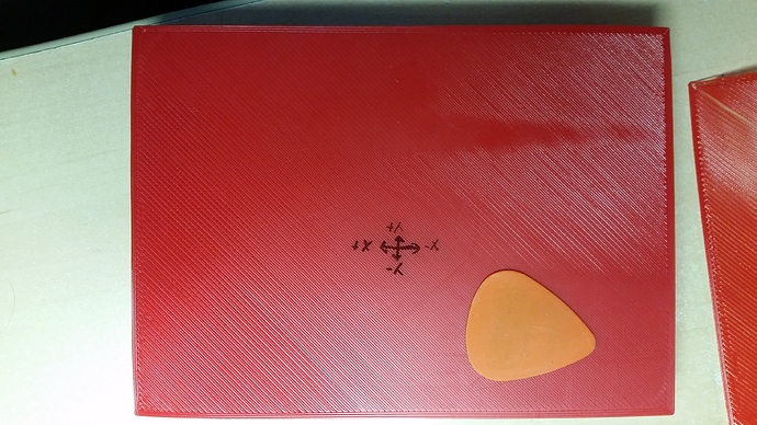

I do however, seem to have some strange first layer problems. Namely, even though autocalibration succeeds, I see some areas of the bed with great adhesion and others with less great. See photo for an example of this with a really large flat part. I’ve pretty much seen this on all parts to varying degrees, both with PLA and PETg, both using the stock Cura profiles for them. It was never an issue until now, where I’m printing really large base parts and the lack of adhesion is causing curling with PETg.

  • Uneven first layer width (see photo). To the point that some strands are squished really heavily, while others are not touching their neighbors.
  • Curling of really just one specific corner.
  • Zprobe offset is set to -1.55 mm, which seems like it should be outside of spec. If I move closer to the stock -1.35 mm then nearly none of the strands connect. In fact, at -1.50 mm this starts to happen (see photo of partial print).

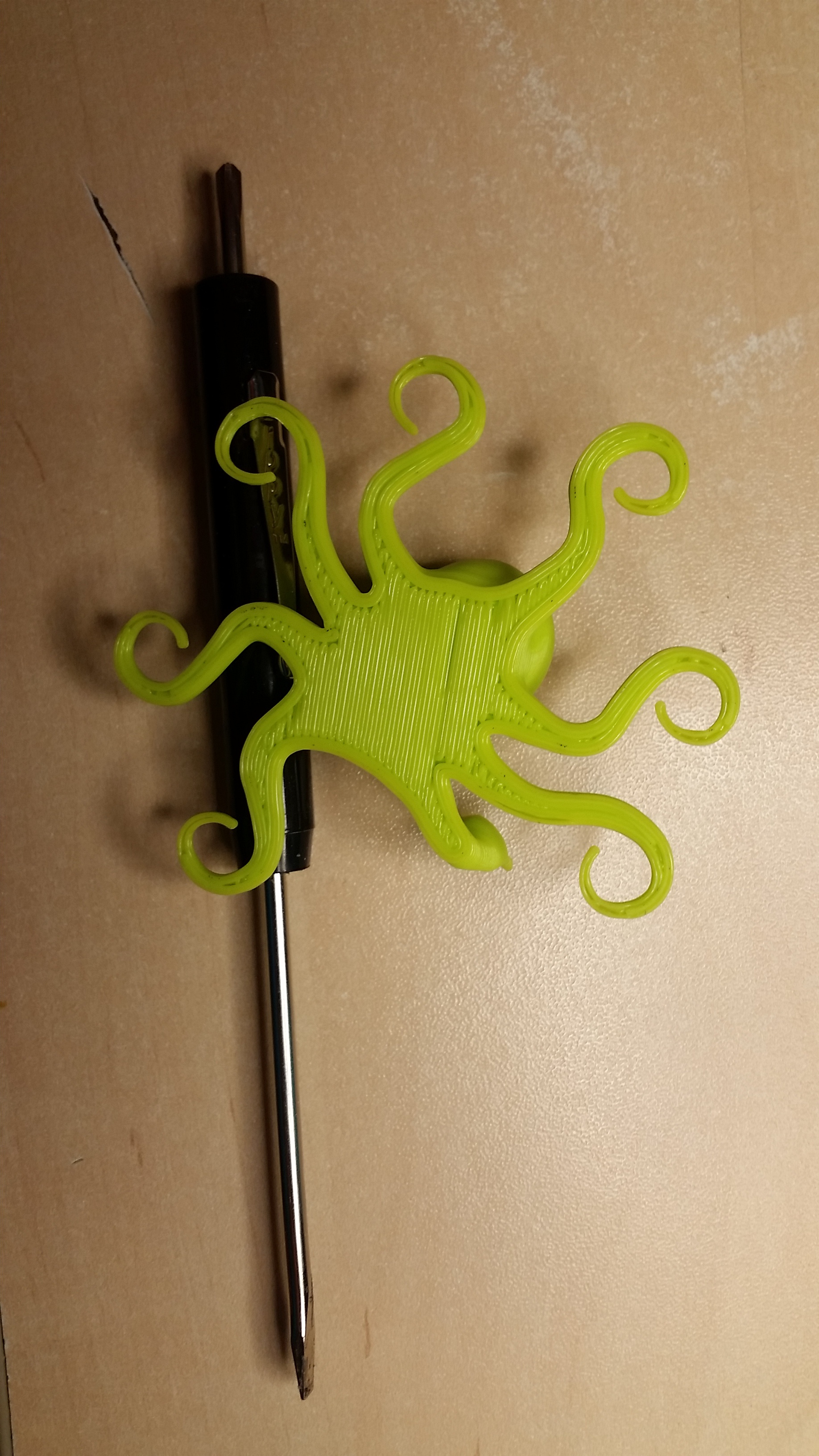

  • Even when using some bits of PLA, I had similar first layer issues (see rocktopus photo).

  • The rest of the layers are fine. The top layer finish on this thing is the best I’ve ever seen from a 3D printer. It has a slight ripple so may a little overextrusion, but definitely not under.
