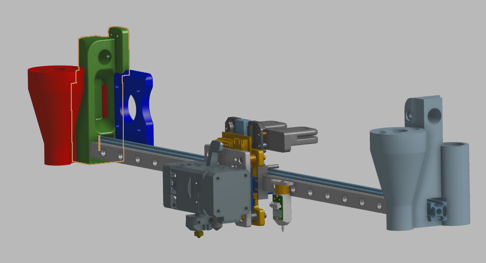

The quick toolhead change in the stock firmware is just a custom menu with gcode commands to set default PID settings, nozzle x/y offsets, esteps and motor current. It’s easy to replicate - I’ve done it on my “Taz 6” that’s running on an Octopus 1.1 board. To make toolhead changes even easier, I’m finalizing my linear rail replacement that holds the Hermit Crab quick change plates. I’m waiting on a replacement board for my little Voron so in case I need to print anything during the change I’m not having to backtrack and rebuild the Taz just to make an adapter piece if needed.
I do need to figure out a good mounting system for the ABL also.
The reason I bring up the Hermit Crab, is that it includes a wire set for the toolhead that eliminates a significant amount of the required wire extensions when swapping to a SKR or Octopus board in the Taz 6, combined with the one-handed toolchange, it’s well worth the $80 (when on sale) cost of the 3-toolplate kit. And since it bolts up to a linear rail so easily, I figured, might as well do that too.
