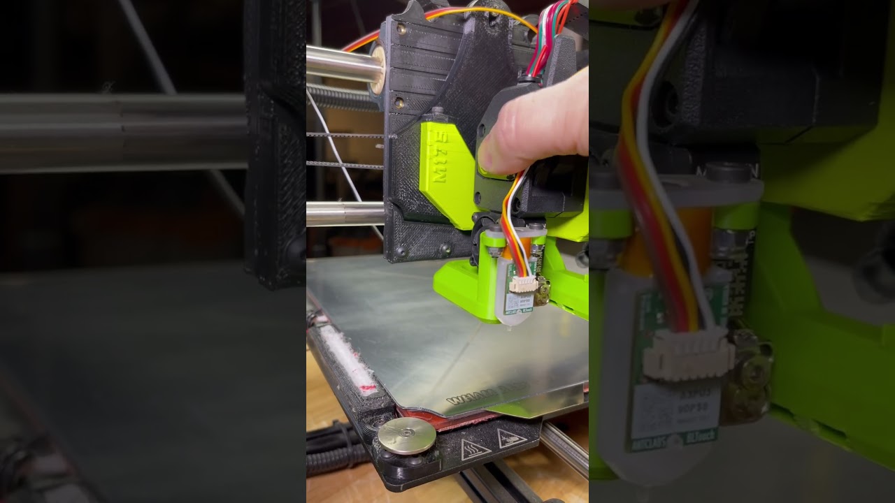

M175 on the Taz 6
Came out pretty good. Probably should have done 0.1 mm layer height for the text. But 0.2 did good.

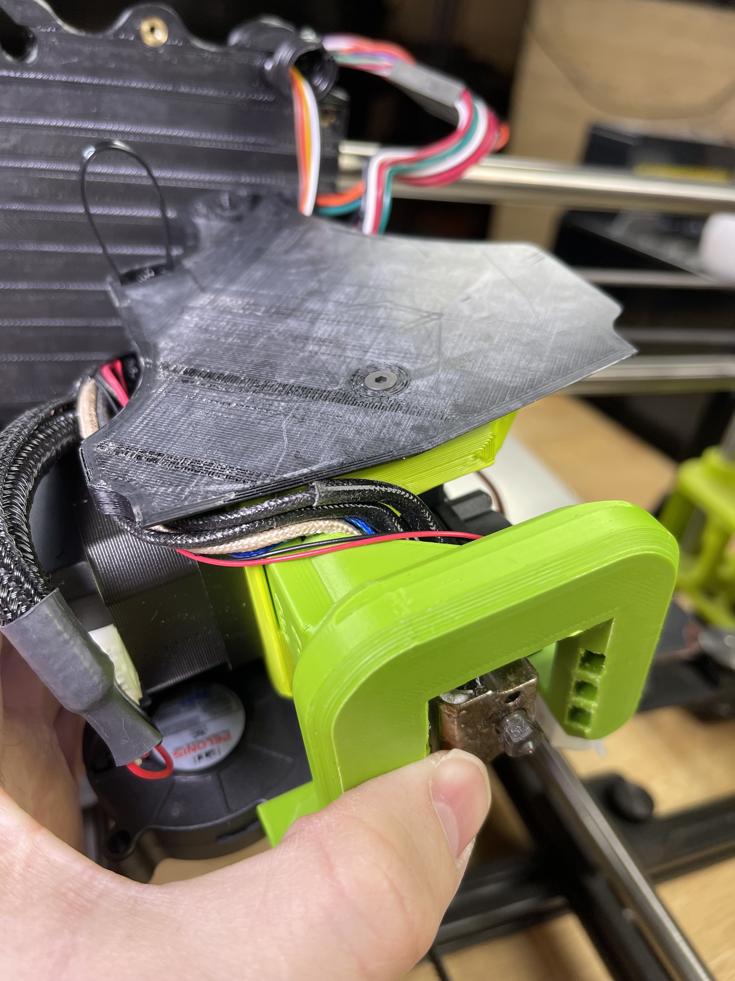

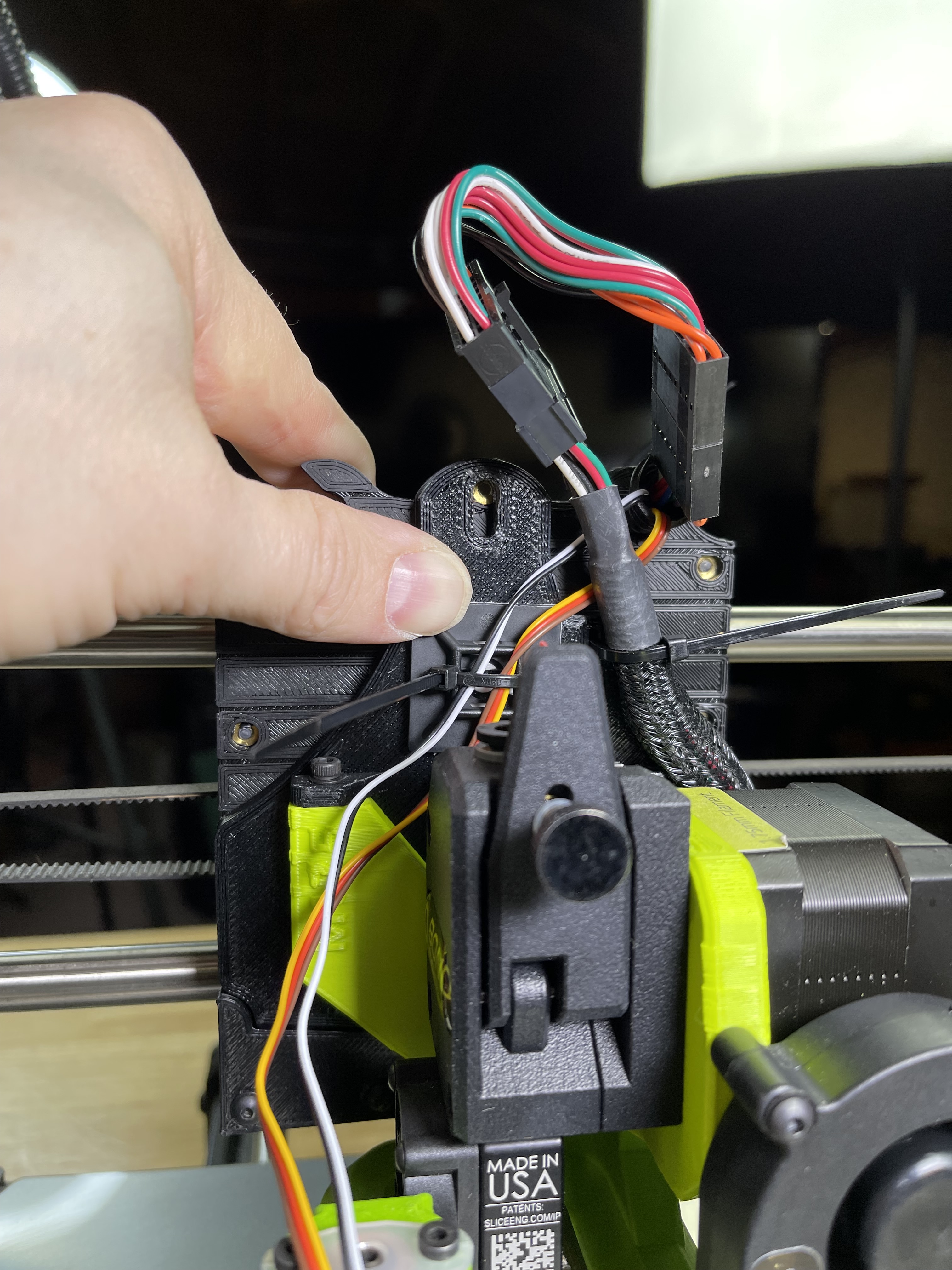

How do you route the BL wires on the tool head?
Also, I hate how loose the bottom is of this universal mount.
M175 Universal tool head
So the wiring of the M175 is interesting
I feel like this bundle of wires is preventing the tool head from attaching well
I’ve moved the wires around and when i seat the M175 into the gantry lip, I can fit in flush pretty well.
But, when I look at the top part of the Universal mount, it is off to the left of the mounting screw hole. So, if I just place it in there and tighten the screw, it is actually lifting the M175 out of the lip.
That said, that might explain my z offset being so challenging with this thing bouncing around in the mount.

Do I unplug this connector?
I have the black / white in there. Should I use hot glue to keep it there? It seems to be staying in place.
I just ran the BLTouch wires on the side, looks about like your final picture showing them.
Yep, the old harness gets removed from the extension pins.
The black/white never had an issue coming out, but a touch of glue wouldn’t hurt.

I’m kind of surprised they haven’t improved this method of connection over the years. When I searched about the tool head wobble, the amount of hits I got was - well - wow.
Your issues are caused by the adapter being poorly modeled by Lulzbot. You have to shim the top two mounting points with two m3 washers each for the tool head to actually sit flat on the adapter. Warning, this will be exceptionally fiddly to accomplish.
If you attach the top two bolts first and then do the bottom one, it will appear that something is preventing the last bolt from tightening all the way - like a wire or something. Tightening all three without the shims will actually buckle and bend the whole assembly.
Thinking this was an issue with the printed part being printed poorly, I reprinted it myself (in addtion to reprinting every other part). SAME ISSUE.
Oh how absolutely frustrating that is.
On one hand, I’m glad it’s a simple fix adding two washers there.
On the other, I’m a little annoyed that issue exists. Did QC not test a Universal Mount with a M175 and see the same wobble/seating issue?
