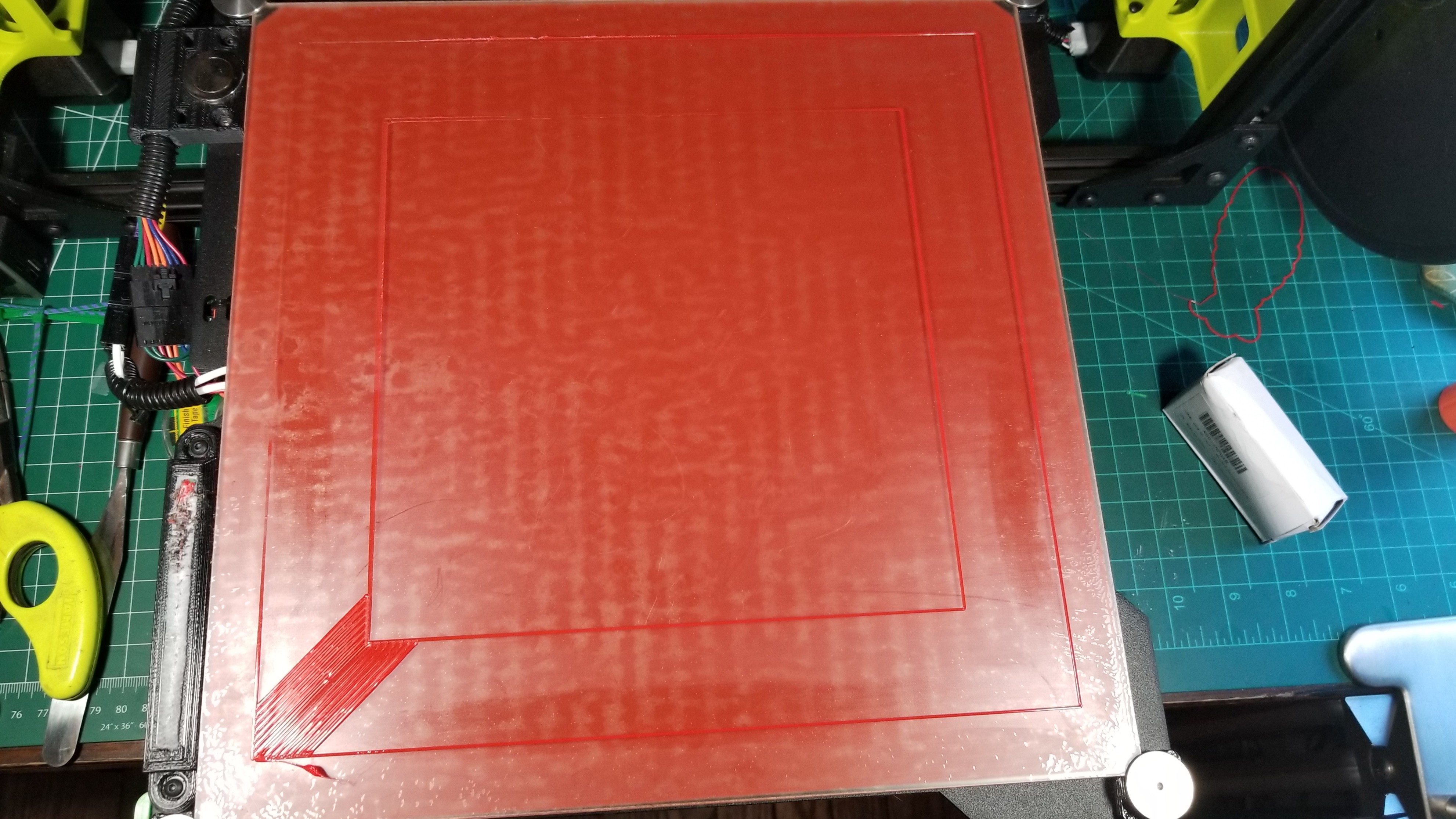

I can’t get a consistent skirt line around the perimeter of hot bed or print a small model in the rear left section of hot bed in new firmare only.
If I try to print a big model or position a small model in the rear left or right of print bed. My layer lines are almost flat in that section of the hot bed or indeed the nozzle hits the hot bed.
At first I thought it was my zoffset being wrong. When I brought this up before, Marcio suggested loading failsafes 1st. This indeed fixed my issue. but i think only because I also moved the model in slicer to front of hot bed. So the problem never was my zoffset. It was that I moved model location in slicer, and front section of hot bed prints ok new firmware.
In old firmare I can print whole hot bed a consistent skirt line around the print bed.
In new firmware I get issues with skirt line or models printed in rear left (same corner that is now skipped in bed leveling)

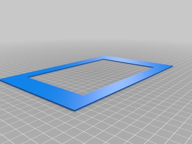

Bed Perimeter Rectangle For Leveling and Calibrating your printer
scaled to
x 1.2 = 264mm
y 1.85 = 259mm
old firmware
new firmware 1.1.5.8
In both case I did the following:
End of Start code
G1 Z2 E10 F75;
G92 E0;
M117 TAZ Printing...
I extruded extra filament at start print because couldn’t do a skirt, testing perimeter.
Shouldnt there be a consistent filament width and height like old firmware.
Generated gcode from Cura 21.04, in attachments
Temp 205C
layer height 2.5
Polylite PLA
LevelingPerimeterRectangle.gcode (225 KB)

Only new firmware I have problems rear left.
Old firmware same gcode prints fine.
If my zoffset is wrong in new firmware I can adjust it up some. What I’m getting is an inconsistent error in the level around perimeter of bed on the rear left. If I had a bad zoffset for arguments sake, it should be consistently bad around whole perimeter, not just rear left?
In pics the bead is nice until is gets near the rear left corner but only new firmware, not the old firmware.

What I suspect is happening is that bed leveling is not perfect, but generally the offset is small enough that the difference is not enough to see with the naked eye. The one instance in which it becomes visible is when the Z-offset is low enough that the nozzle drags on the bed. At that point, the nozzle catches momentarily and then releases and you get the telltale dot dot dot pattern as the flow of plastic is cut off and released.
We have determined that under the new Marlin the Z-offsets need to be different. On the older FW, a Z-offset of -1.500 was appropriate, but on the new FW the value needs to be around -1.200 for the TAZ (we will change the defaults soon).
I suspect you are using the defaults of -1.500 on the new FW, which is too low, so this makes any imprecision in bed leveling apparent. If you were to try the old firmware, but lowered your Z-offsets sufficiently so that the nozzle caught in the same manner, I suspect you would also see imperfections in leveling.

No, -2.00 is too low. I think you want to go higher, perhaps -1.200 or even -1.100 (note that the numbers are negative).
I just did the bed leveling you provided on Marlin 1.0.2.22 and Marlin 1.1.5.11. I used a Z-offset of -1.200 and the print was overly squished on both. Both FW versions showed differences between the best corner and the worst corner; in fact, the difference was more pronounced on the print from Marlin 1.0.2.22.
Overall, I think the conclusion is that bed calibration is not perfect. You need to adjust the Z-offset high enough so that the nozzle is far enough from the bed so that the leveling inaccuracy does not cause the head to drag. I suspect you have it set too low.
