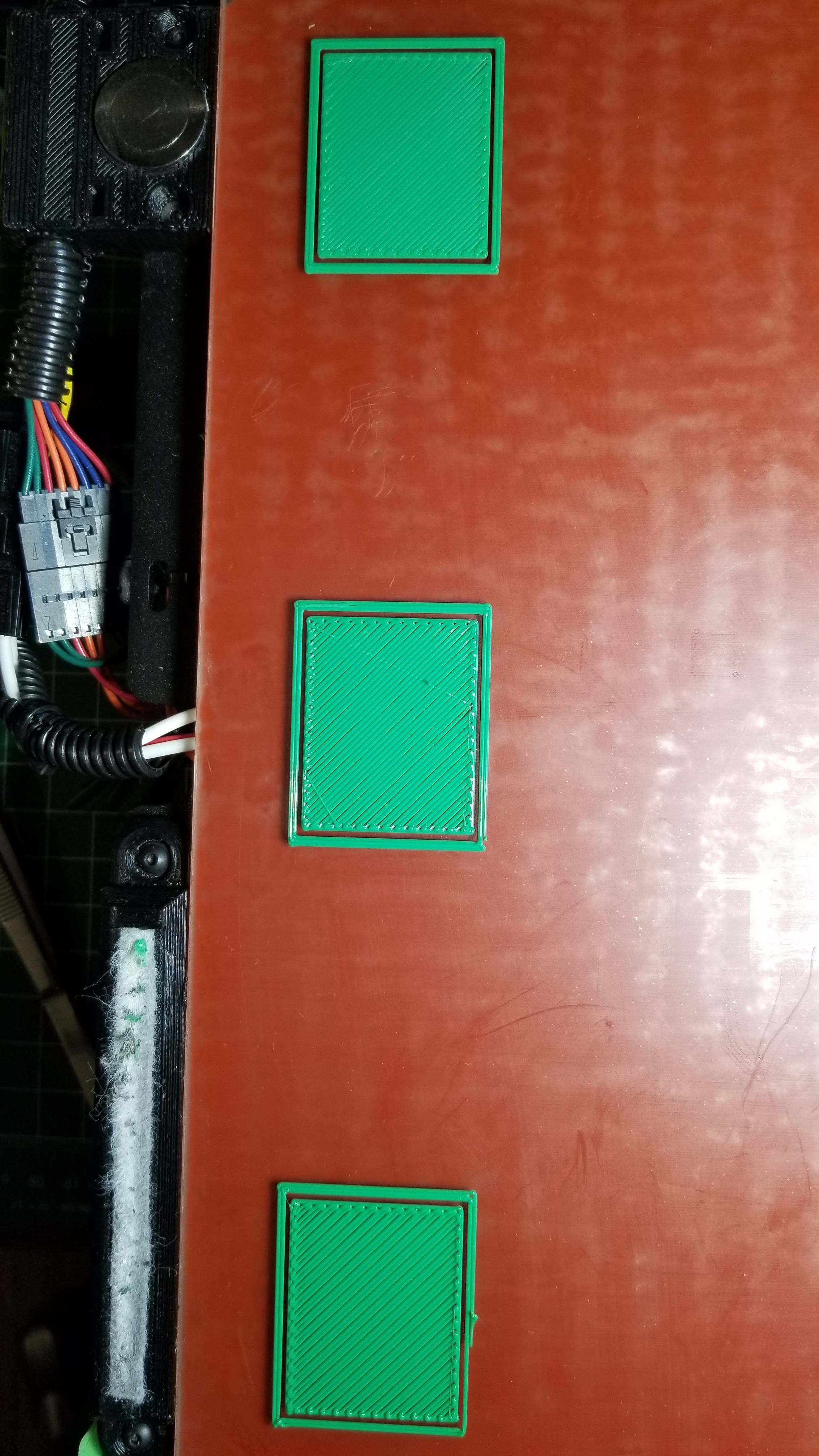

Z Offset: -0.311
All photos are bottom(front of bed), middle, top(rear of bed)
Left
Middle
Right

This looks the best so far in my opinion. However this gcode was generated in Cura 21.04. Where a higher zoffset is made possible by both initial layer height (.450) and initial line width (170%) in combination. In newer beta Cura only initial layer height is available, so I was loosing bed adhesion on 1st layer. Had to go to a lower z height offset to compensate… which seems to expose failures in bed leveling accuracy, in either firmware. I still feel older firmware looks better.

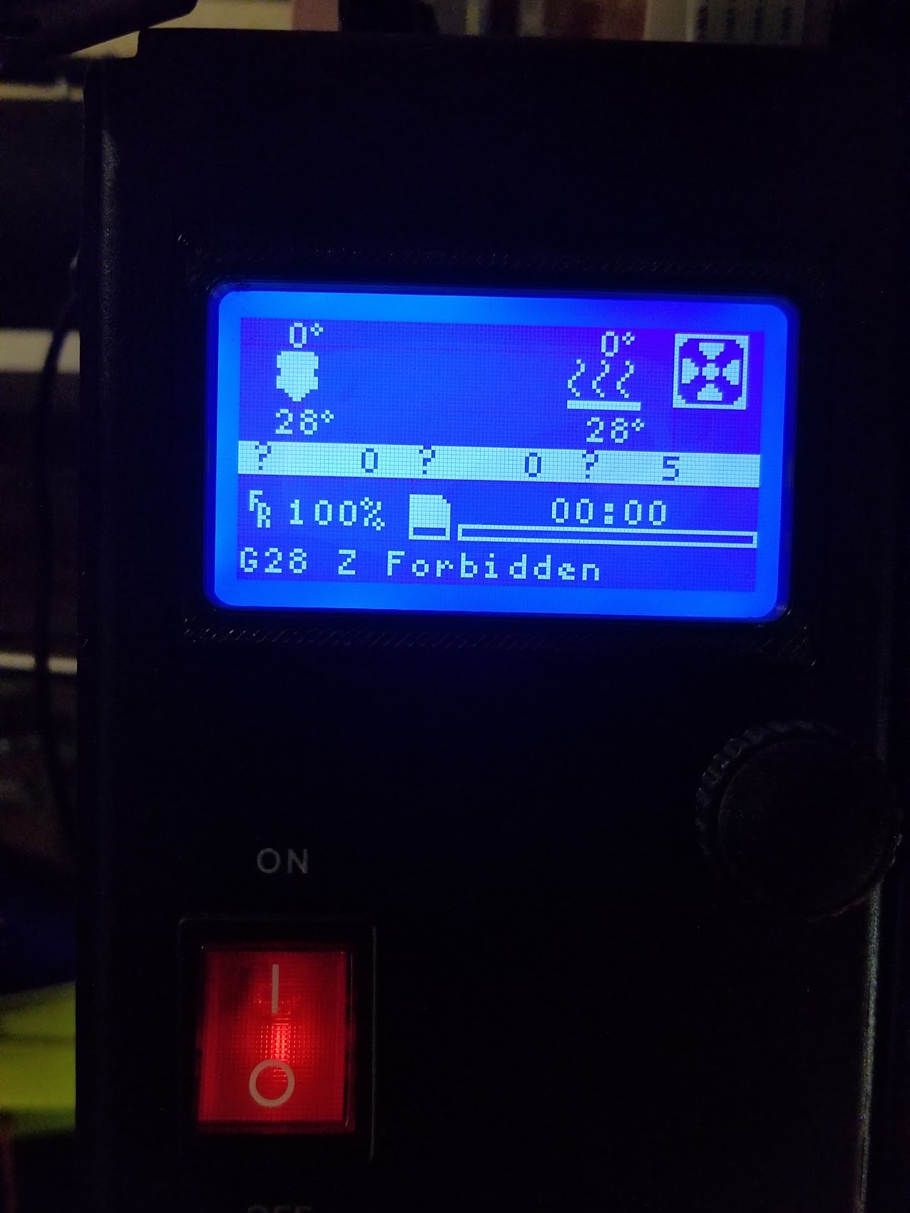

Found the error I saw last night.
Flashed new firmware.
Adjusted z offset
changed esteps
saved
Connected usb back to Octoprint.
Hit Home Z in Octoprint
Got - G28 Z Forbibben
Seems you have to hit home X/Y first, then home Z.
Then I was able to print. Guess its not safe to home z unless its over the sensor, my fault…good safety feature.
The '?'s indicate firmware doesn’t know absolute hotend location?

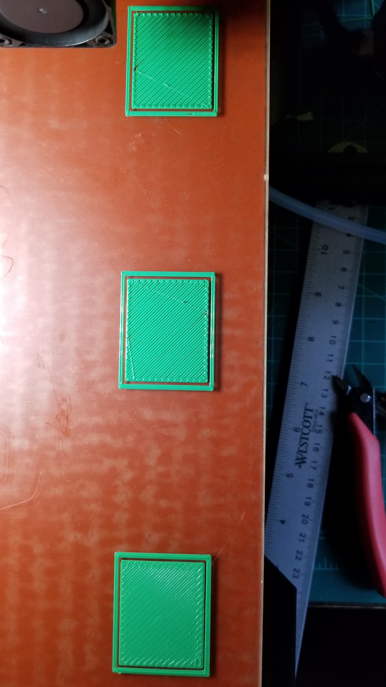

Firmware 1.1.5.12
Zoffset: -0.061
Left
Middle
Right
In an effort to find a zoffset that worked for the rear left, I’m now throwing the front zoffset too far from the nozzle. The filament actually has a chance to spiral b4 it hits the print bed (front left). And rear left is still not acceptable. Less squished but not ideal. Seems like its one or the other with this firmware or go back to old firmware. I can’t find a happy medium. Adjusting for rear throws off front level. -0.061 is an extreme offset for the front. What’s puzzling is the hardware is the same, only firmware is changing.
I’m not a software engineer but seems like the bed leveling algorithm or calculation is off. The 3 point calculation may describe a plane but perhaps there is an error in the math?

Ah. I had never seen this error before, but yes, it a safety precaution. If Z homes first, the nozzle would potentially miss the button and damage something.

A couple things, first, try out Firmware 1.1.5.15. It turns out that the PWM frequency for the cooling fan was too high and there is a possibility that the fan was not running properly. I also spend a bunch of time scoping the various other PWM fan and heat controls and tuning them so they were being driven at exactly as the same frequency as earlier FWs. I’m not saying it will fix the problem, but since cooling affects print quality quite a bit, I recommend retesting with 1.1.5.15 and seeing if it changes your results.
If you still believe leveling is at fault, you can re-enable four-point leveling by editing “Marlin/Conditional_LulzBot.h” and change the lines:
// Select type of leveling to use:
//#define LULZBOT_AUTO_BED_LEVELING_BILINEAR
#define LULZBOT_AUTO_BED_LEVELING_3POINT
To:
//#define LULZBOT_AUTO_BED_LEVELING_3POINT
That said, I printed several test prints using the new firmware and I personally did not see a difference. YMMV.

Just this once, I’ve attached two firmware files for you to compare…
Marlin_Mini_SingleExtruder_Three_Point_Leveling_1.1.5.15_324c87767.hex.txt (211 KB)
Marlin_Mini_SingleExtruder_1.1.5.15_four_point_leveling_324c87767.hex.txt (217 KB)
For the TAZ 6…
Marlin_TAZ6_SingleExtruder_three_point_leveling_1.1.5.15_324c87767.hex.txt (400 KB)
Marlin_TAZ6_SingleExtruder_1.1.5.15a_four_point_leveling_324c87767.hex.txt (407 KB)
You are the man…Thanks alot.
I have Taz6, firmware says MINI?
See above. I caught my mistake and reposted :slight_smile:
(Probes out of order, as mentioned ------ but works so who cares)
Im still adjusting to find a good z offset. But problem solved.
Even with this preliminary z offset (-1.100) which is too high. Started high just incase problems. All of the squares are same squish, even the rear left.

I remember it used to give you the deviation (which turns out was ok after all) of your build plate in the console after it probed the points. But this is now better leveled then old firmware. Impressive !
