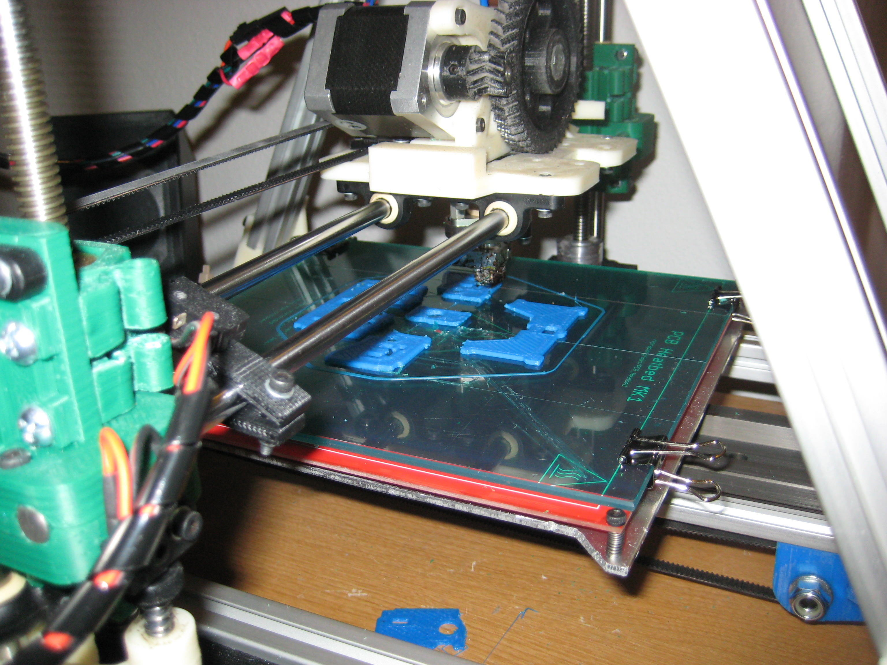

The rail is pretty much perfect as is lengthwise, it will rest on top of the existing lower structure. The advantage to this modification is less mass on the y Carriage (the standoffs and the lower assembly), less possibility of rod defliction theoretically resulting in better repeatability. The bearings seem to move faster than the origional igus style ones too, but that could just be because I have a used machine and these are new bearings.
The trickiest part is the modifications to make your heated bed plate. I followed the lulzbot diagram to make the side cuts to reduce mass. To attach the Y belt, you end up using zip ties and attaching the belt against it’s own teeth. I was skeptical at first, but it seems to hold. There is an alternative screw clamp variant of the belt attachment available, but it seemed fairly flimsy as is, so I ende dup using the one attached instead. I haven’t got everything into the machine yet, but once it’s in i’ll post more pictures.

Before:
New endstop. It sockets into the rail with a capture notch, then strikes the Y belt anchor to trigger
Motor mount installed. Also the new Power and data interconnect backplate. The power supply is not quite ready to go in the frame, I’m waiting on some of the connectors.
Blurry picture of the new arrangement. Basically the motor mount replaces one of the metal angle clips. Ads stiffness to the frame and rail (not that it needed it) and lets the belt length be decreased by 100mm or so, allowing for better geometry and tension.
After the modification
You can also see the mounting locations for the Power supply, some of the side and back plates in there. The deckplates will go on next when I open up the front of the printer and get them drilled.
