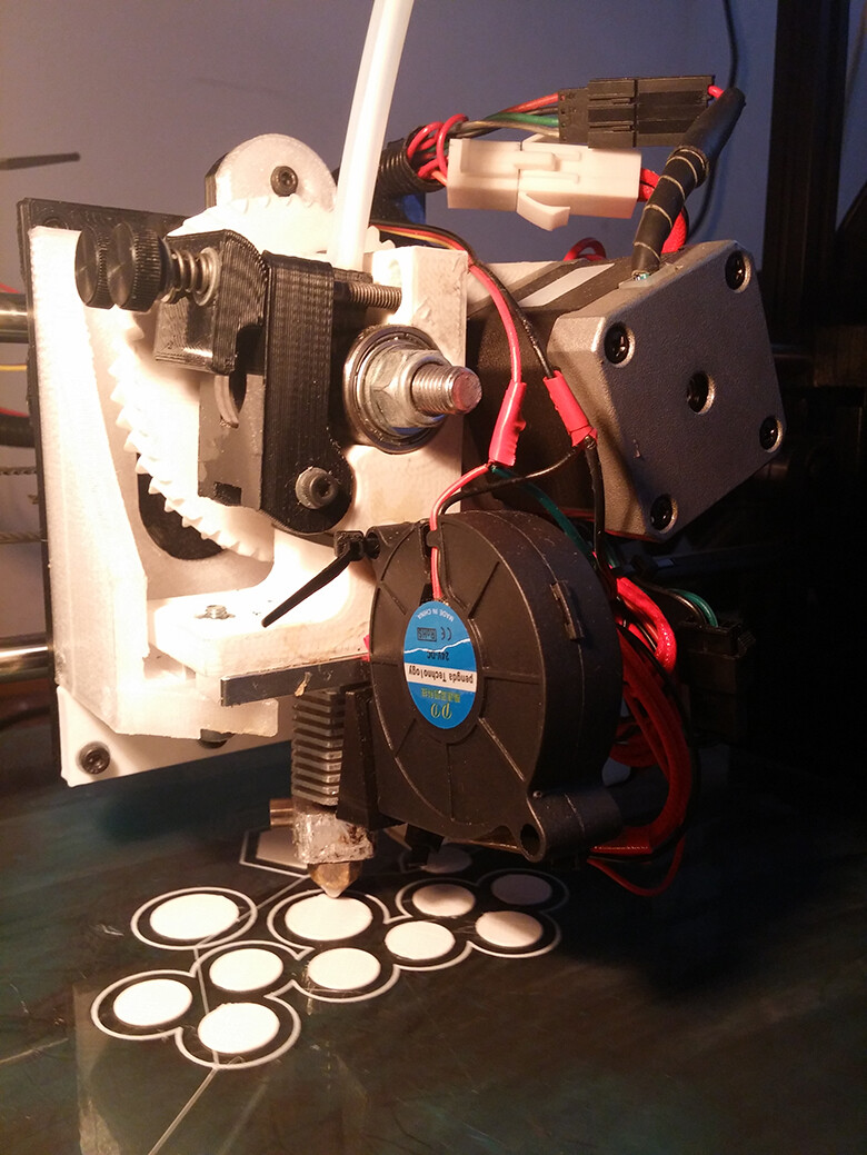

So… here is my setup, in the image below-
The issue I am battling with is that I have too much pressure from the melt chamber. Also I print all the filaments much cooler that it is said for the hexa. My PLA is printed in 180C (colorfabb)
I get too much ooze, that even the retraction 40speed 4mm length, cannot handle. Also get a lot of stringing during travel as well. (travel speed up to 200)
This fan I’ve put on the fins is cooling them I think well enough. During print, I touch the fins and they are cool.
If anyone has an opinion… Could the problem be that the stock hexa I am using has different and smaller heat block?
Or should I try to replace the thermistor and the heater cartridge for starters…
