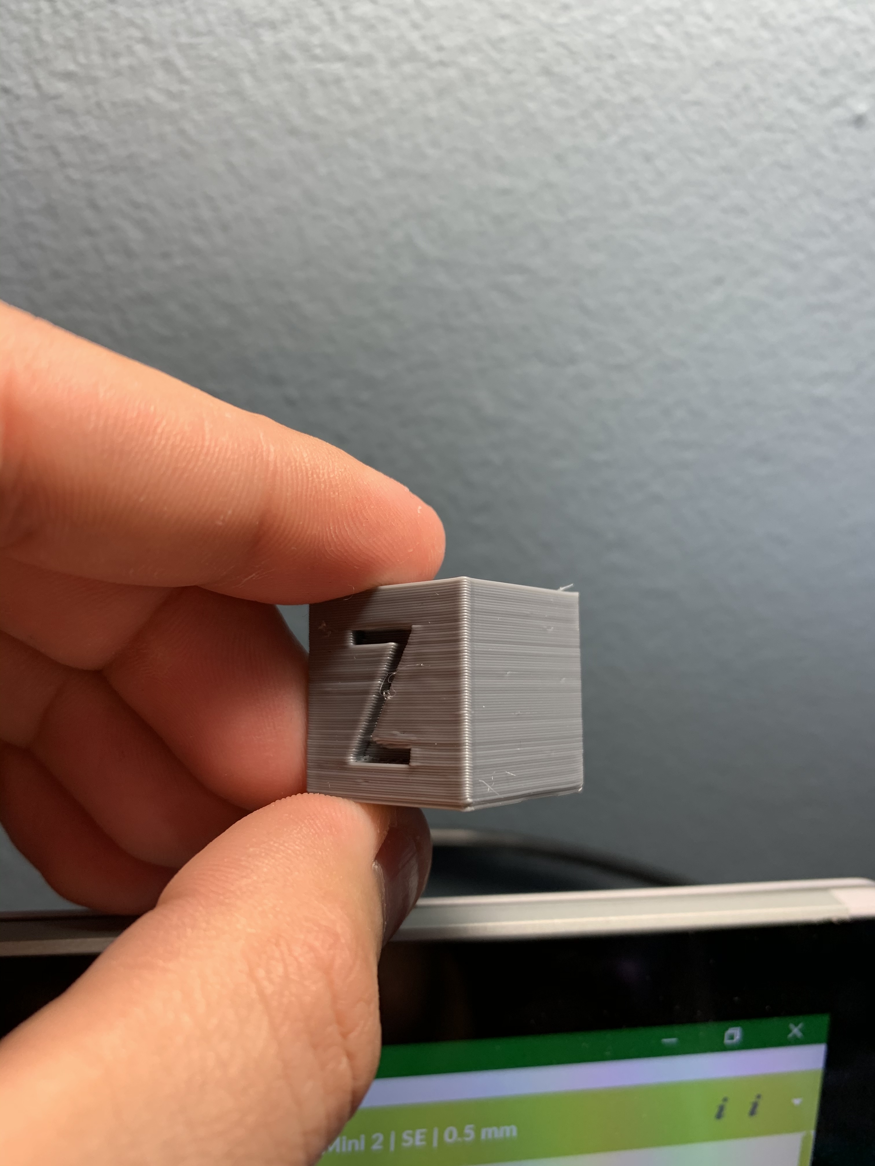

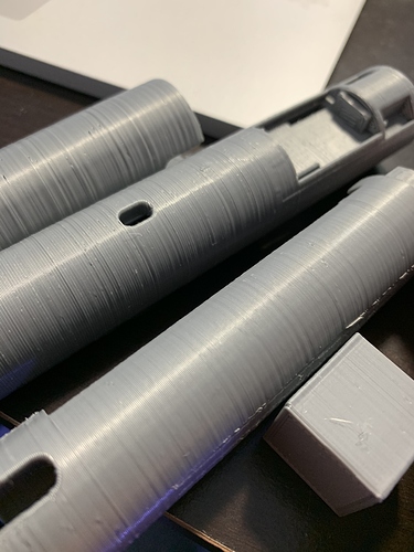

When I am able to print a good first layer and complete a print, I was getting terrible periodic ringing up the. It did slightly improve with calibration of XYZ steps using 20mm cubes. But it still leaves ringing all the way up.
The far left cylindrical piece was the initial results and it progresses right as I made adjustments. The cube is the best piece I’ve gotten to print but it still has what I consider to be pretty bad ringing.

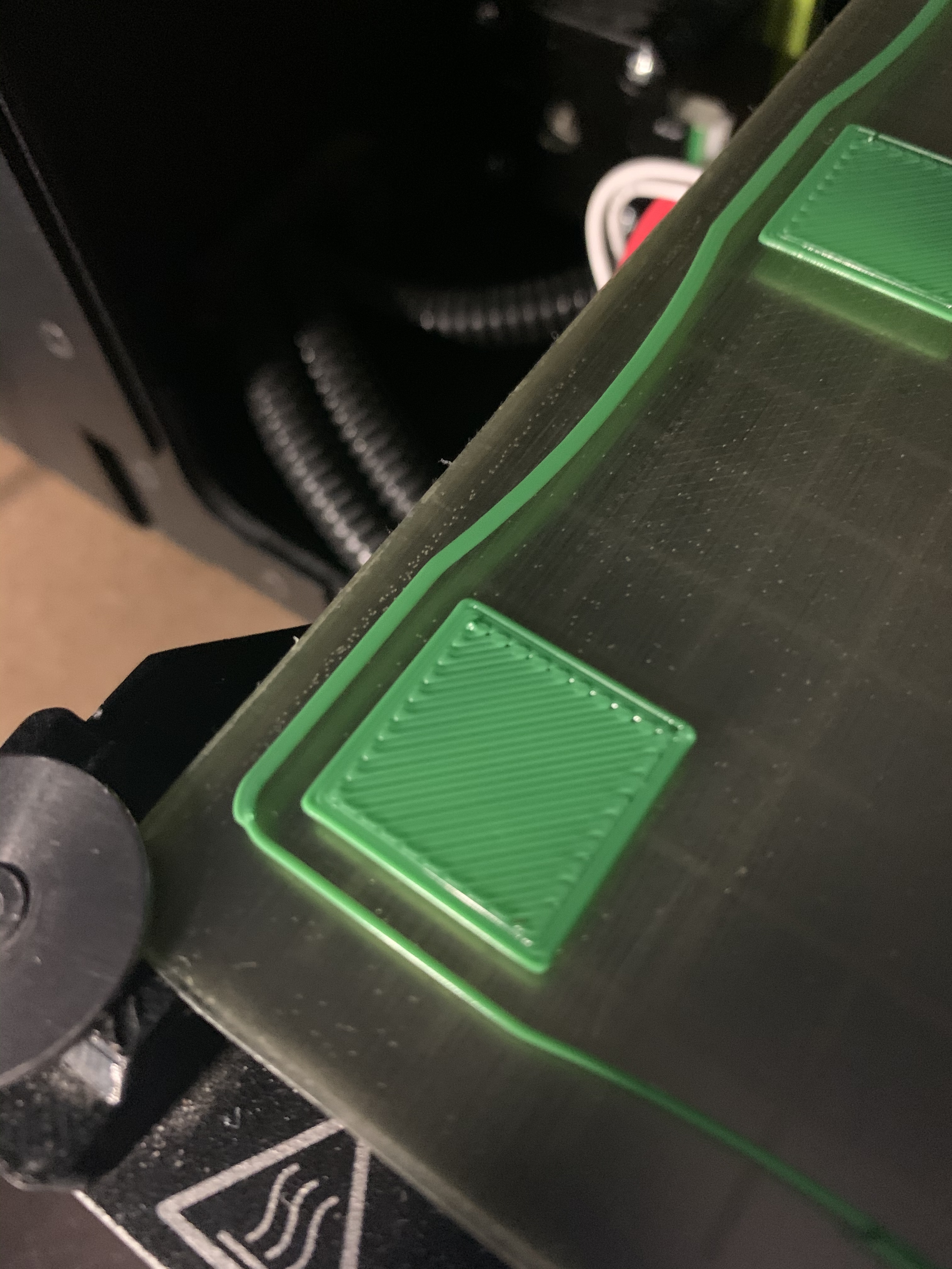

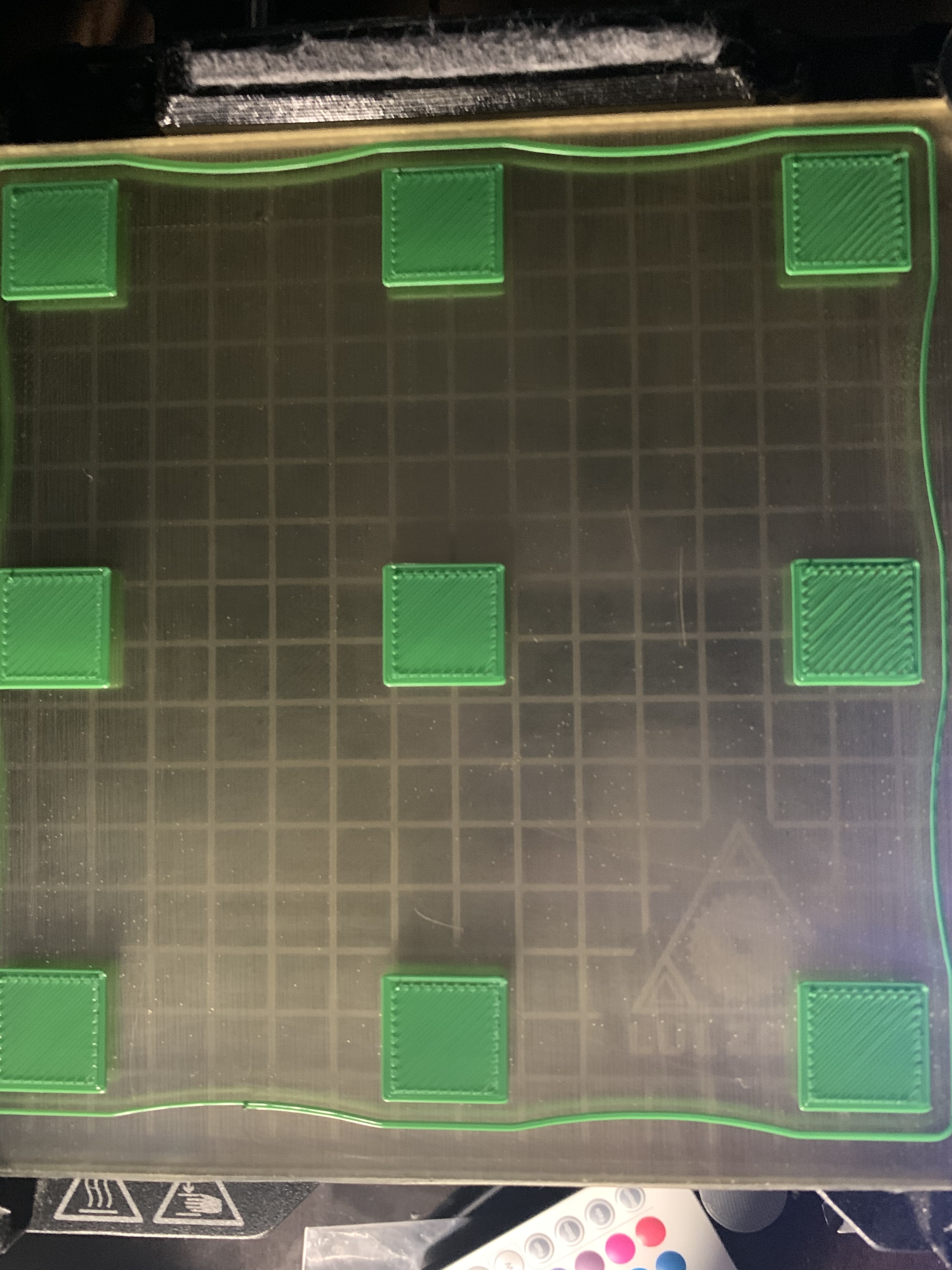

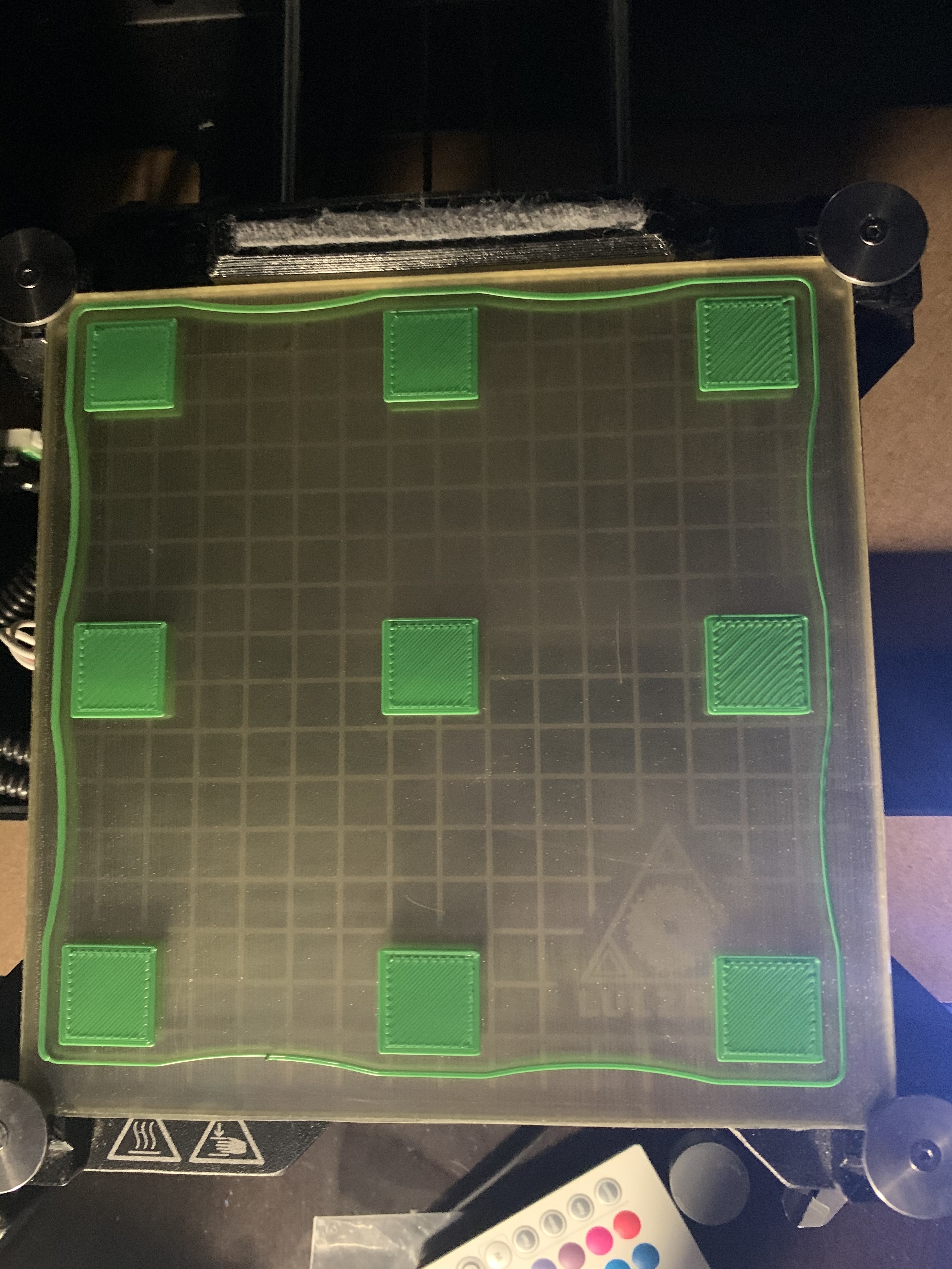

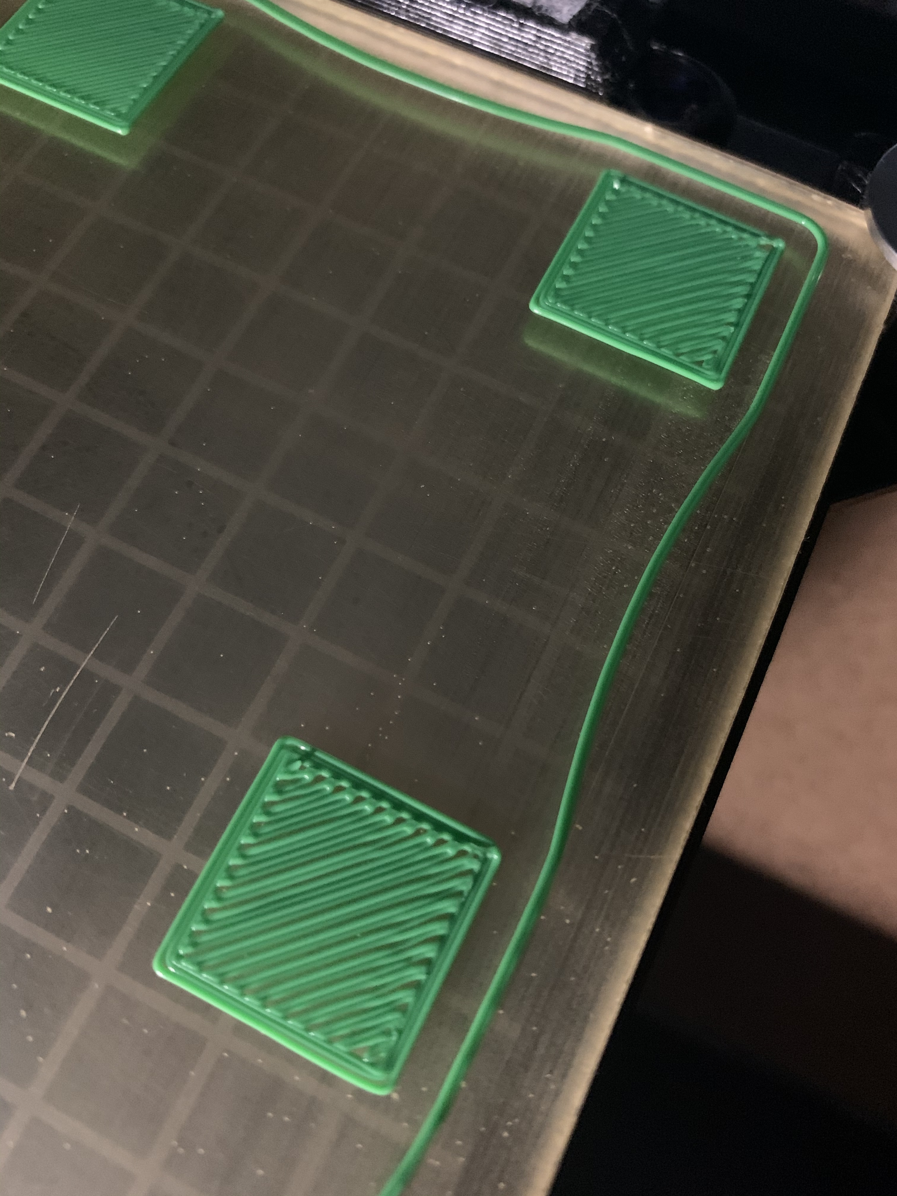

When printing an array of 20x20mm first layers I noticed that the nozzle is much tighter to the bed on the left side than on the right. The center gets very nice first layers, the left look good but a little tight on the z-offset, but the right side of the bed is horrible.
This is most prominent in the skirt, with the left side very thin and pressed to the bed, and the right is barely pressed to the bed. When printing the second skirt line, the right side of the skirt almost always looks as if it is on top of the first line. This goes away with higher z-offset but at that point there is little to no bed adhesion.

I have these same issues with my Mini 1, it seems to just be the nature of the printer. I am looking for a solution as well, all I can think of is to find a way to either raise the right side of the bed (or put thinner washers on the right two corners) or lower the left side and adjust the Z height. The ringing could be uneven extrusion or bent Z rods (unlikely because Mini 2 doesn’t use threaded rods), both of which I am unsure of how to solve properly.
