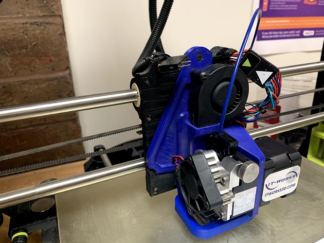

First off, this is not my printer and have very little experience. A shared maker space, but regular repair guy is away for 6 months, so I am trying to get it working. After a web search I found and followed the instructions, and continuity between 4 corner buttons and metal bed plate is good. However, the print head was swapped at some point with an Aerostruder I believe. So the instructions for the nozzle continuity are not the same. Any ideas on next step? Not keen to dismantle the thing, if its not needed.

The pic above is a TAZ, related to another issue I posted elsewhere. Our mini has no LCD, and this print head. Need to know how to test continuity from the nozzle, because it fails bed level.
The nozzle is where the filament comes out and testing continuity between the nozzle on this print head should be the same as any other print head. You are checking continuity between the nozzle and the controller board (you can find a diagram / picture on the LulzBot website). If this test fails, you need to check from the board to the pin on the connector at the head (again, diagram / picture on the LulzBot website, and the nozzle to the pin on the connector on the print head (which should match up with the connector from the controller board). If required, fix the connection that fails.

Since your printer does not have an LCD, you have a “Mini 1”.
Your print-head was upgraded to the LulzBot Mini AeroStruder Toolhead (this didn’t come standard with the printer, but is an upgrade part sold by LulzBot for your printer).
IT-Works 3D (the maker of your toolhead) is a LulzBot reseller & service center. They sell upgrades, replacement parts, etc.
The board on the Mini has a section where the “end stop” wires are all connected. There are end-stops for each axis. The Z-min should be wired to the bed and print-head so the circuit is completed when they (the nozzle and bed washer) make contact.

Unfortunately I do not know which wire is attached to the bed frame vs. which wire is attached to the print-head. You’ll probably need to trace the wire back to the board (or from the board to the head – either direction) and test that the wire is connected all the way through with no breaks in continuity.
E3D makes the Titan AeroStruder. But the AeroStruder has to be assembled into a toolhead that can mount to the X-axis carriage. LulzBot sources the extruder from E3D (E3D-Online.com) when they build the toolhead. But you toolhead was built by IT-Works 3D (ITtworks3D.com) – again, also using the very same E3D Titan AeroStruder. All the wiring that controls the heater, thermistor, z-axis minimum probe, fans, and extruder motor … all have to go into a modular connector that matches up with what LulzBot has on the X-axis carriage.
One of the pins on that wiring harness (I’m not sure which) will be wired to the zero-sense wire used by the Z-axis min connector back on your board.
On my printer (a TAZ Workhorse with a Titan Aerostruder toolhead – though not the same as yours) the zero-sense wire used to probe the bed washers is connected to one of the screws that holes the aluminum heat-sink in place. I’m not sure where IT-Works 3D attaches their wire (it would not necessarily have to be in the same place) but you certainly could phone and ask.

I also have a Lulzbot Mini 1 and have had this issue in the past for me it was the fact the grounding wire had come detached. The single wire on the underside of the print bed on the front left. Check that as well.
