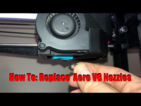

If you’ve never changed a nozzle before, there are a few tricks to know.
Here’s a video that walks through the steps (and precautions):
Note that he’s using an IT-Works 3D head compatible with the printer… but it uses the very same v6 heater block that your head works … so the instructions are still the same.
It’s IMPORTANT to make sure that the nozzle doesn’t “bottom out” on the heater block.
In extruder design, the heat-brake threads down into the heat-block from above… while the nozzle threads up into the heat-block from below. The end of the heat-break and nozzle must make solid contact int the middle to form a seal. If they do not seal, then filament will leak through the gap, squeeze between the threads, and start oozing out of the heat brake (the gap between the hot-end and cold-end of the extruder). This has happened to me … more than once. That leaked material will then act as an insulator and you’ll have two problems… the bed-leveling performance will be poor (because it wont get good continuity to know when the nozzle touches the bed leveling washers) and goo will occasionally drip on your parts.
So make sure that the nozzle doesn’t “bottom out” on the heat-block (there should be a tiny gap) once the nozzle is tight. That confirms that what is preventing the nozzle from going in further is the heat-brake and not the heat-block itself. (This means you have sealed the gap and wont get leaks.)
