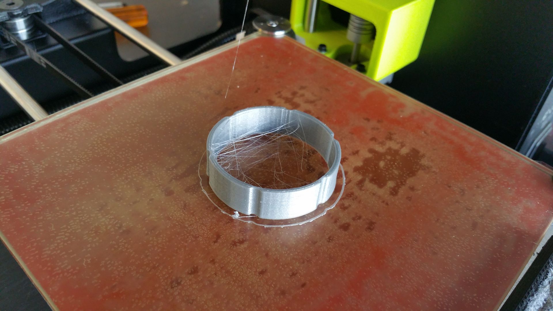

I have been using Ngen from the start but of recently I have been getting a lot of strings. I tried the suggestions that have been posted in this thread but it has not changed. I have a Lulzbot Mini. I ran over a dozen of the parts of the picture I have attached before it started to get stringy.
Would speed change this?
I have also noticed that my perimeter around the print isn’t a full line width but that may not be a filament issue.
You might try reducing the nozzle temp a few degrees, but if it printed dozen parts fine and then started getting stringy and having reduced flow, then you may have a partial clog.
So how would you go about clearing a clog?
Stringiness is a sign of printing too hot and not enough retraction. Could also be a dirty nozzle.
Lower the extrusion temps as suggested above… a few degrees, I’d slowly lower 2-5C. You can change the temp on the fly, but give it time to stabilize before lowering again.
Next, try increasing the retraction by increments of .1. This more retraction will create more suction in nozzle to keep “suck” up the filament, and until the nozzle move is complete.
Its going to be a combination of those two parameters. The key may be upper layer separation. For tall prints you want good layer adhesion, otherwise it may split… this may not be the case for Ngen, but definitely the case for ABS. Obviously if you lower the temp too much to rid the stringiness, it may not print tall objects very well. Increase the temp, then work on the retraction… etc.
If your slicer has a “Coast” setting, set it to .2-.3.
