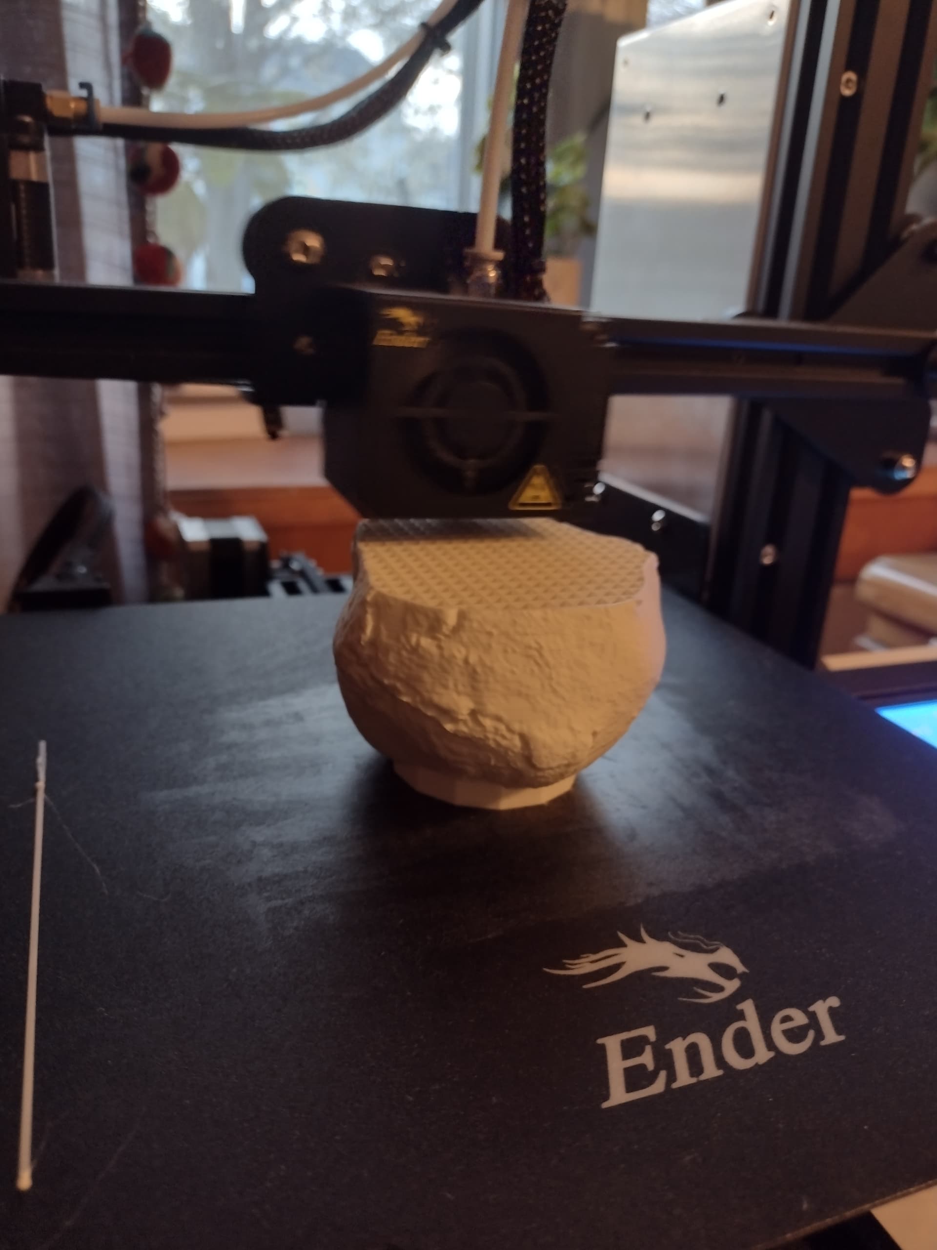

I can open it in Cura 21.00 and can see the file but won’t print correctly.
I can not open it in Cura 3.2.32. Keep getting errors “Scaling Object, Auto scaled object to 100000% of original size”.
I can print other things that I created or downloaded just not the file above.
TAZ 6
Thanks for any help or solution.
Alan
The model is non-manifold and can not be auto repaired by Cura.
