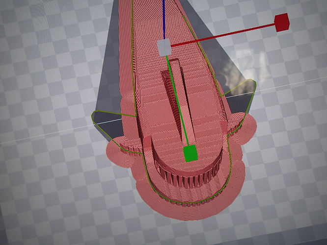

There I am, and I open a stl file directly in Cura 2.6.66- no problem there, however I enlarge the object by 300% and in solid its perfect with all of the bits, however when I go to layers the side bits are missing? when saved to card and I start printing out those missing bits are still missing- bit of a problem if ones printing time is 10 hours plus… I’m probably missing something in the settings any help please.
See photos:300% solid all there, 300% layers side bits missing, 100% layers all there?
If your wondering its a lego shark for my great nephew- side bits are the side fins- mouth is a movable part and thus missing to print out separately.

I downloaded that, and the STL has some problems. My guess is that at 100%, the holes and non-manifold issues are small enough that Cura corrects them – but when enlarged to 300%, it can no longer cope.
I ran the file through the online Netfabb service (https://service.netfabb.com/service.php), and that seemed to fix it up. Give the attached file a try.

It’s not really a problem with Cura. That model renders incorrectly in Simplify3d as well (and I expect Slic3r, but didn’t check). The problem is that the model has holes (called “non-manifold”) and surfaces facing the wrong way (i.e., some surfaces are “inside out”), among other things. All the popular slicers have some ability to “repair on the fly” for minor problems, but they aren’t designed or intended to handle everything. The model needs to be fixed.

Found another piece that needed repairing- however the repair software can’t do anything with this piece? I’ve tried several things but no luck- its looks wrong, but I can’t verify it unless I actually print it out. And at 10hours 44 minutes at this scale that would quite a waste of time, money and filament, Cura can’t show any other detail than a slight thinning of the shell on the layers option- and netfabb online service says its fixed but when I reopen in Cura shows the same error in the layer option- however the print time has gone up by a minute? Its not a massive problem- just would have been nice to have a perfect part for my project- which if your wondering is a super sized Apollo lego set 21309 at 300% original size- which makes it just over 3 metres high. (I know its crazy!)
That’s block 6222 from printabrick, correct? I took a look at it, and it has a multitude of problems (holes, self-intersecting faces, etc.). After a netfabb repair, the entire bottom surface is still missing but Cura is fixing that on-the-fly. There are also areas where the skin is missing or incorrectly dimensioned, and that’s what you are seeing in the Cura layer preview.
It is also not “solid”. The external holes are “open” to the interior of the part, which means Cura sees the model as hollow and doesn’t provide any infill, leaving the entire top surface unsupported. You may be able to print it with Cura supports turned on, but the part strength will be severely compromised. I doubt you’ll get an acceptable print from that model.
You will find a LOT of .stl files on the internet that have problems which make them unprintable. The automatic repair routines built into Cura, and even the Netfabb service, are pretty good but can only do so much. For models with minor problems, they can usually make corrections. This particular model is just beyond their ability. It essentially needs to be re-drawn or imported to some CAD package and manually fixed.
Unless someone else here has a better suggestion, I think your best bet is probably trying to find an alternate (better drawn) copy of that STL created by someone else, or a copy that someone has manually hand-corrected (i.e., by importing into some drawing package and painstakingly fixing all the issues).
