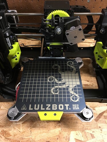

I think I screwed up and ordered a modular bed and magnetic flex bed for my Mini 1. The install of the modular bed, magnetic base and leveling washers went fine. But, when I was all ready to go and put the thin flex bed over the new magnetic base, the edges of the flex bed overlap the washers. The upgrade did not come with new smaller diameter washers (the current ones are 22mm).
I was thinking I could just make/buy some smaller diameter washers like 15mm and I might be set. Unfortunately, I put the old bed back in to watch the auto leveling run and a smaller washer would not work as the nozzle would not touch it. So, there seems to be at least 4 solutions.

The forth solution seems the easiest but I’m not sure if it might shatter if I try to cut it with an abrasive cutting tool or a simple hack saw. I should point out that the magnetic base fits fine. It is only the thin flex sheet that does not fit. The magnetic base fits the modular bed and mounts just fine. The problem is that the washers sit too far into the bed area and do not allow the flex sheet to sit flat.

I had the same issue. I trimmed the corners with a dremmel and regular old cut off wheel attachment. No issues. Works fine. 15min fix. Back in business.
Thanks for the help. I was able to cut off the sheet corners and all is well. I did need to file down the corner spacers a few mm as the magnetic base was able to slide around a bit.

I did find that using a file on the spacers was a bad idea as the leveling spacers were no longer level so it was not possible to tune in the Z-offset over the entire print surface. The answer for me was to use my original 8mm spacers ( instead of the 10mm with the kit) and take the two washers from the bed rubber mounts and stack them below the big bed leveling washer. This created a 9mm spacer that was flat and now it is all tuned up and prints work great. The bed is nice and snug.
