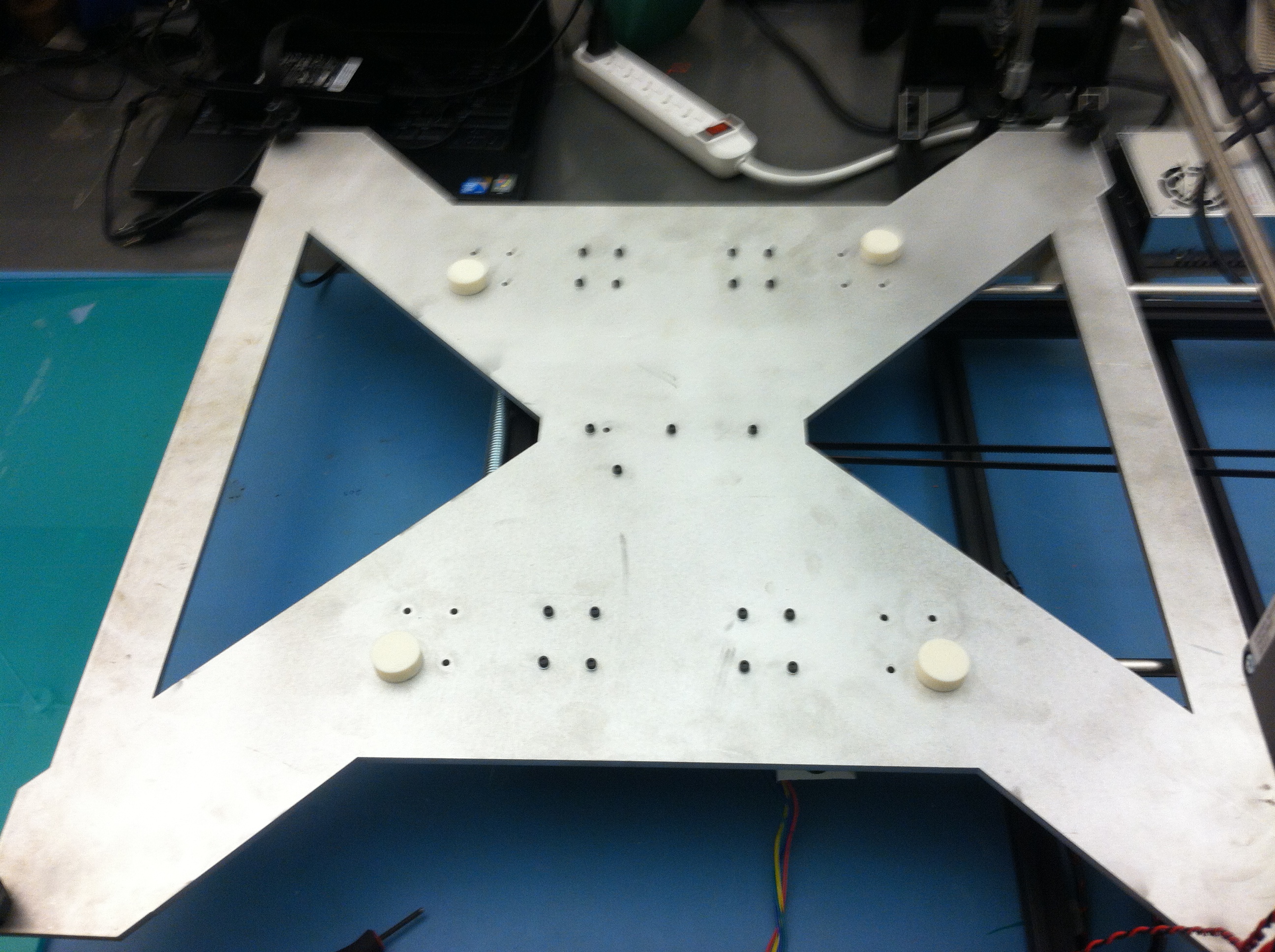

We ended up using 10mm rod as on the stock TAZ printers. This hasn’t posed a problem for the tool head but the bed proved too heavy for the Y-rods to act as support. Kent designed custom rollers which David drew and I printed. This solution has proved very workable.
Here is a photo of the custom rollers that support the aircraft carrier size bed:
Rods installed
Kent drew the aluminum bed-plate and we had it cut at Rocky Mountain Waterjet in Greeley. They are great. The original bed was massive so we re-drew it and sent it back to have it re-cut thus eliminating a third of the weight. We also cut mounting holes closer together so the mounts/bushings wouldn’t interfere with the Y-stop.

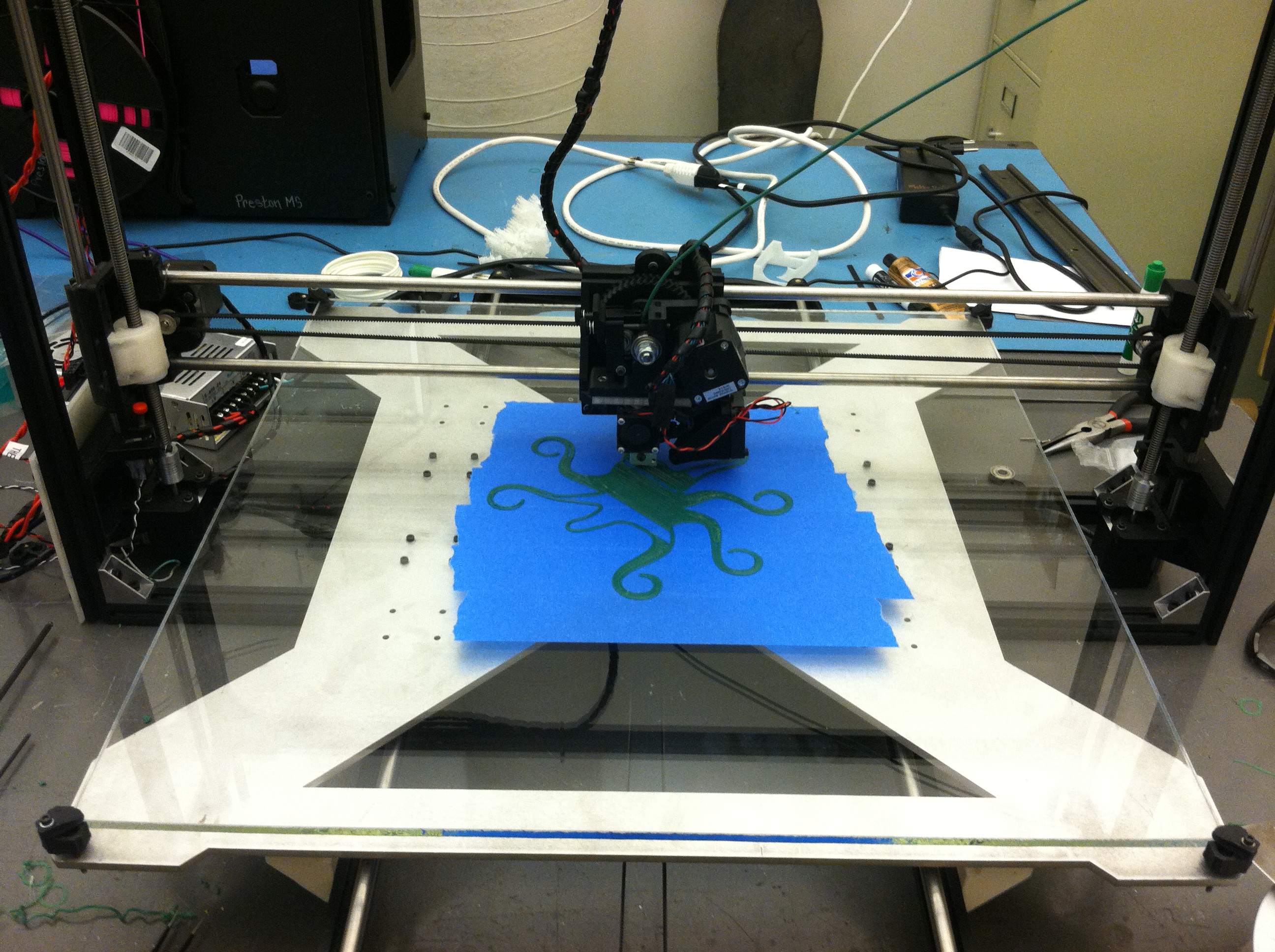

Glass!! 600mm x 600mm Boro plate courtesy of Allen Glass in Boulder. They are awesome and have an amazing shop.
First print. No bed heater. Rocktopus.

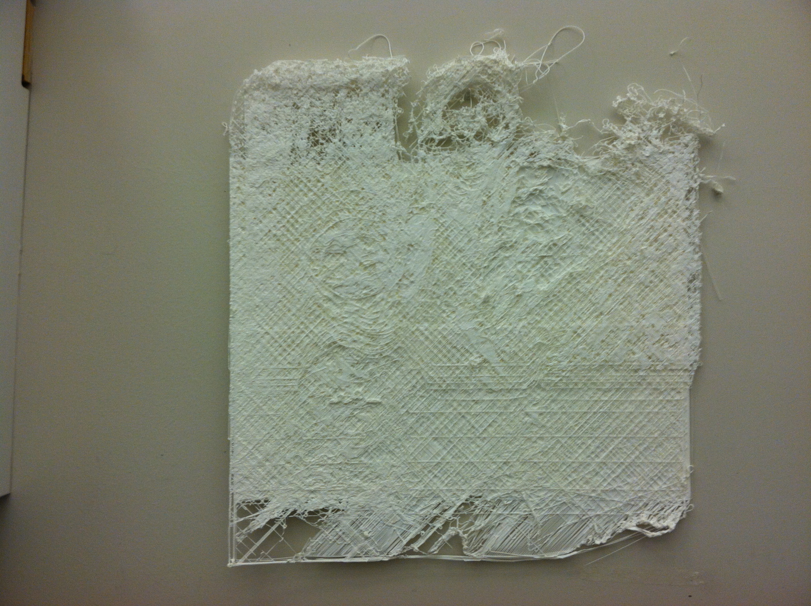

Below is the second print. An attempted Lithopane 575 mm x 575 mm to print on the entire bed while using a minimum of filament. It had considerable Y-slippage and I stopped the print after 8 hours. We replaced the pulley on the Y-motor with one with fewer teeth and that seems to have solved the slippage problem by increasing the torque exerted.

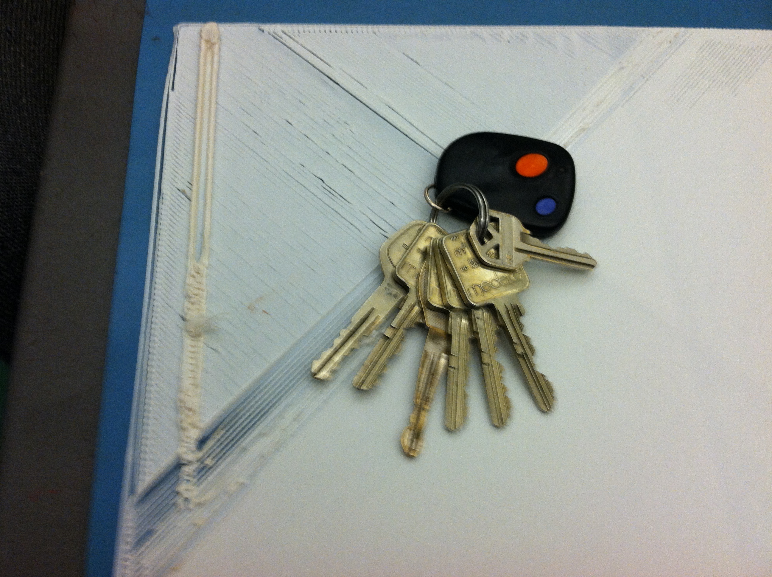

3rd print was stopped when the Y-pulley came loose. PET tape applied.

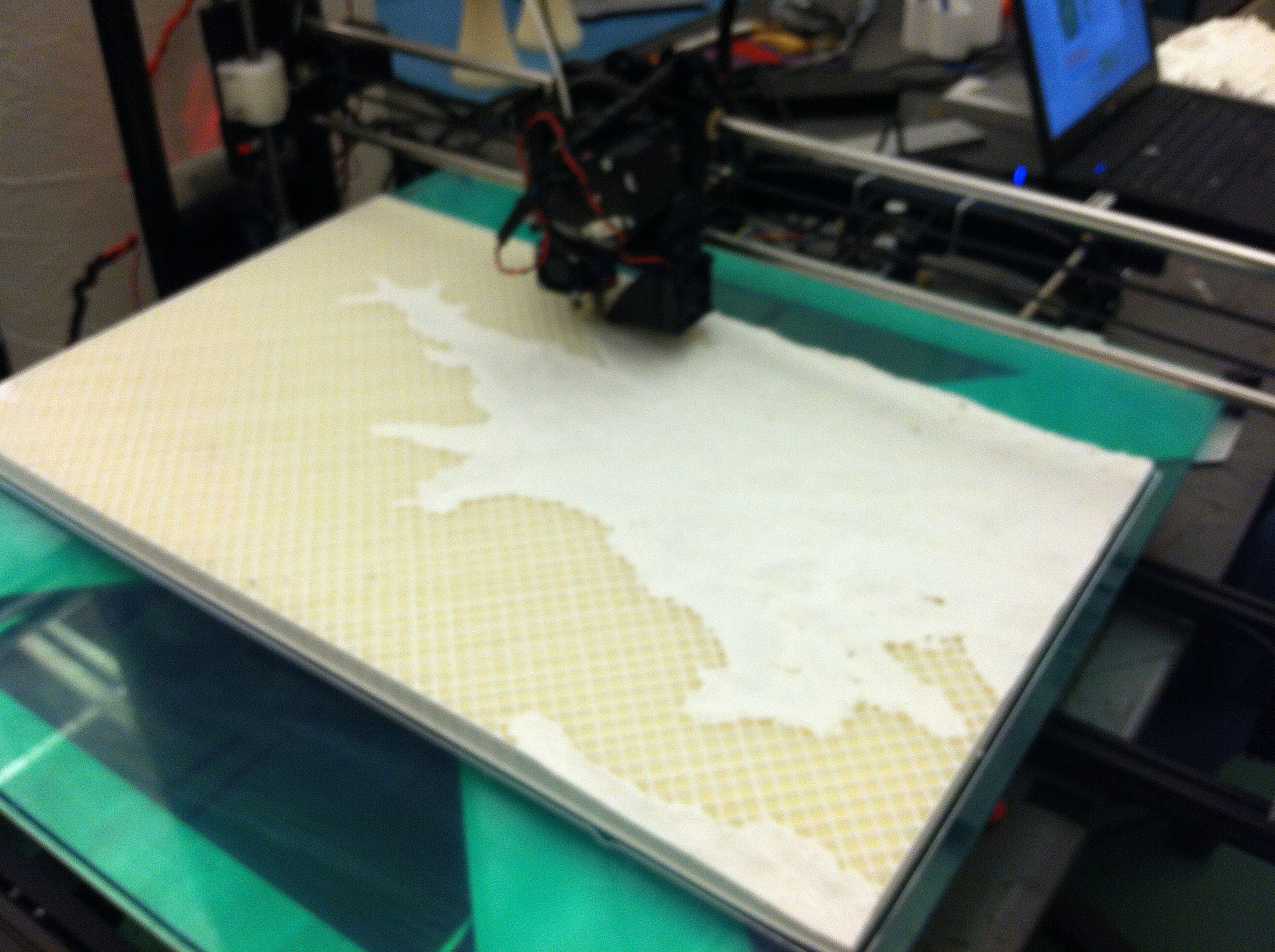

4th print is of a portion of CU Boulder campus from LiDAR data. It turned out well though, I need to have more top layers to cover the relatively sparse infill (20%). I am now finishing the prints with 4 surface layers.
