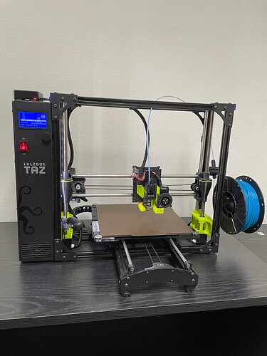

Hi all,
We have had an idle Taz 6 that the engineering students said wasn’t working properly. We’ve upgraded our print lab to newer machines so my boss said “make it go away”, which I did!
I already have a print lab at home with nearly two dozen machines. They are in safety enclosures for fire and fume abatement. I’m just mentioning this so you understand I am familiar with 3D printers!
I’ve always been curious about the Lulzbot machines, since they seemed to have a core following.
This one had a few issues, such as a broken wire on the “zero sense” connector and the X Carriage has an issue too. A student inserted the screw from behind and over torqued the screw, so that insert just spins and spins. I’ve tried to heat it up, hoping it would reseat, but that screw is super tight and loosens any connection that brass thread had. So far, a washer and nylon insert nut holds it on.
Now that I have the thing doing it’s first successful prints, I am ordering a safety enclosure for it.
That leads me to wonder about what upgrade paths there are for this 6 year old printer?
The biggest on my wish list would be silencing those stepper motors. BL Touch bed leveling and adding a Wham Bam bed are second and third.
Thank you in advance !
