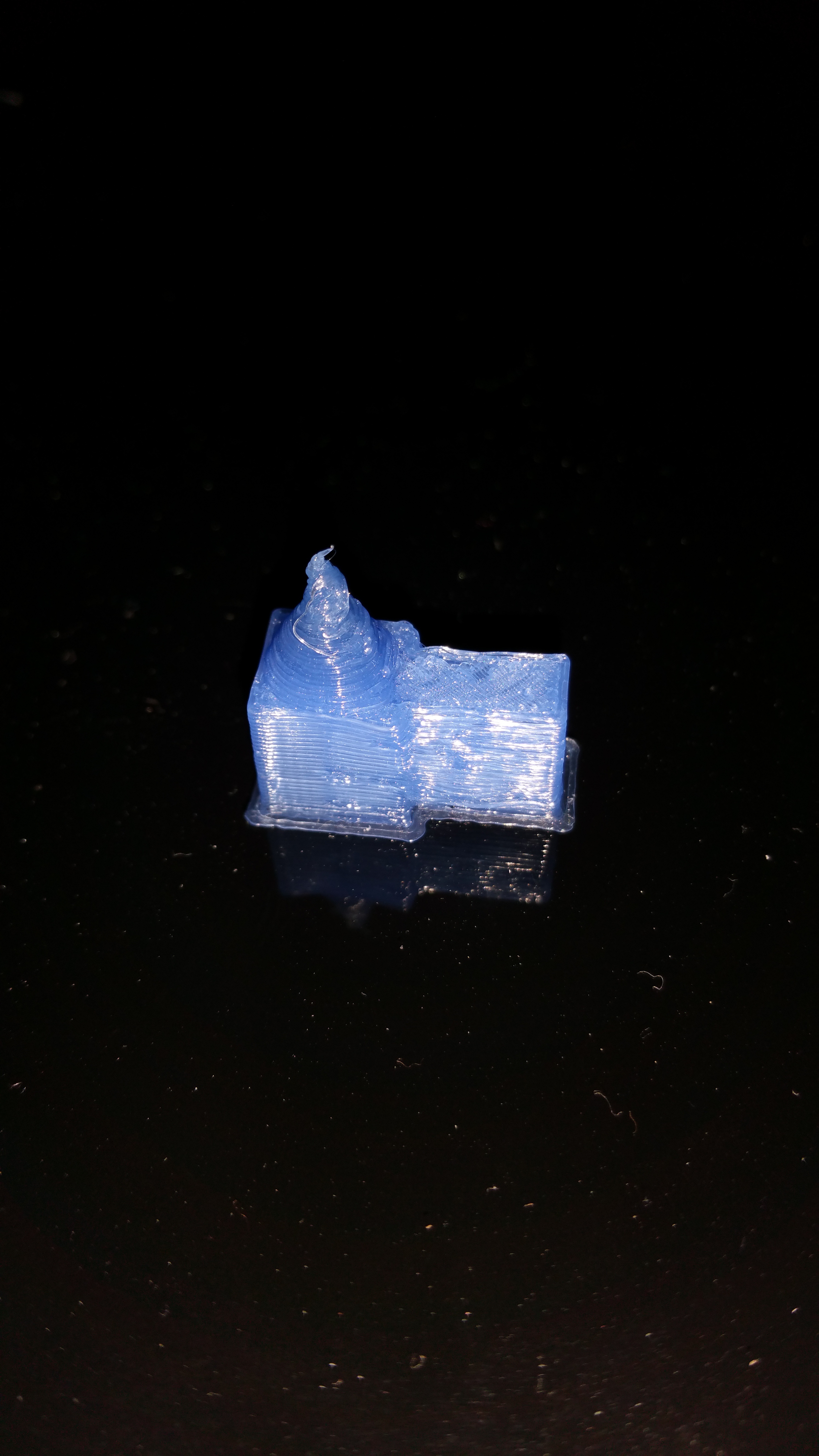

Initial run on my test object pictured below. Settings for the test were as described above with a .35mm layer height.
Based on the pictures I think the extrusion temperature may be too high due to the melting of some perimeters. although with the oversized layer height it may be of some benifit to reduce layer height to .25 and try again at the same temp.

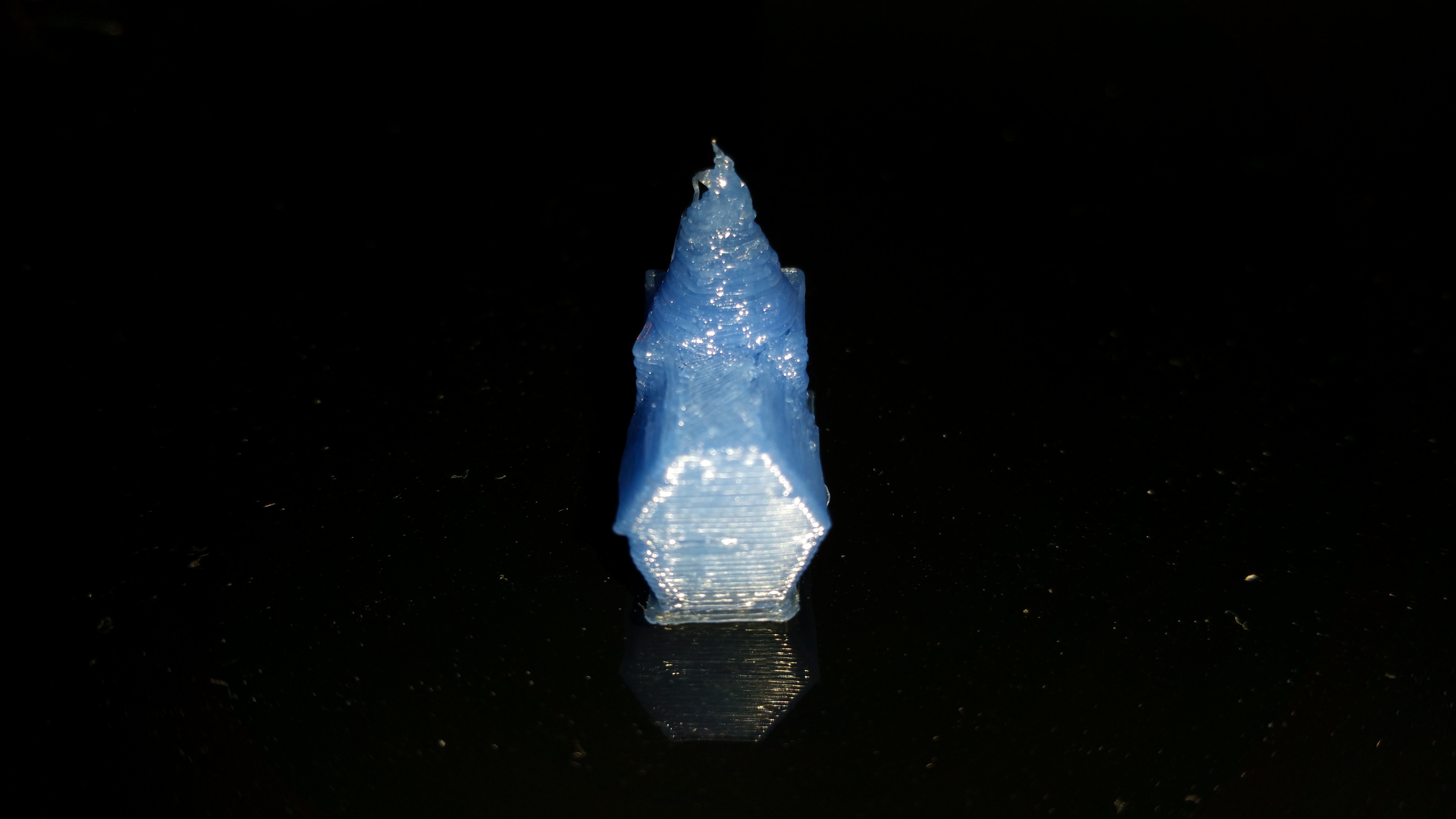

Test 2 was conducted with a reduced layer height to .25mm.
Current infill is 15% Recilinear
Some Observations during print:
-1st Layer adhesion is excellent with bed at 60C part easily removes from Kapton Tape
-During short / rapid movements of the nozzle the PET + Begins to melt underneath. During large movements the PET+ displays no heat fatigue probably due to nozzle temperature. This can easily be seen between the cone and the Polygon shape.
-The cone on top of the part is better on test #2 with fan operating at 100% (Cone part only). Melting can be observed as it gets closer to the top probably due to nozzle temperature.
-When part was removed layer adhesion appeared to be superb. Part toughness with only 15% infill was good.

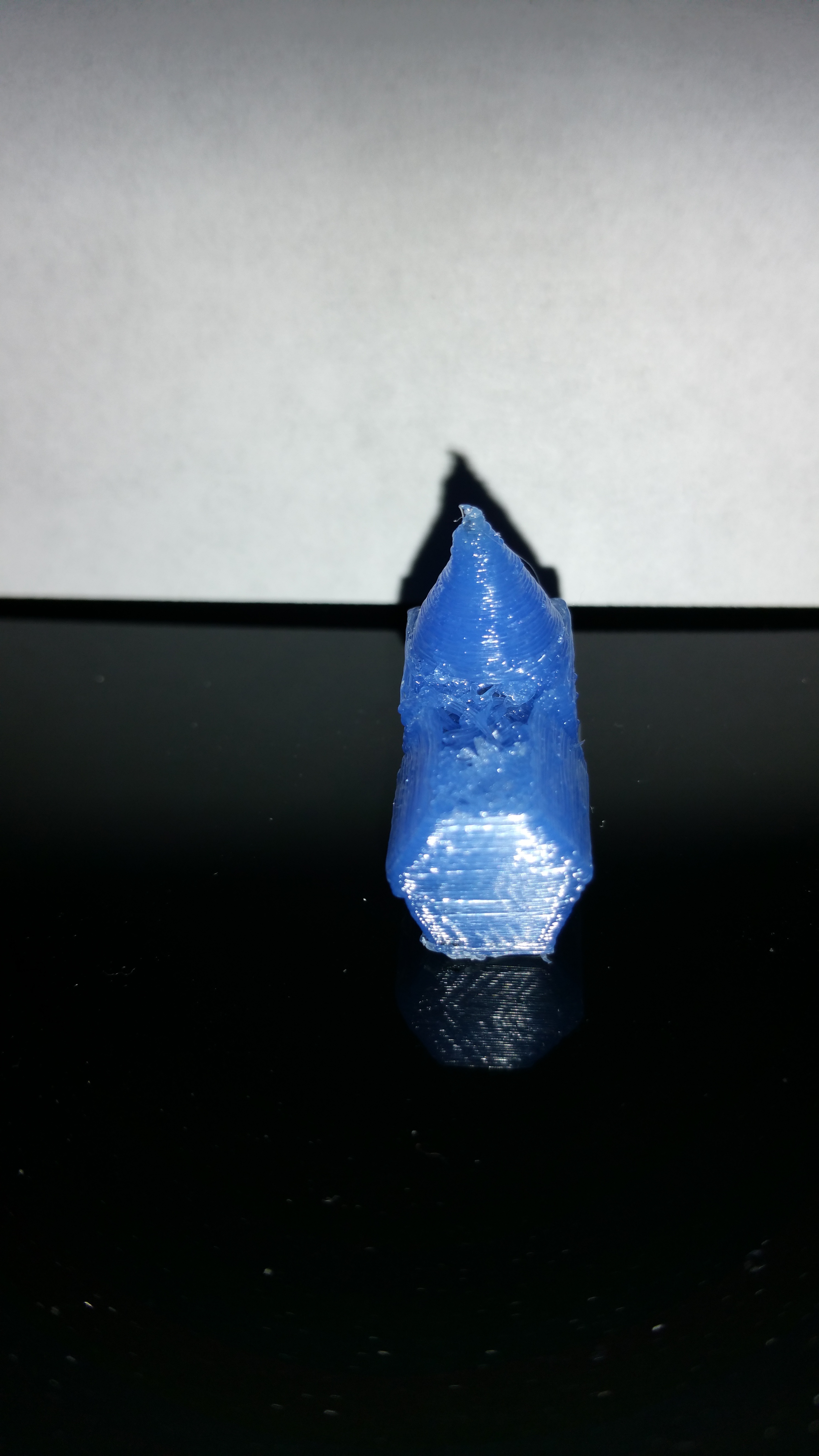

Test 5:
Changes:
Test was run with extruder at 225 for all layers
Fan speed 40% throughout test.
Observations:
- Perimeter melting IVO hot end was significantly reduced /eliminated with the introduction of the cooling fan at 40%.
- Part appears to still have good layer adhesion.
- Area IVO Upper cone significantly improved in appearance with addition of cooling fan. (No sunken cave)
- Part remains easily removed with hotbed still warm after print. (Could be due to small surface area of print)
- Nozzle oozing appears significant at >228C
- The filament is difficult to remove from hot end after oozing
Moving Forwards:
Bump Cooling speed to 50% on subsequent test in an attempt to reduce outer perimeter imperfections.
Keep Hot end temperature at 225 for first layer and try 220 for subsequent layers?
Assumptions:
-The slower the Hot end is moving with respect to the part the > Cooling must be to prevent melting. Speeds as advertised from manufacturer appear to be possible with cooling only.

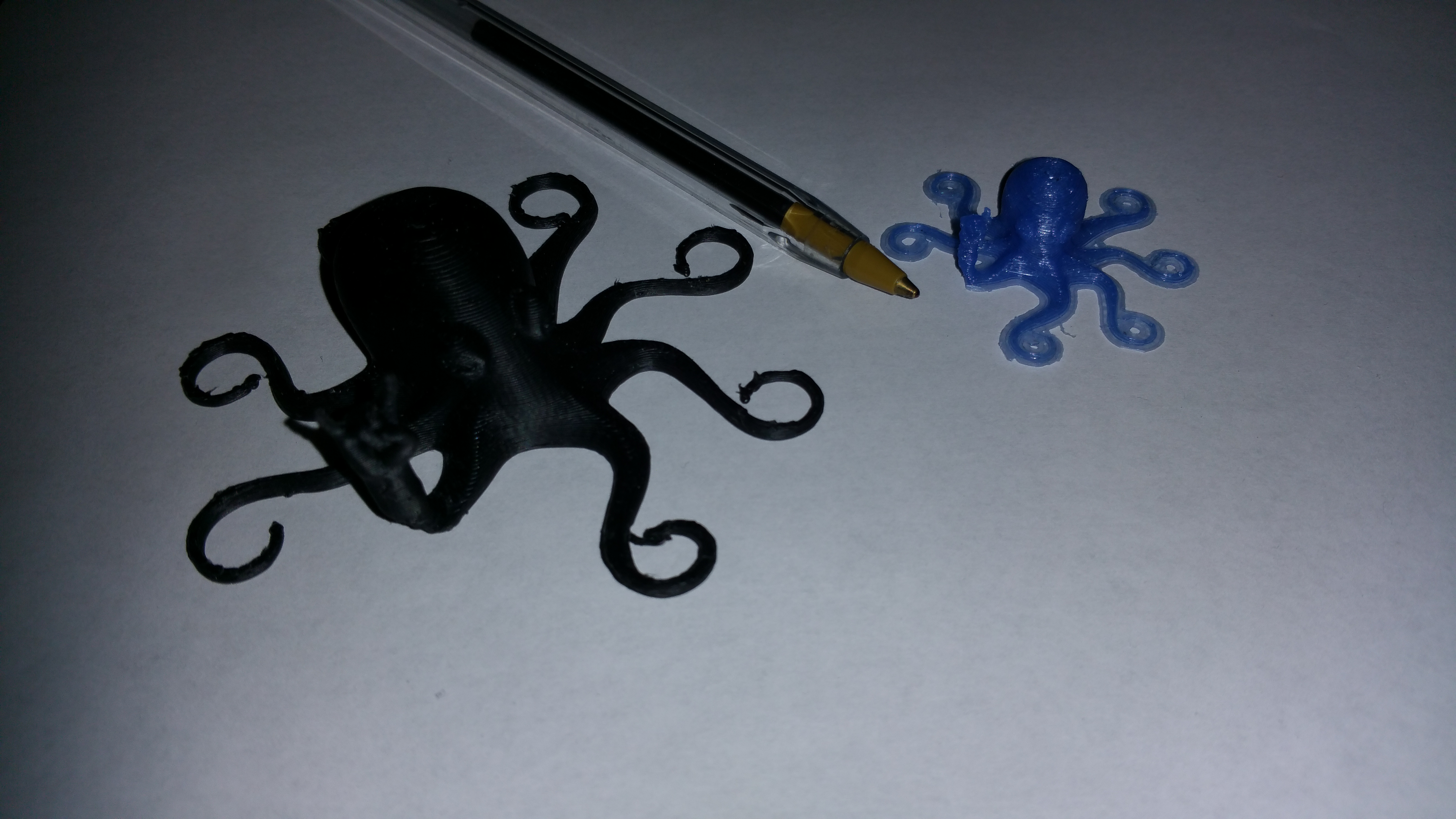

Based on this Layer height and cooling ratio the next test will be a standard Rocktopus.

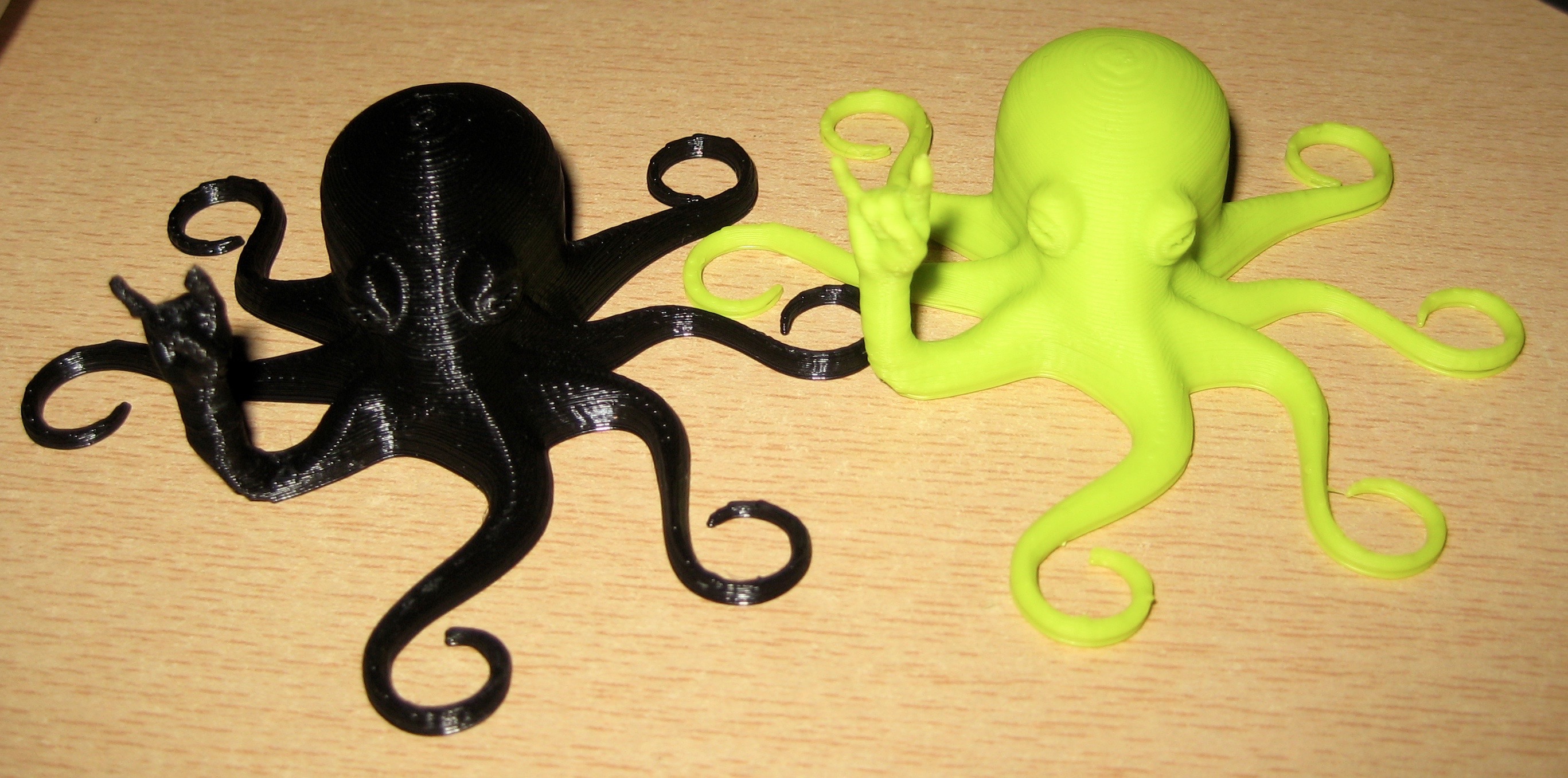

Well…To get the obvious out of the way… The rocktopus that comes with the Taz is not a 100% scale piece from the site nor is it 25%.
Despite my surprise upon returning to the printer to see the lil guy and i do mean lil guy. I was actually very impressed with the print quality given the layer height and speeds.
The PET + Print is in blue and another print in ABS is in black for reference.
Observations from rocktopus accidental mini print:
- The print appears to have brim around the first layer. about 1mm in size. No brim was selected in slicer. This could be due to the impressive small print or due to some over-extrusion on the first layer programmed into slicer. More testing will determine.
- The tiny print maintained good adhesion to the bed surface and easily came off the kapton tape when cooled. minimal pressure required.
- While not visible to my eyes, after a quick review of the HD close up photo of the PET + Version, you can see some minor some minor imperfections (Gaps in perimeter) around the eyes and on top of the head. This could probably be fixed with additional outer layers (Shells i think they are called) and upper layers. Some however would not consider this a requirement for the sake of time.
- The print quality seems good overall for even such a small item. While It is missing a finger it does maintain the details around the eyes as seen on the ABS print. The missing appendage is most likely due to a layer height issue in comparison to size.
- The increased fan speed of 50% appears to have mitigated all of the perimeter melting issues. The fan maintained a 50% speed only after the first X(3 in this case) many layers.
- At only 15% infill the small rocktopus is rather strong. Infill was rectilinear for the print.
- PET + Is very difficult to clean off the nozzle. Oozing remains problematic during Hot end warmup. If too much oozes out when the print begins the first layer may become damaged. (Failed print). While i have not worked with PLA i get the feeling that the cleanup of this filament may be similar.
-Print took 8minutes according to the printer interface.
-Print was executed from the computer not SD Card.
Assumptions:
- Print could probably be executed faster on the Taz 4.1. With 30mm/s perimeter and 60mm/s infill, the inter layer bonding remained solid.
-While the manufacturer recommends not printing with the fan on. 50% fan speed seemed to work best for me. <50% as shown in the above pictures resulted in the filament melting. This is possibly due to a combination of Hot end temperatures and print speed further backing up my assumption that the print needs to happen faster or turn the fan on. Based on this assumption these settings probably correspond to a mid range print setting. Faster with less detail is possible, or slower with a greater fan speed.

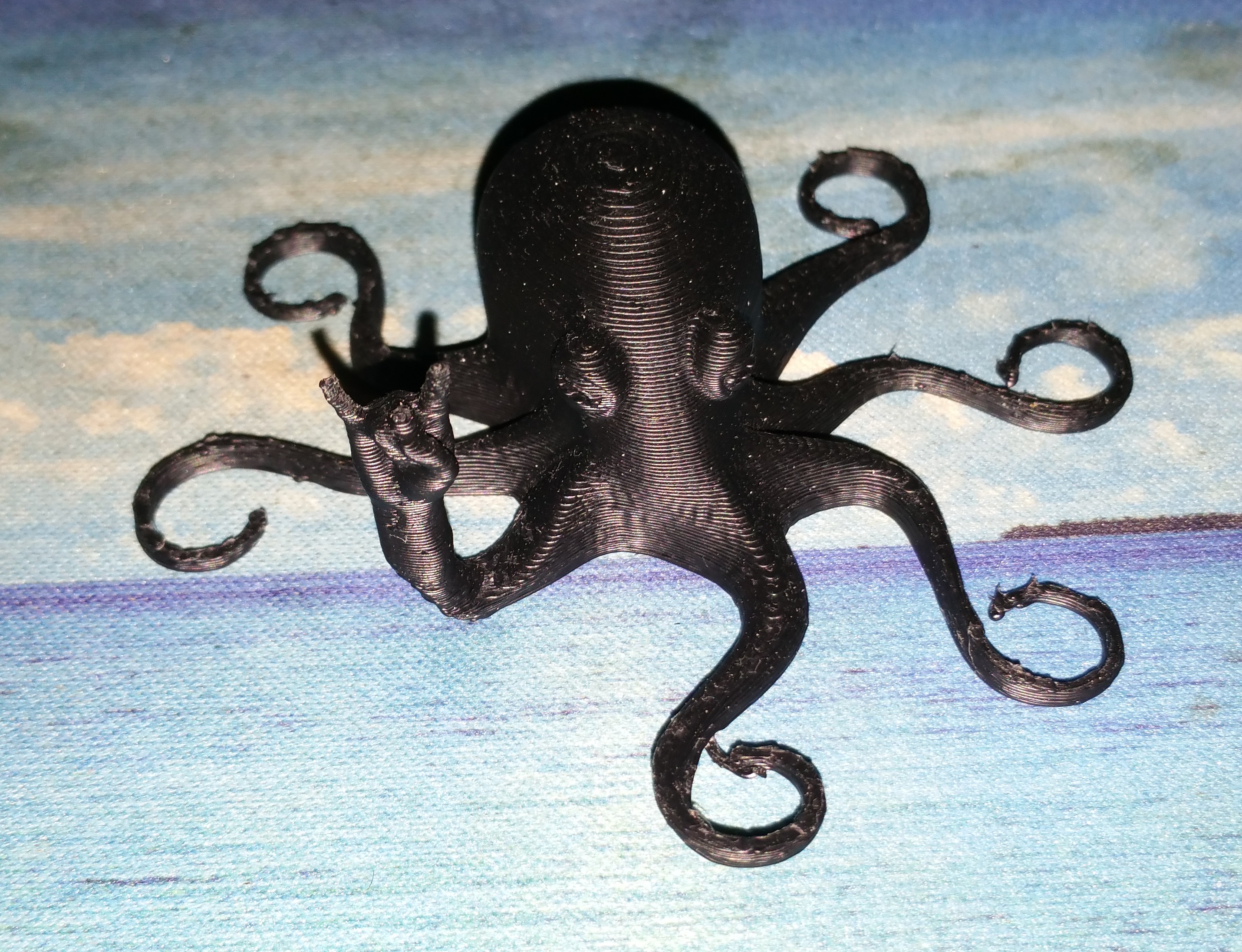

I spat out a quick Roctopus (50% scale) as a baseline when I loaded up my first PET+ filament.
I have a TAZ 5 and used Cura’s quick print “high quality, ABS” setting. Set the temp to 230 and the bed to 65. It’s not perfect, but considering I was expecting a gooey blob…
For those with more experience than I, would you think I just happened to luck upon a better starting place to tweak the profile. Or may it be more due to the difference of TAZ 5 compared to earlier models?
Picture notes:
Black: Madesolid PET+ (cura quickprint high quality ABS settings, 230, 65 bed)
Green: Lulzbot ABS (cura quickprint high quality ABS settings, 240, 110 bed)
Red: IC3D ABS (cura quickprint high quality ABS settings, 225, 110 bed)
These Roctopi were NOT all identical (e.g. not the same STL, much less the same gcode.) Unfortunately that means detailed comparisons can’t be made (e.g. the shape of the forearm differs in the PET+ (black) model because of a difference in the STL).

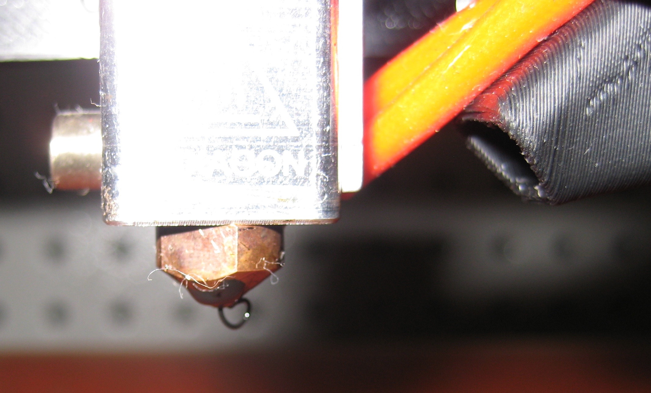

The pic of the nozzle is the extent of the build up AFTER the 1 hour long print.

I have a Taz 4 and the differences aren’t terribly significant from a Taz 4 and 5. (All Metal Hot End, and Print Surface).
The original Nozzle on my Taz 4 looked similar / often worse than your nozzle picture after short prints, and sometimes completely covered for anything longer than 30 minutes when printing with PET +. I have since upgraded my nozzle to the E3D V6 all metal hot end and the problem has gone away completely. The problem will only return when one of the following situations occur:
Partial clog in the hot end:
Diagnosed via slight to extreme filament curling as it exits the nozzle. (May be a potential situation for you based on your nozzle picture.) -
Solution: clean the nozzle by either taking it apart or performing multiple cold pulls.
Retraction not set correctly:
Diagnosed via: As your part is printing if you have excessive stringy - ness , spiderwebs, ect forming between non print moves your retraction is not set properly. -
Diagnosed via: Following a non print move, a small amount of filament has appeared just outside of the nozzle tip. As the print head begins to print again this small filament deposit usually rubs itself on the printed part and finds its way onto the nozzle tip. -
Solution: Adjust retractions - Because PET+ Loves to ooze out of the nozzle, I use a retraction speed of 30mm/s and anywhere from 1-2mm retraction depending on the color and temperature i'm printing at. -
