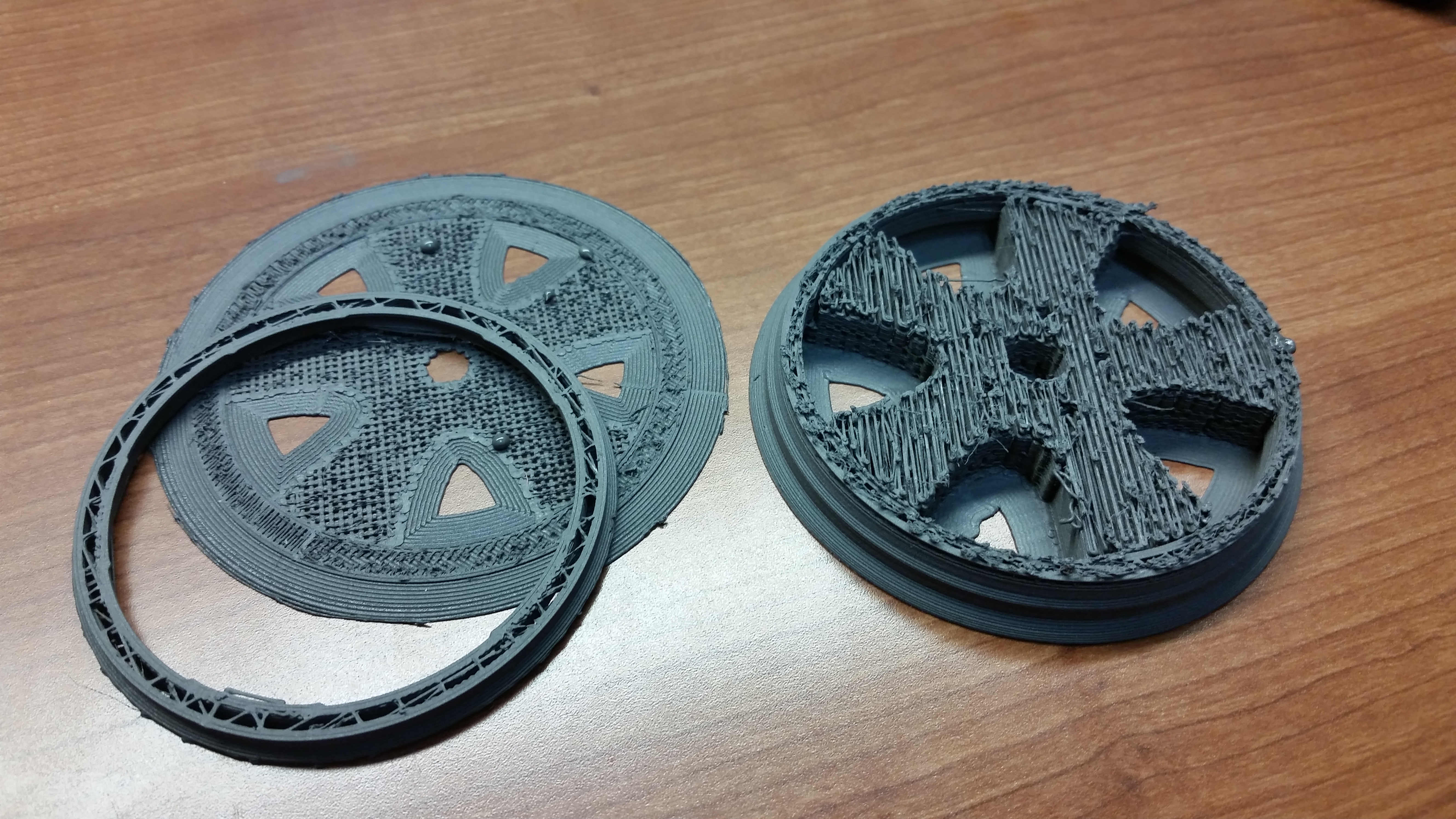

I’ve been trying to print with the Proto-Pasta Stainless Steel PLA filament and have been having some real trouble. On smaller parts it seems to work alright, but every larger print has failed. To start, I noticed that the filament wasn’t just oozing, but dripping out of the nozzle at the recommended 230 degrees, so I after experimenting with temps I did the print on the left at 210. After a USB related failure I pulled the part off and the first two layers separated from the rest of the part. I figured this happened because 210 was too cool, so one layer wasn’t properly adhering to the previous. I did my next print at 225 degrees and the print failed again. This time the filament stopped extruding. When I took it out of the extruder I found that the hobbed bolt had basically worn out a big notch and was just spinning against the filament rather than feeding it through. I took this as being a sign of heat creep causing the filament to be too soft at the hobbed bolt. Finally, I dropped the nozzle down to 220 degrees, and everything was going really well until about 8mm up when it started extruding very oddly (print on the right). I had other prints with this material that also failed like this, and I’m not sure what the problem is. It works fine for a while, and then stops extruding properly. Any thoughts?
Thanks in advance for any help!
I think that’s just another manifestation of “the creep”. I’ve had a few prints that look similar where the extrusion was erratic as the filament was sitting on the edge of being too soft. It would be driven well for a bit, then it wouldn’t and there were layers or even areas of a layer that were very under-extruded. In my case it eventually failed once the creep was bad enough.
I’m probably not the guy to recommend solutions since I have for now given up printing PLA since I suffer from the creep bad (you have a TAZ 5?). You could try something between 210-220 and maybe you’ll be able to hold off the creep long enough. You can try printing faster or add a fan to your extruder heatsink (many on thingiverse - I use this one: http://www.thingiverse.com/thing:845113) Success probably involves some combination of the 3.

That’s for confirming my suspicions about heat creep. I’m going to try and experiment with other temps. I definitely want to add a new heat sink fan. Hopefully that takes care of it. Whenever I manage to make some changes and get something working I’ll post an update.

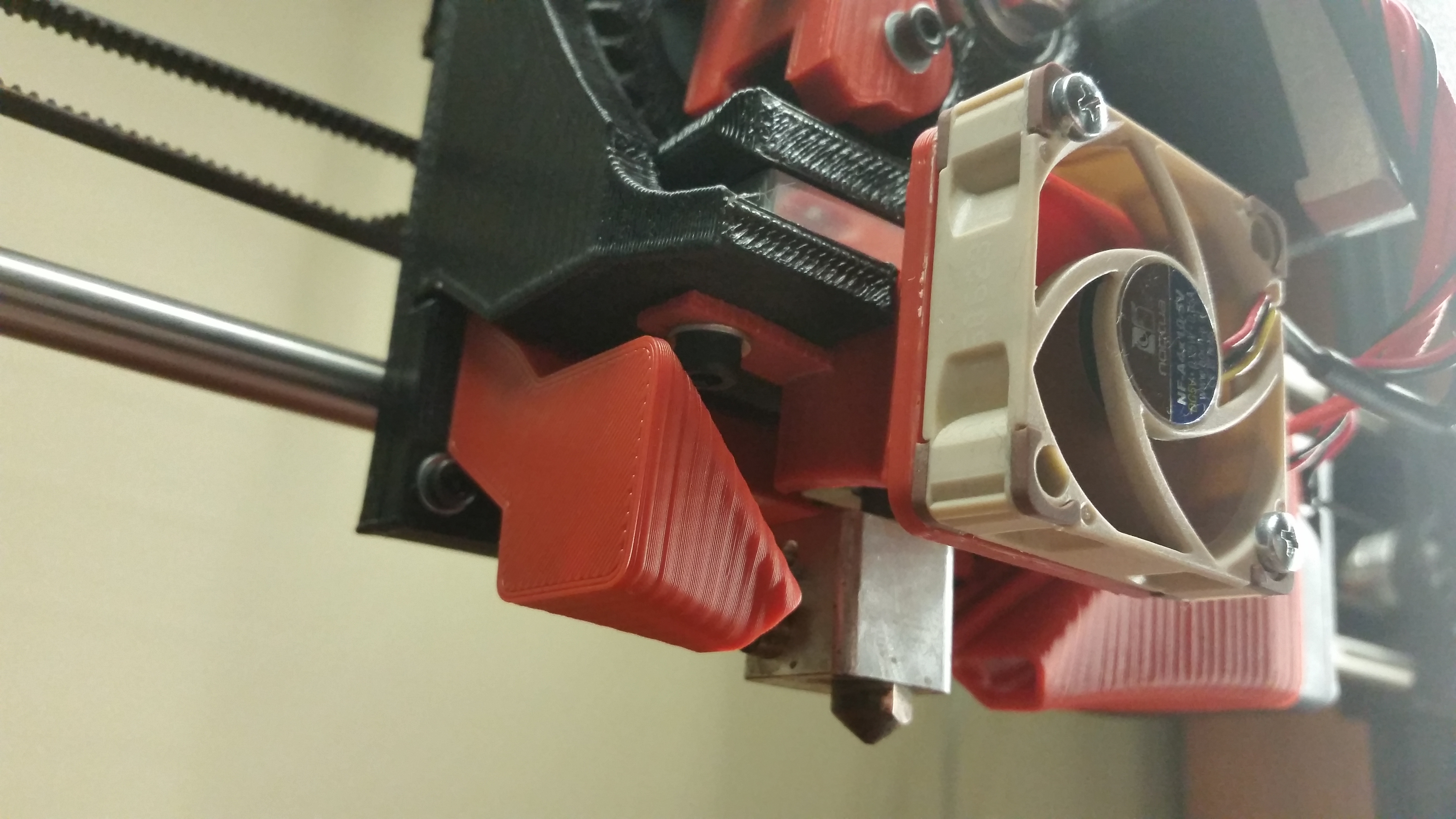

So I’ve added a stronger fan, and am running a new print now at 90% flow rate (figured I’d start with small changes there so I can see what effect the fan is having).
This is the part I used http://www.thingiverse.com/thing:1387812
Hopefully this puts an end to the heat creep. I’ll post the results once it’s done.
And here’s the result. Finally a successful print. I think I’ll go back to trying 100% flow though and see if that works. The top layers were a bit sparse, likely because of the flow rate. I’m still happy though. Looks like the aftermarket heat sink fan did the trick.

Here is a hotend heatsink cooler duct that fits the Taz printer and Hexigon hotends that I built loosely based on the E3D hotend duct design:
http://www.thingiverse.com/thing:1461335
Direct swap for the small blower on the Taz 5.

Since I installed the heat sink fan and the overhead spool holder, we have zero (zero) trouble with stuck nozzles, heat creep, grinding filament, etc. These two modifications cured all of our problems with PLA and filled filaments. We don’t even think about heat creep anymore. Seriously.
