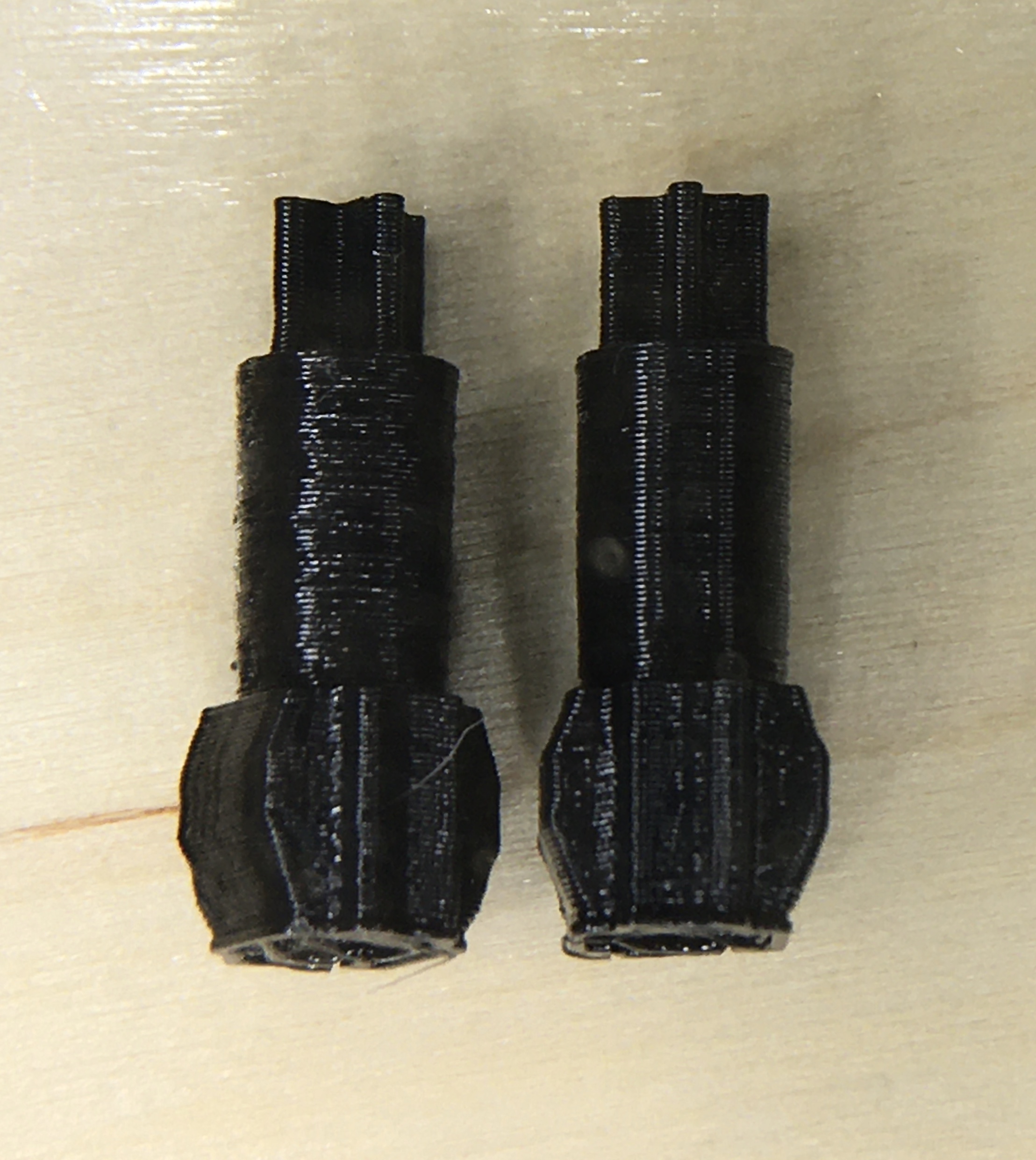

in the attached image, the piece on the right is from a 10-piece batch. The piece on the left is from a 20-piece batch. The poorer quality is clearly demonstrated by the layers having shifted slightly back and forth, which not only looks worse, but throws the barrel diameter out of spec by making it too large on average.
I’m using a Mini 2 with the standard 0.5 mm head.
Thanks for the details! My guess is it’s something involving belt tension or speed/acceleration/jerk. A couple different things to try:

My overall hypothesis is there’s excessive backlash, so with each change in direction the tool head doesn’t move to exactly where it should be. This small error might not be an issue when you have 10 pieces, but this could stack up and become more of an issue when printing more pieces. Backlash is inherent in any system like this, but the above steps might help reduce it.

The more pieces you print, the more time there is between layers on each part. This can have an effect on the quality of the parts.
I have found that the default travel speed and acceleration settings are too high for large print batches. My mini2 can really shudder under the default settings and parts sometimes detach from the build plate mid or late print.
I adjusted those settings way down using print acceleration of around 300 and travel acceleration around 500 and enabled jerk control using 20 mm/s settings. This will increase your print times.
You could also try slowing your print speeds and lowering your print temps a little bit.
If by smearing PLA everywhere you mean a part broke free and was dragged through your other parts then also try printing on a raft to keep that from happening.
