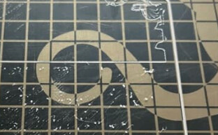

Yes - reasonable question because that would certainly cause a problem if it’s not cleaned out. Any time I recover these from grinding up filament I use that brush to completely clean the wheel all the way around. I tossed that picture in just to show what it looks like when I find them in this state.

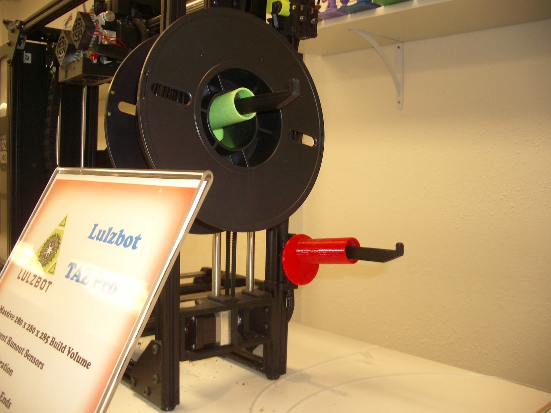

We typically get the 3kg spools of filament because we always have issues using the end of a spool, so the larger ones produce less waste. But I wonder if the larger spool size is making it harder to rotate. Anybody have experience where a 1kg spool works fine but 3kg spools cause problems?
Any hacks or simple mods to the spool arm setup to make it easier to rotate? We don’t do the overhead spool setup because we have the tents on all the printers.

The polyethylene feed tube is necessary for machines that hold the spool from the side. Machines that hold it above such as the Lulzbot Mini and Mini 2 don’t need one.

You could make something like the image below to help reduce the drag from the weight of the spool on the spool arm (assuming of course you could get it to build without jamming) :roll_eyes:

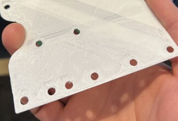

Honestly, the one thing that would be most likely to solve your problem is a willingness to change some of those settings in Cura.

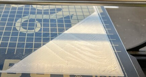

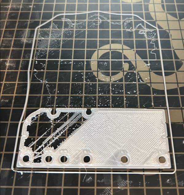

Are you using washer-based leveling? What is your Z probe offset? Because…
this shot
and this shot
and this one
All show your Z offset is way too low. No filament can withstand that kind of pressure. With an octograb and washer-based leveling, you should be looking at around +0.3 for your Z offset. If you are in that ballpark, you may have something changing your z offset in the slicer, because that shot of the large flat sheet looks consistently too low, rather than the result of a dirty nozzle screwing up one point of the probing.
The standard z-probe offset for all of Lulzbot’s washer based machines is around -1.2 to -1.5, IOW about the thickness of the washer itself. A positive 0.3 offset would put the first layer about 1.5mm above the build surface.
I think he said that was if you had an Octograb. Mine definitely places the top of the build plate just about level with the top of the washers.
Yep. Octograb in use, octograb offset recommended.
