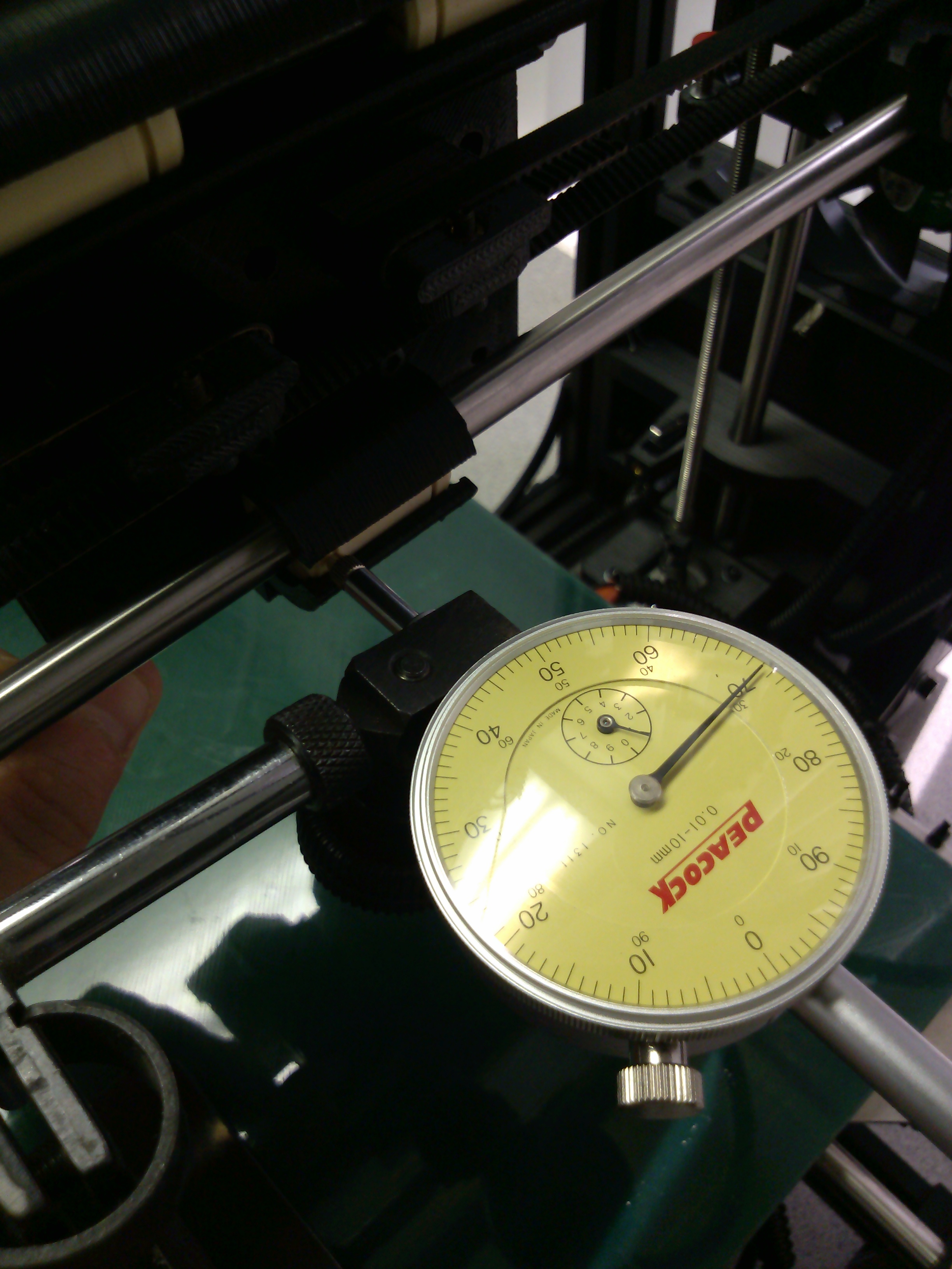

I was just going over the TAZ we recently got, and noticed that the rod bearings were very loose on the rod. It seemed like I could slip a piece of paper in between the rod and bearing on one side. I specifically noticed this on the X-carriage. you could easilly wobble the carriage.
I know there has to be some room for sliding but this seemed excessive. Anyone else notice this? Perhaps a loose batch of bushings are out there?
It has been printing, but I doubt 0.1mm “print tolerance” accuracy is possible (like the specs call out for).
I’ll see if I can measure the gap somehow.

It’s not the holder that is loose…its the white plastic BEARING itself.
Is the gap between the smooth rod and the bearing or the bearing and the bearing holder? If it’s between the bearing and the bearing holder the new linked model should help.
Bearing and smooth rod. They all seem to be loose.
I’ve asked one of the guys in the fleet if they’ve seen something similar, They’ve noticed a little bit of play but it hasn’t affected the print quality. We’ll keep an eye on it and see how it proceeds. How much of a gap have you noticed? Is it measurable?
I just measured 0.3mm of “slop” on one of the bearings in the X-carriage…but if all of them are like this, that will quickly add up.
We’ve looked into the tolerances on the bearings, they are listed as: 0,032-0,075mm. We’ve worked with tighter IGUS bearings in the past and found that they’ve led to binding from too much friction. We haven’t seen a reduction in print quality in the 8 TAZ we are running in the fleet in comparison to the prints ran on the AO-101. It’s something we’re keeping an eye on in the meantime.
These bearings are clearly 3 times the tolerance specs you mention.

I can check the other bearings, but they also have a noticeable gap.
FYI, The rod measures 9.98mm

One thing we’ve tried today is loosening the double and single bearing holder on the X-carriage. Squeeze them towards each other and then tighten them back. That pushes pressure against the bearings and still allows for smooth movement.
i will try that. it should help some

Tried the squeeze mod. You do have to hold the squeeze as you tighten all the bolts, but it is certainly better.

Speculation, but if you read the data sheet these are designed as a press-to-fit part and as such the documentation says that they were will oversized in free state…
http://www.igus.com/wpck/default.aspx?pagename=drylin_r_rjm_01
Quote from the datasheet
Designed as a press-fit part, it will be oversized in free-state
Might the other 10mm versions that have the same outside dimensions be a better solution and closer tolerance? I doubt much pressing together is going to do anything for the tolerance issue, you are just expecting that stretching those tolerances against the outside of the 2 rods will address the issue, but unfortunately, that will only occur in one dimension…
